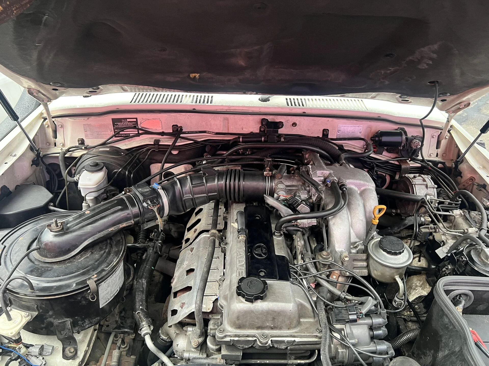

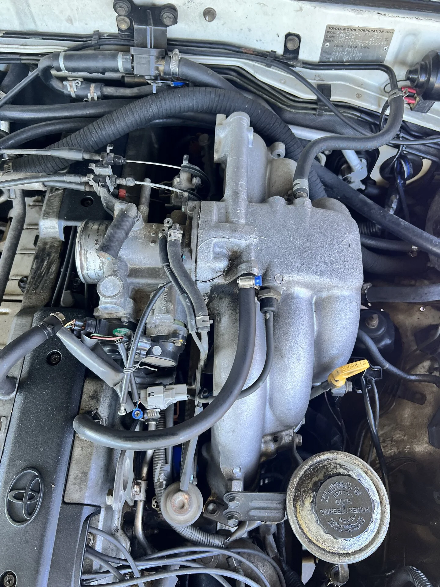

Hey thanks for the reply, yes she does have a snorkel and don't redline it every chance I get haha, I basically granny spec it and don't really exceed over 2k rpm, im usually within aus speed limits. I'm yet to take it on it's first 4wd trip due to this issue, I'll have a look at the timing hopefully tomorrow with a mechanic friend of mine. I'll attatch some photos to show how she's looking
ok, I see a few hoses blocked off and the intake tube appears collapsed which probably collapses more when vacuum present therefore limiting air into the motor - fix these especially the valve cover breather that goes to the intake.
This. Why is you PCV valve hose capped?
yea u need to get all them vacuum lines all back proper.
And on an unrelated note: The driver's side of heater control valve looks discolored, meaning it should be replaced before disintegrating, causing a major coolant leak. The hose clamp on that side has been replaced while the other side looks original. What's up with that?
