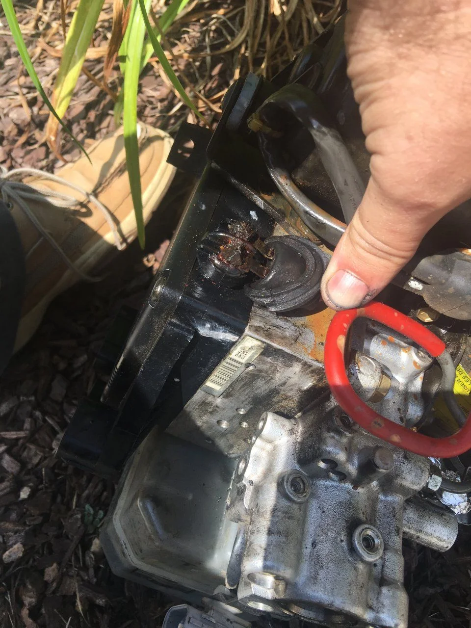

Thanks. I pulled my ABS assembly out and noticed badly damaged terminals from the "ASIN" solenoid control box to the ABS motor. I too believe this is either related to an accumulator failure which places increased workload on the motor/pump OR the motor terminals are failing from excessive rusty/water/corrosion
