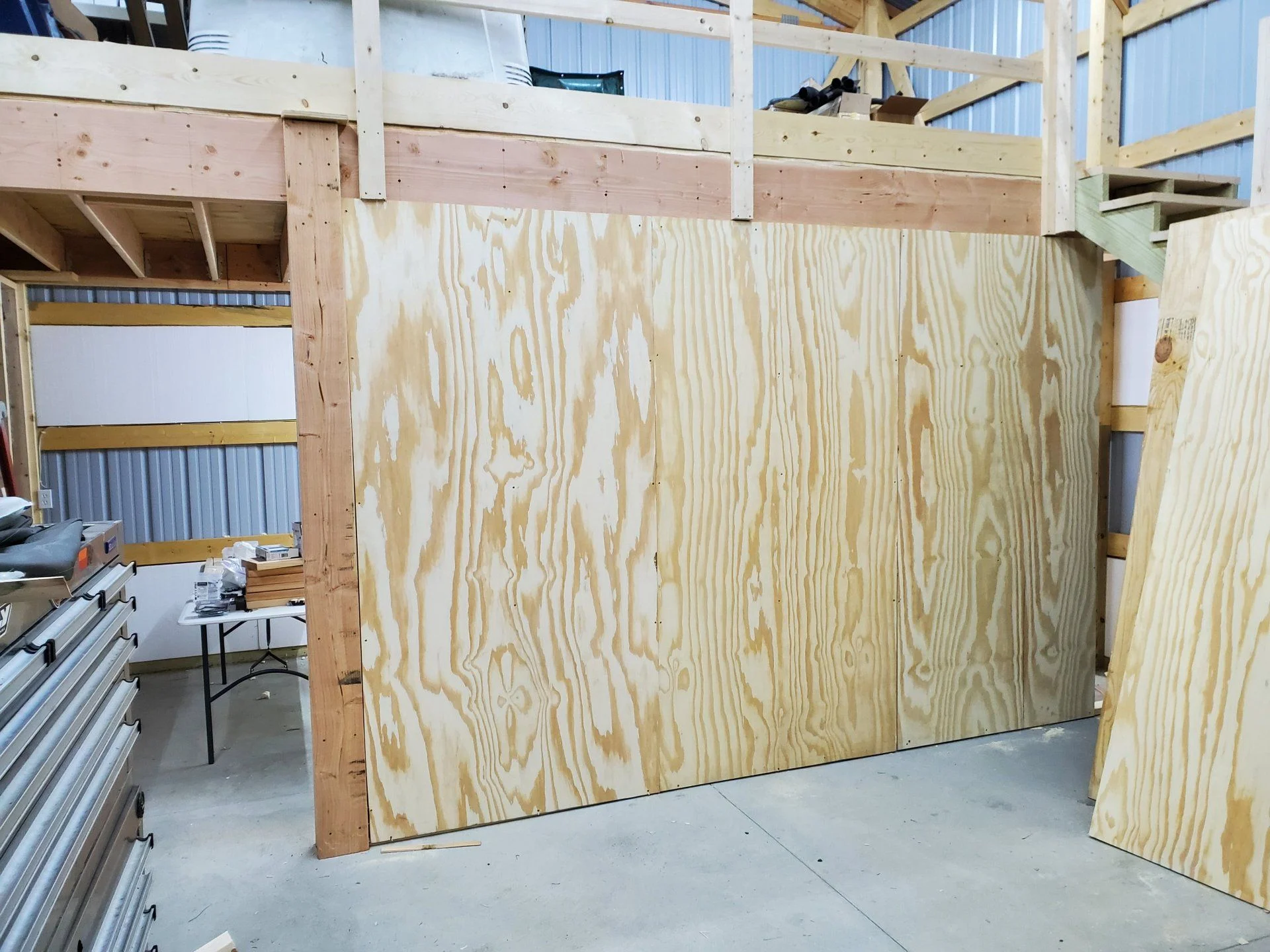

A little late now, but stopping the beam over the column reduced the load. If you staggered the joints and bolted everything together (construction adhesive between boards as well would be even better) it would have made for a much stronger assembly by making it a continuous beam. I've included the basic loading diagrams for each condition.
20200731_111537-jpg.2389917
Very good point. I was winging this construction thing and probably could have done a few things better. Net barn I guess 😀

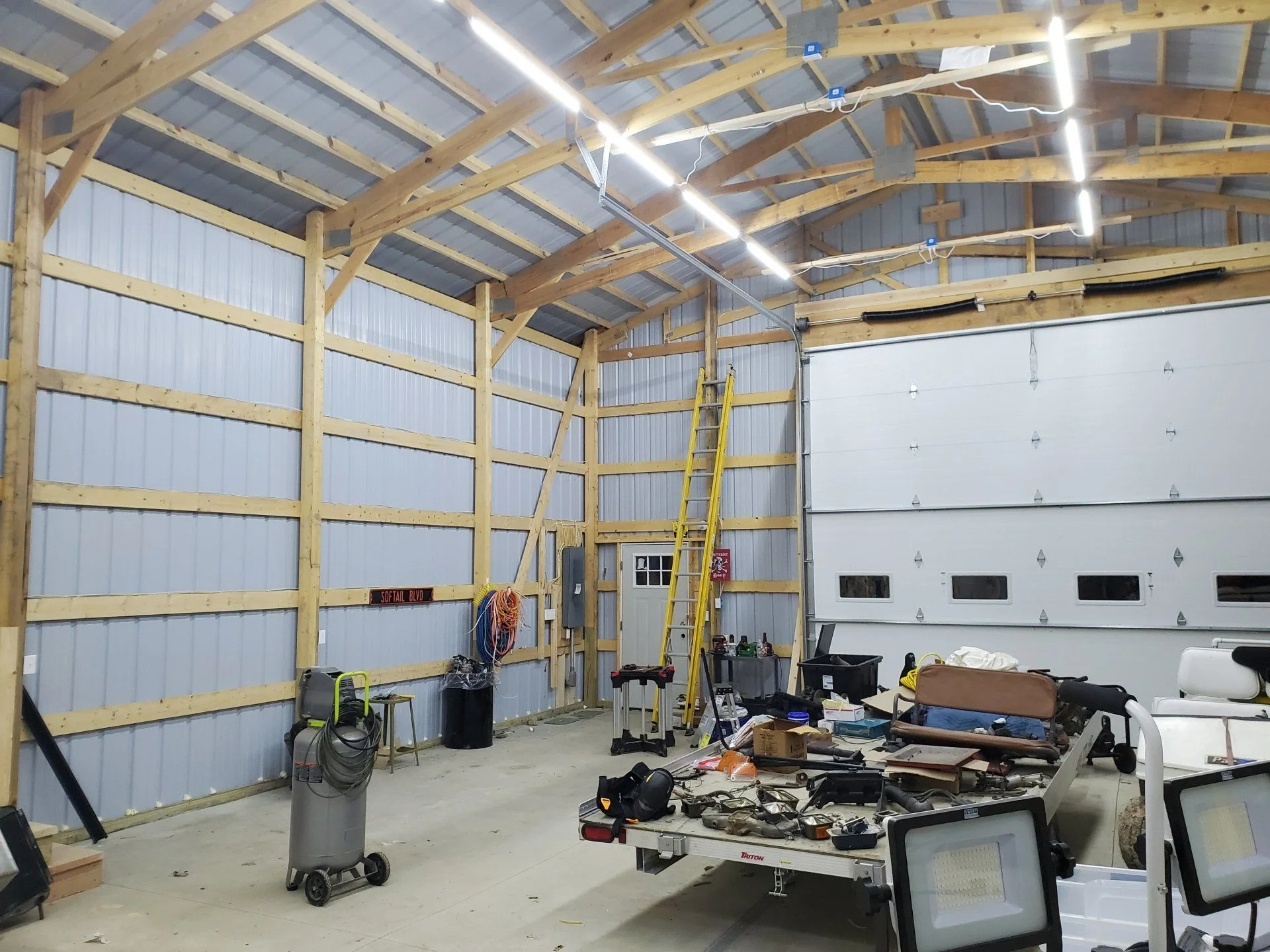

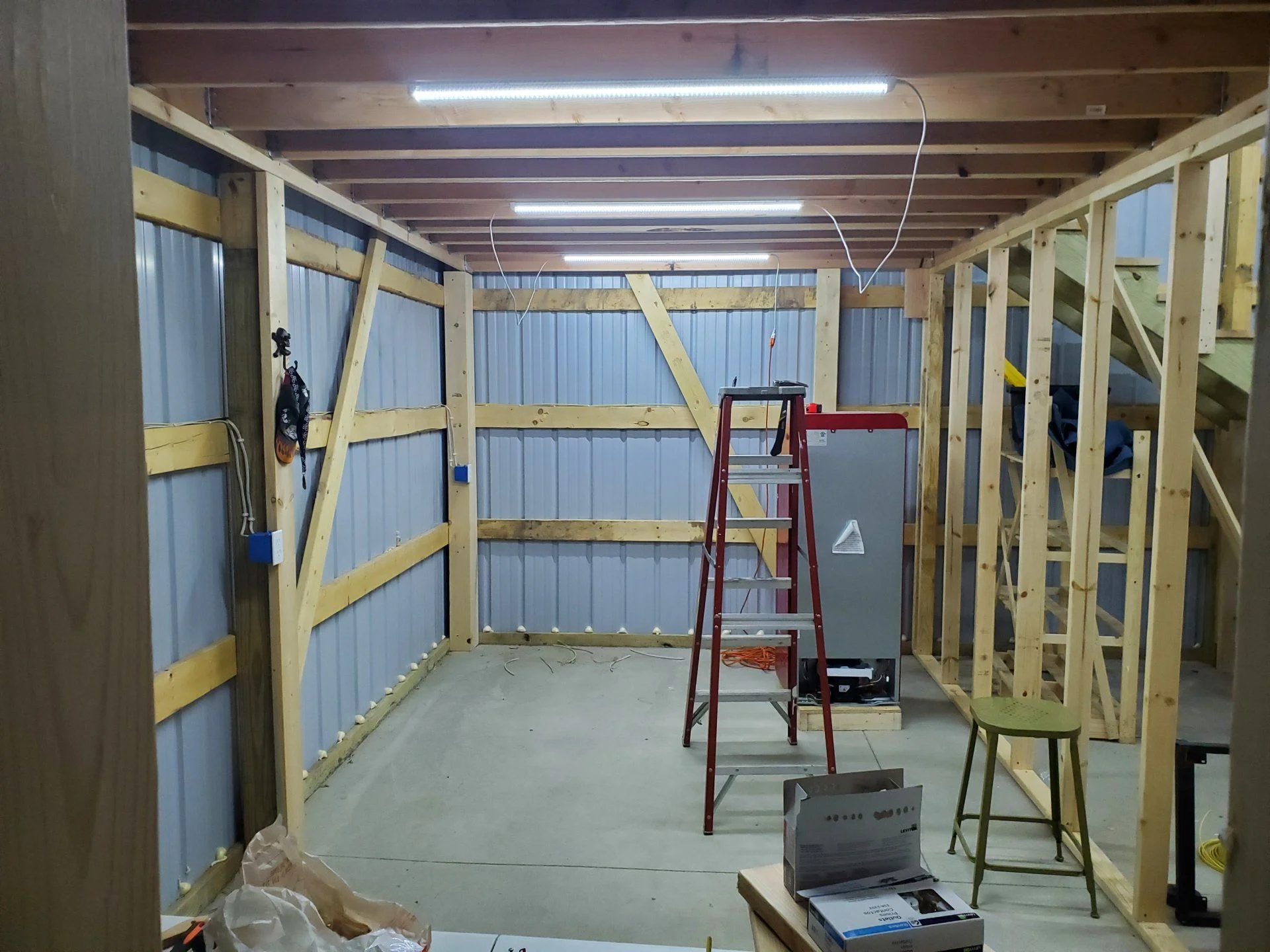

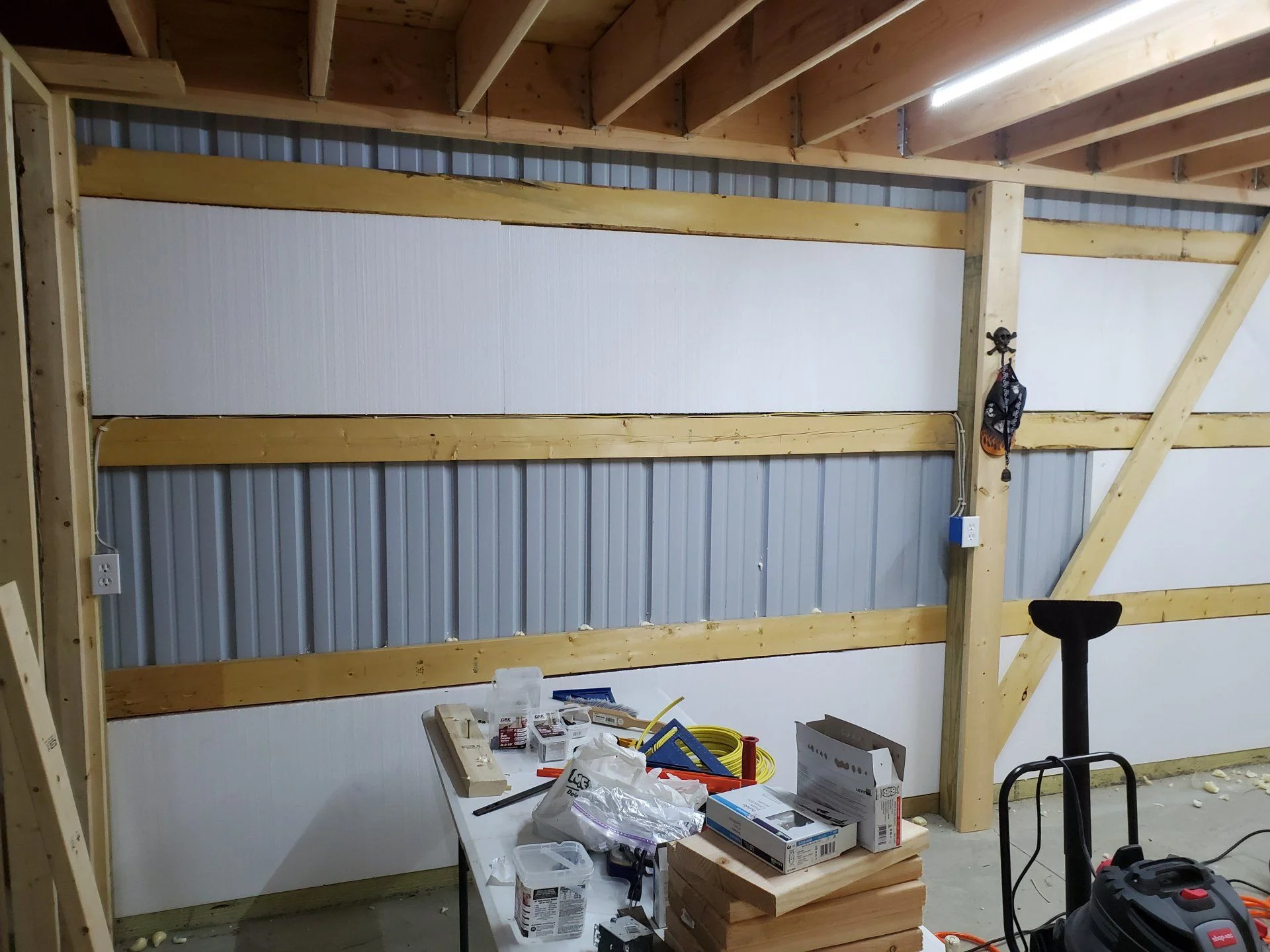

Got a few more lights up and finished all outlets and switches that are currently installed. Tested the lights in the clean room and I just need to route the wire in a more professional manner.
I was in the same boat 12 years ago on my 32x40 pole barn. One thing I skipped was insulation. I still kick myself for that. Now everything is on the walls and I wish that I would've done it earlier.
Everything looks great!

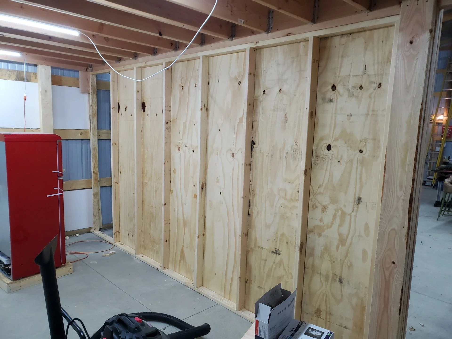

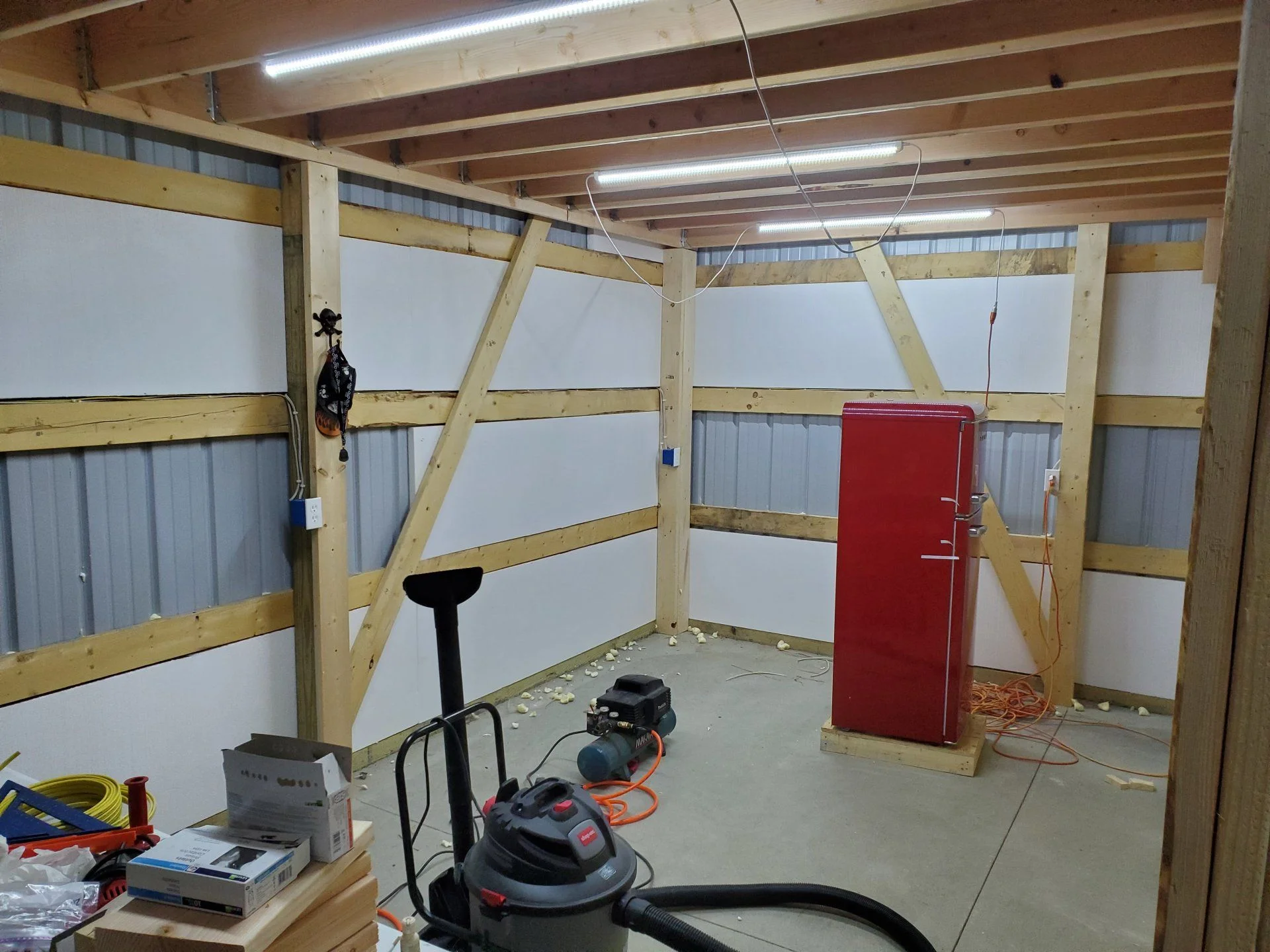

More clean room progress. Wall plywood and some initial insulation before R-19 batts go on.

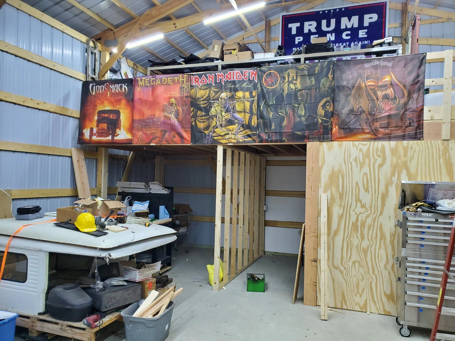

Finally had a chance to put up some long overdue wall art. I think it helps to make the space feel a little less industrial. Even have room for 1 or 2 more. Have to decide between AC/DC, Black Sabbath, DIO, & Judas Priest 🤘🤘🤘
