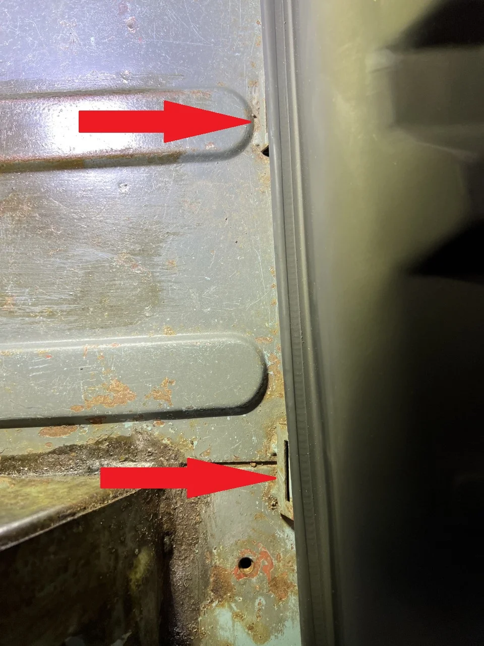

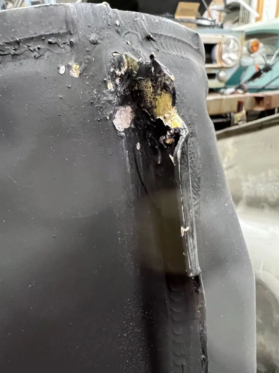

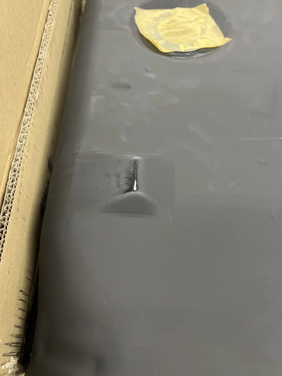

First test fit any I'm annoyed.
The pinch welds don't clear the hold down straps so it's sitting high.
They should have bent it like they did to make clearance for the rear heater lines (I might re-route my rear heater lines to make use of this if I keep this tank) here.
@120mm did you face any fitment issues? Your pinch welds seem to be bent more flush with the body of the tank in your build thread. Mine are at 90 degrees to the body on the back side.
I'm hoping I just got a crappy pandemic built tank. I'm going to call Mr T.

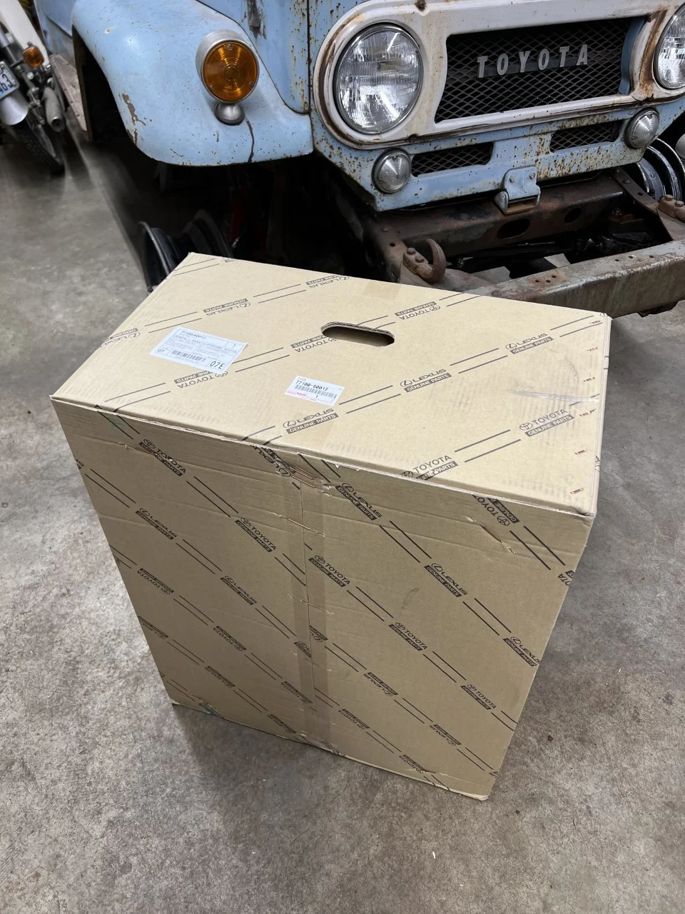

I called Mr T today. The tech was like "yeah no prob, I can order one from Portland, it'll be here tmrw." He's had issues with pandemic parts before. Awesome!
Not kidding, 2 minutes later his manager calls. First thing out of his mouth "This is Mr Parts Mgr, did you install the tank?" No, I just took it out of the box and sort of set it down. "So you installed it? Sorry, no returns." No sir, you misheard me, I just measured it and noticed it would not fit. It never left the box. "Fine, see you tmrw."
I've been dealing with the parts counter techs for the most part. Absolutely professional behavior from them. This guy was rude. So this should be fun. I hope the mgr is not there tmrw. Over $500 with tax, this baby better fit right out of the box.

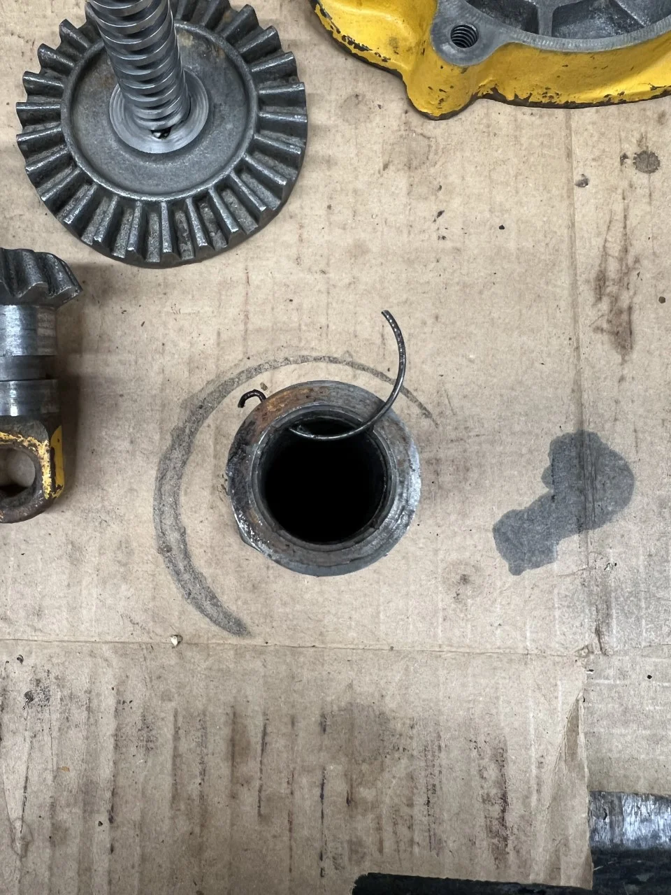

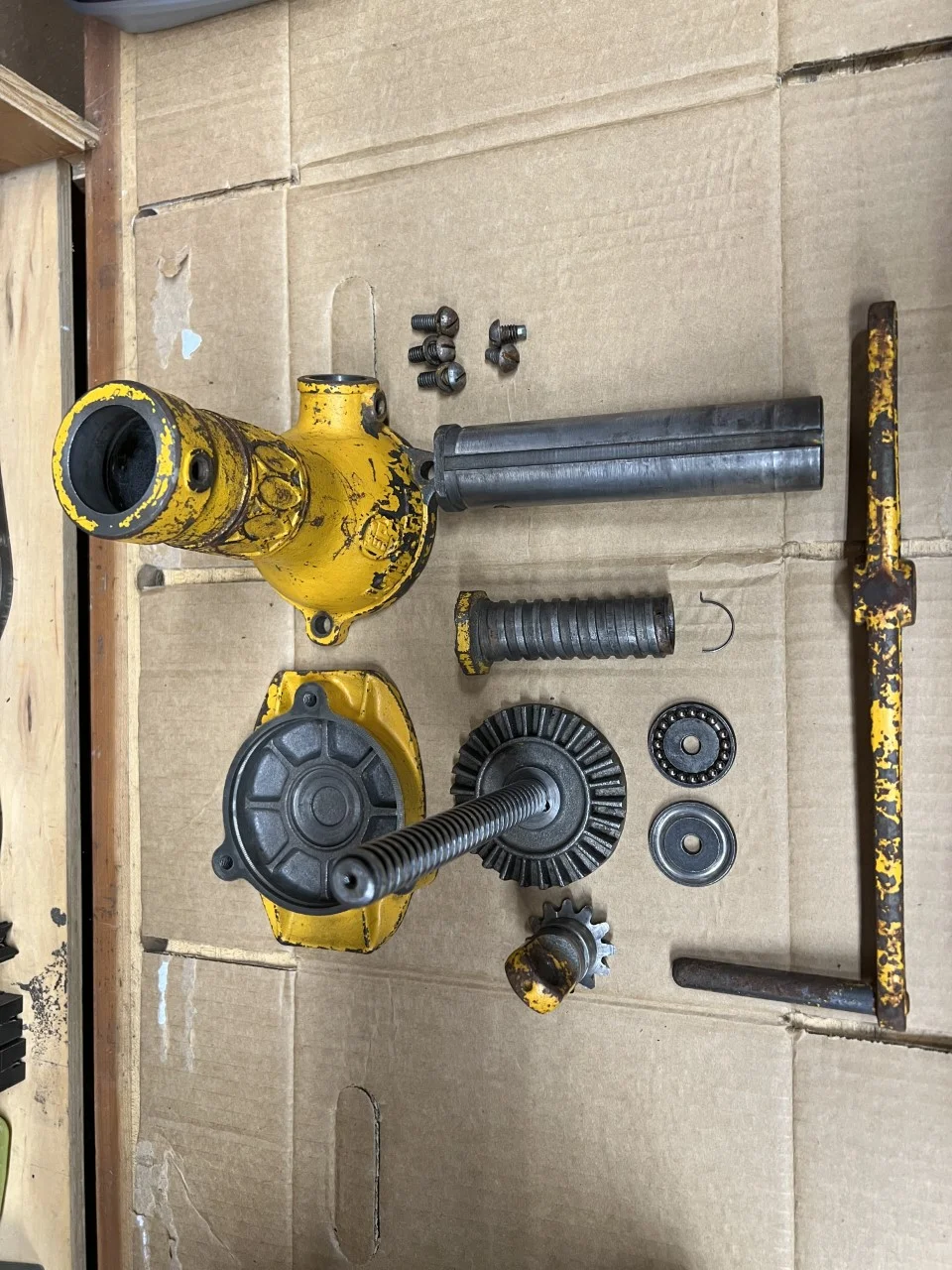

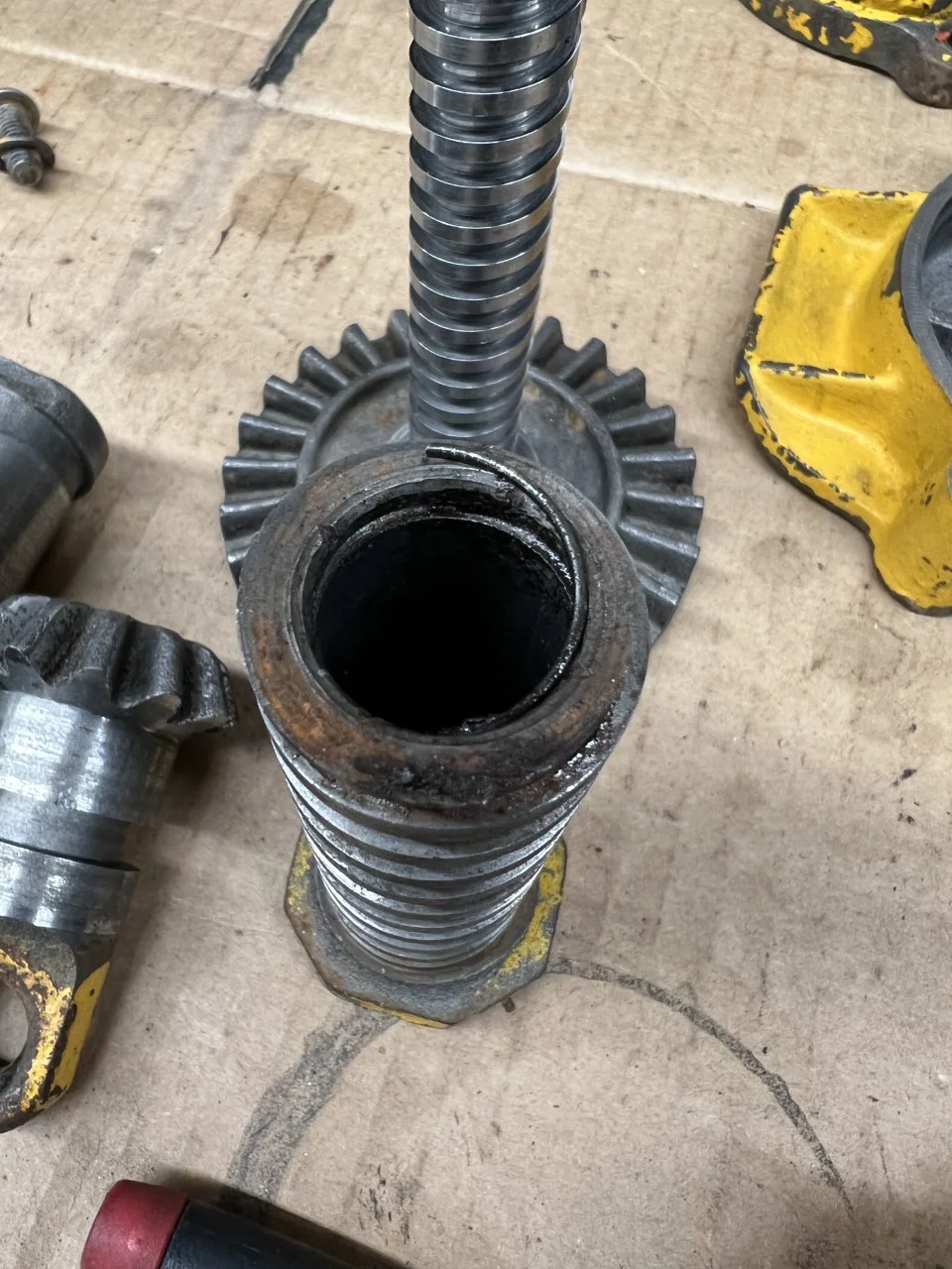

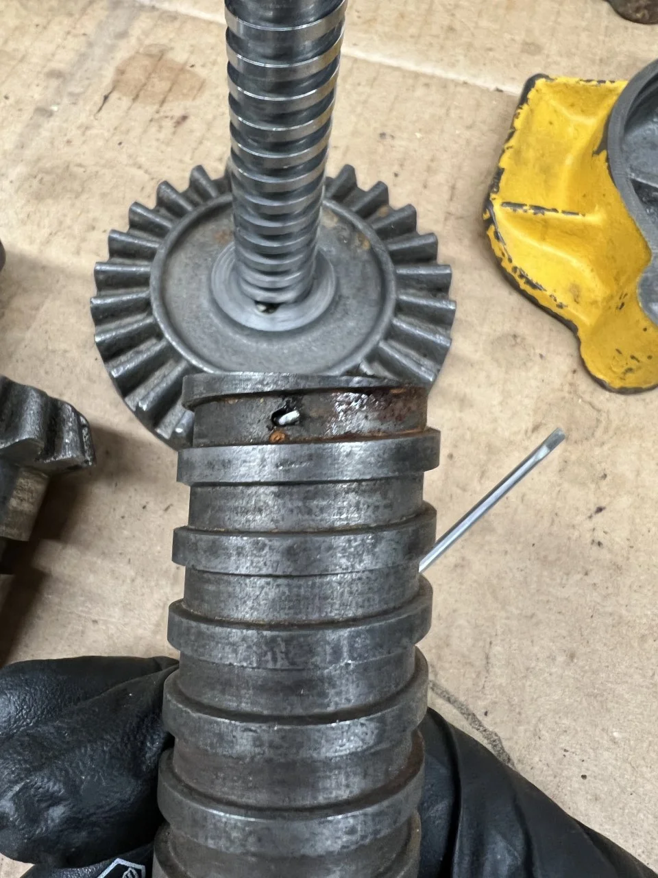

I was able to get the screw jack back together though.

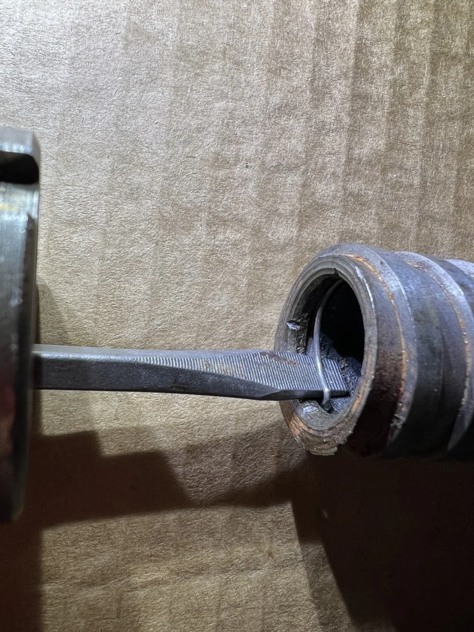

There is a retaining clip that holds the top extension screw from coming all the way out. I couldn't find a way to get it out of the way, and from what I read on other posts, you just have to force it over and then bend it back on assembly. So that's what I did.
Out if comes.
All cleaned and ready for reassembly.
