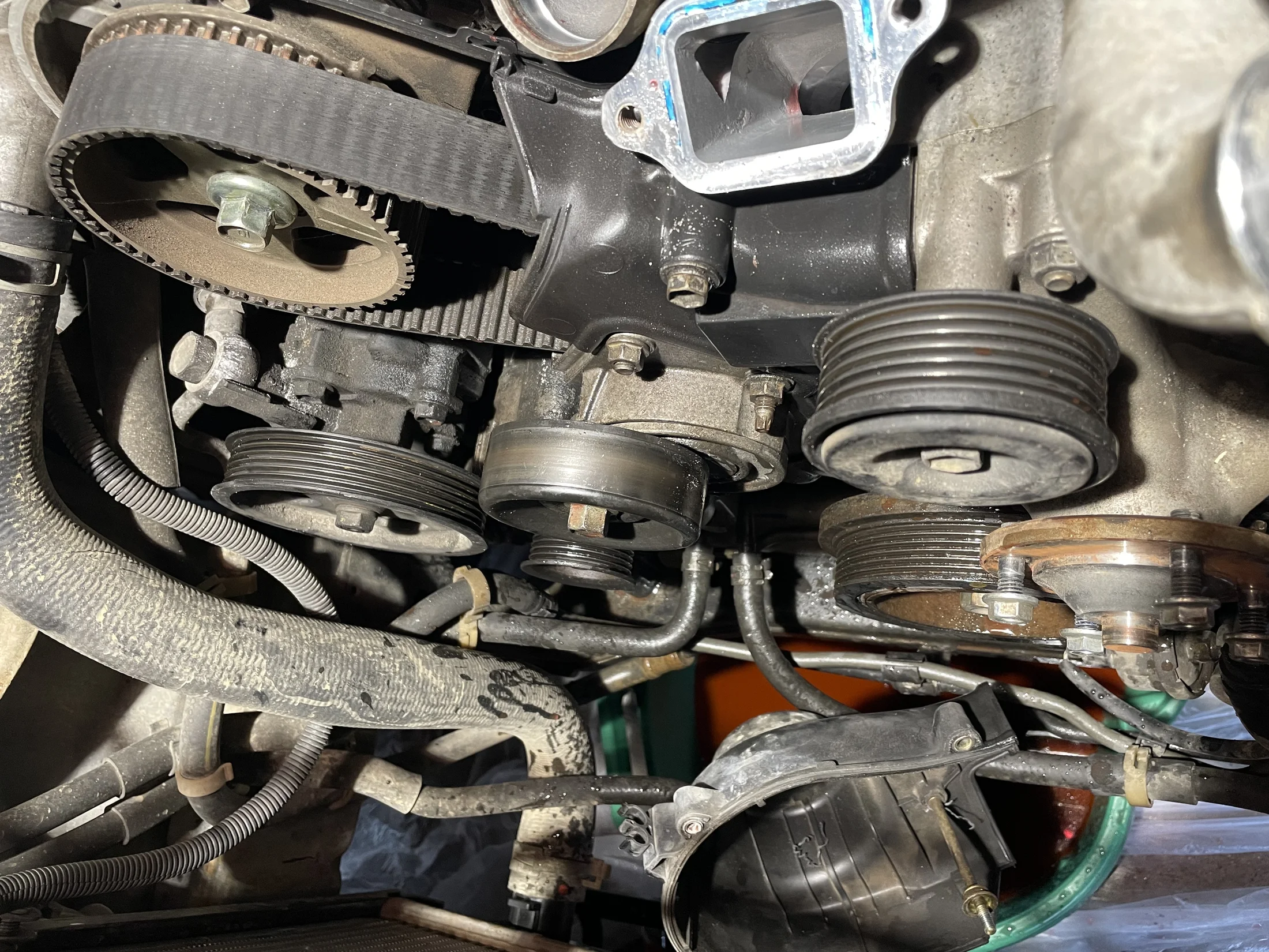

What you heard could be the belt start slapping around, possibly also when the tensioner snapped. Post some pictures of the damage when you get it torn down.

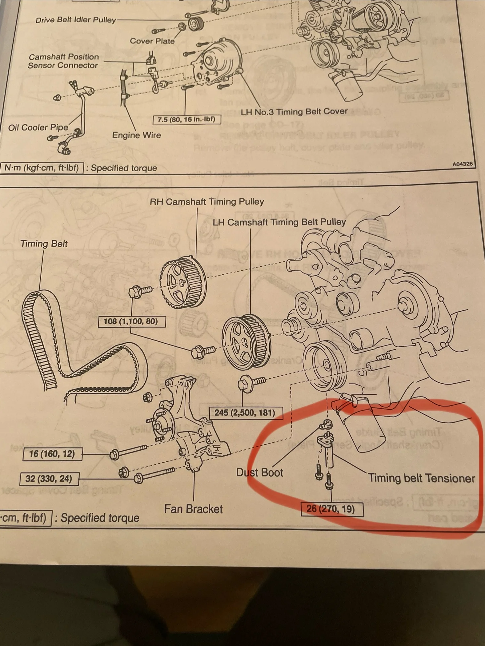

When you tear down avoid turning the engine until everything is exposed, you get to see where the cams and crank are and hopefully find the cause of failure. I would order an Aisin kit with the tensioner unless you want to pay for Toyota for individual parts. The only thing that concerns me is the broken bolts for the tensioner I hope it won't require an extractor to get out start soaking it with PB or use brake fluid which works if you give it time to soak.

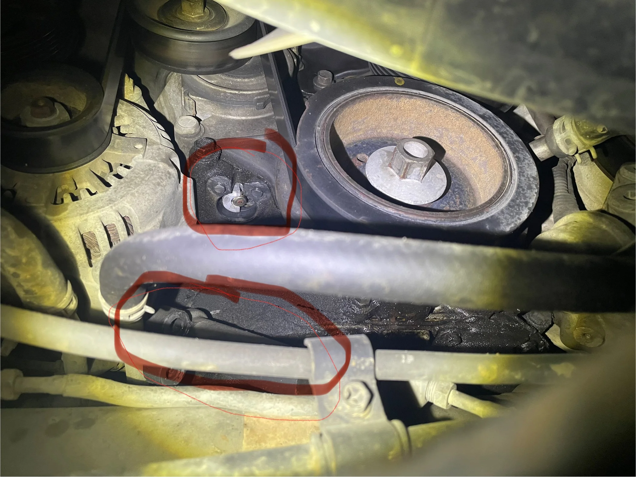

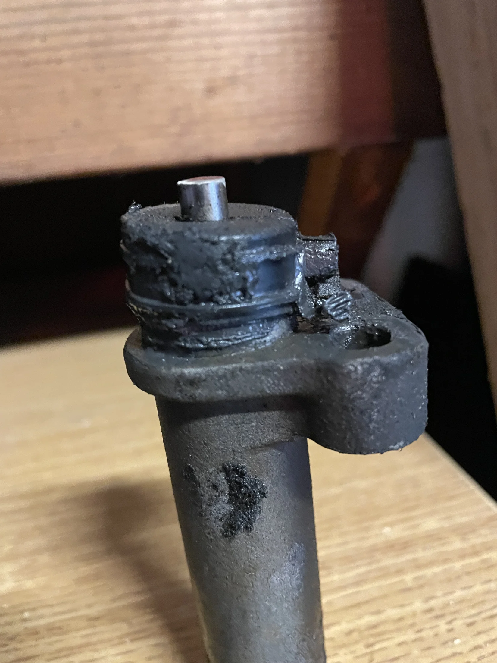

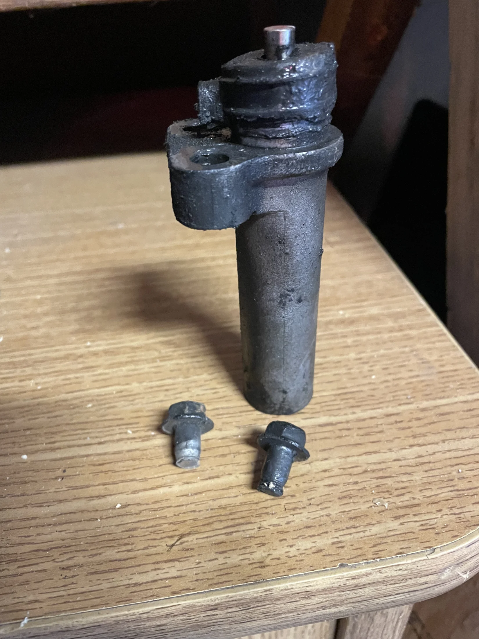

It snapped the bolts, something forced it out from where it was.
Oh damn! I'm guessing those bolts weren't tightened when the timing bent was replaced! Replace the belt/tensioner again and call it a day...

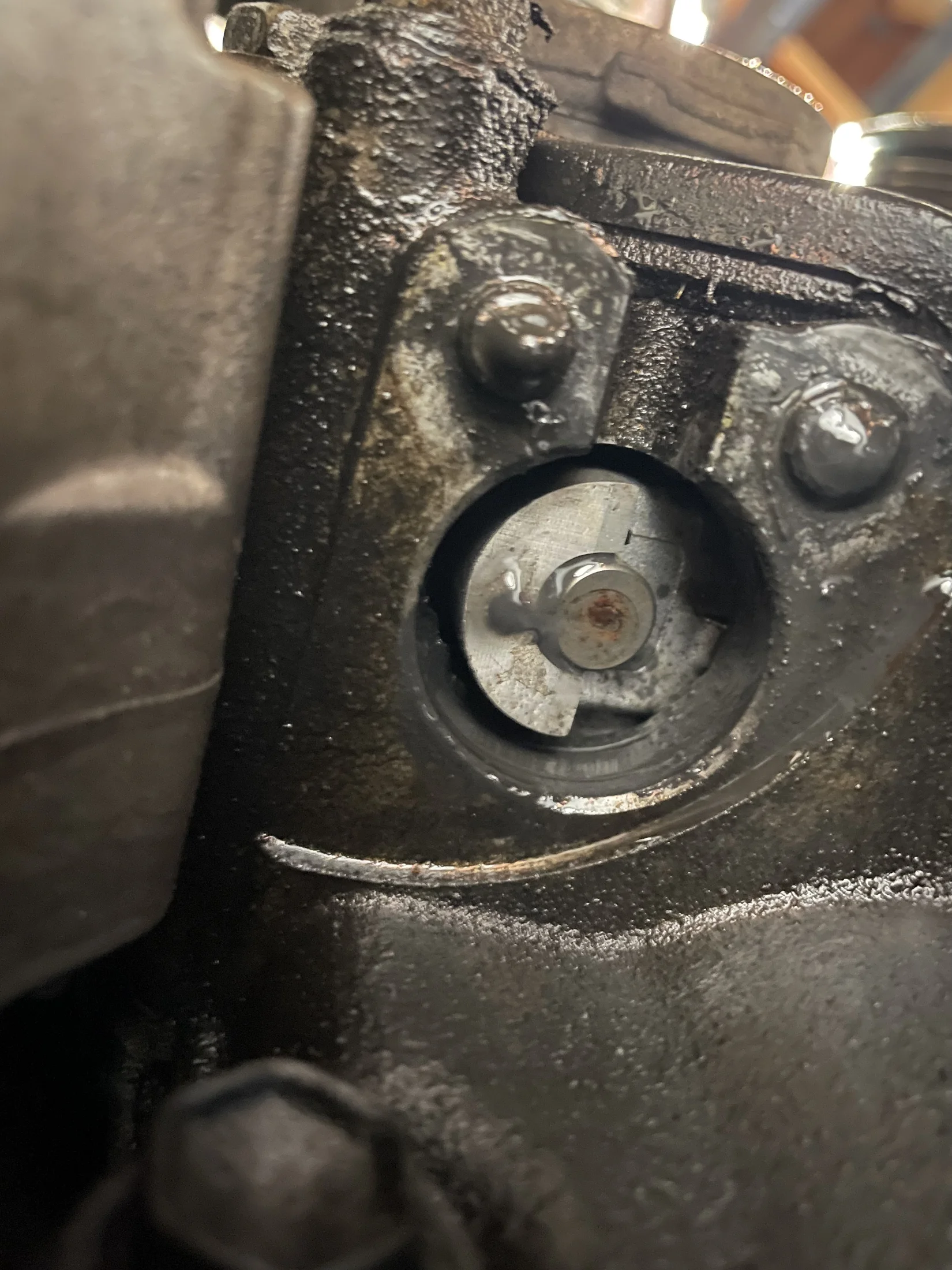

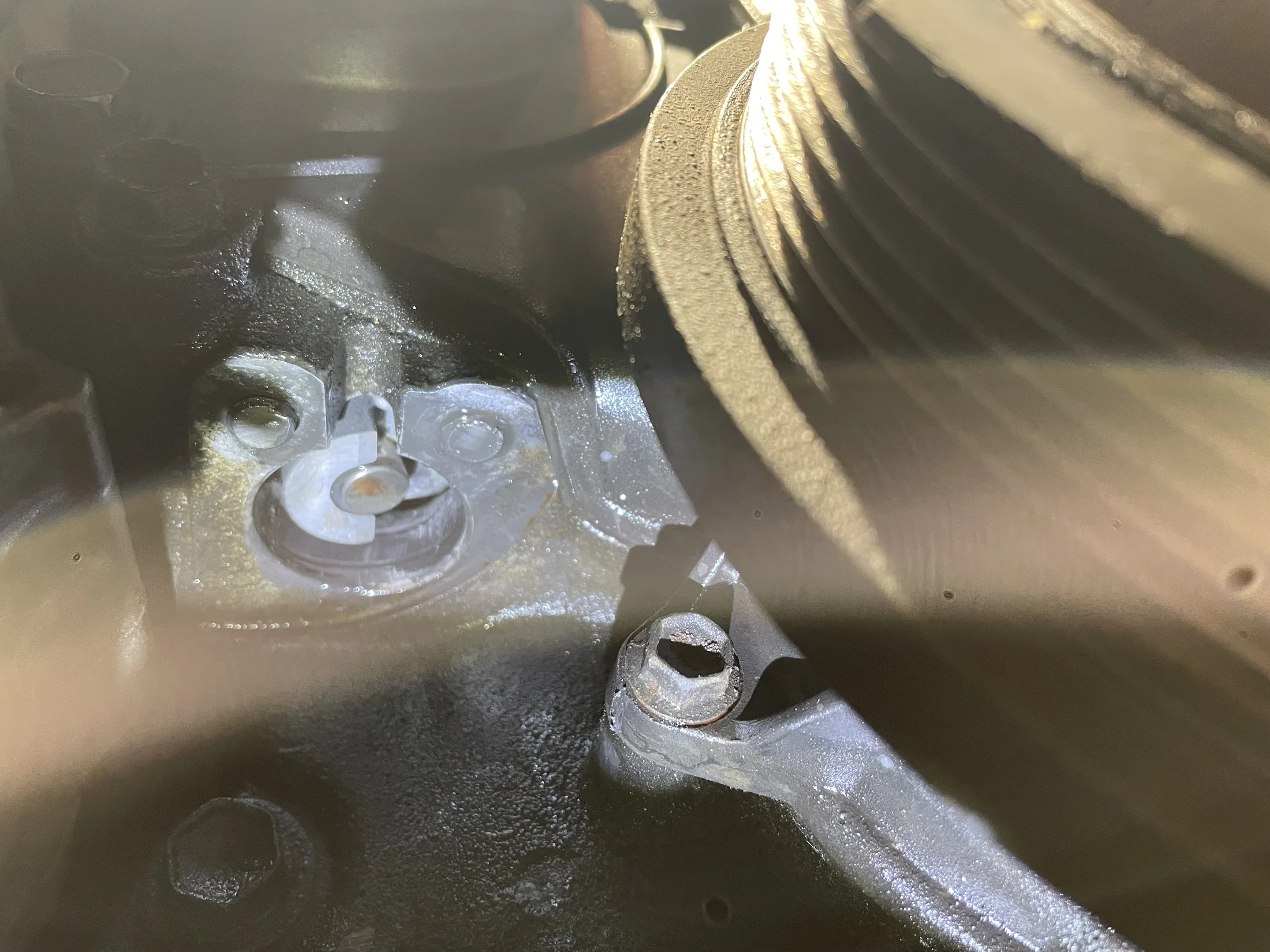

Does this look ok? Is it always stepped like that or am I missing the other half moon? I have a new tensioner ready to go in. The replacement tensioner bolts will get here tomorrow. There are five bolts in the aisin kit that I’m not sure what are meant for yet, though. Gonna work on removing the bolt shafts now but want to make sure the inner part the tensioner pushes against is replaceable if it is broken. It looks like it’s meant to be like that to me.
That piece inside is the tensioner pulley that rest on top of the hydraulic tensioner, something inside pushed it so hard it snapped the bolts. Take it apart and let's see what failed.
