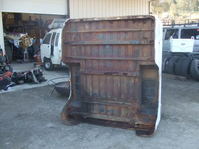

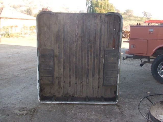

Here is what I'm working on.
"East Coast Mint" 196? FJ45 SWB non-removable top bed.

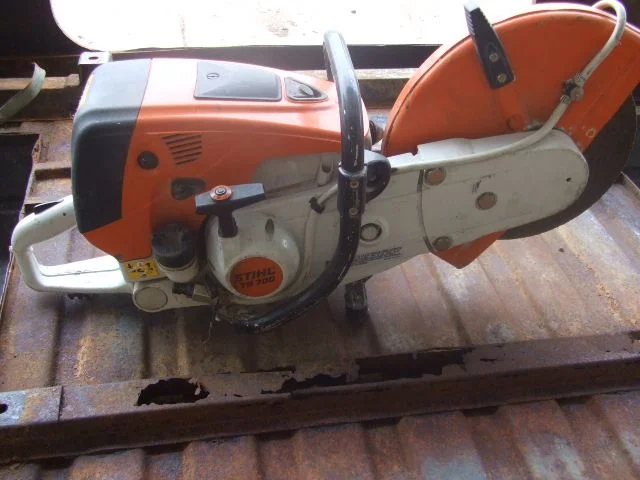

I think I found the solution to shortening this bed.
Used to run similar for getting rock samples when I worked summers for the provincial survey (diamond blade). Good times....., once we did a favour for the guy across the road, cut up a concrete sidewalk so he could pop the pieces with his bobcat. Forgot to bring the ear protection that time. :doh: Man those things will sing. :hillbilly:

I used the gas powered unit for the big stuff and used my air saw to tiddy things up before welding.
