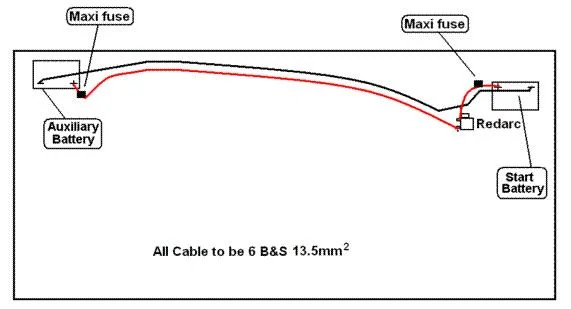

The Wiring & Cable is the other most important ingredient.
Wiring…this is without doubt where many people get it wrong and end up with a system that may work, but nowhere near as well as it could and should, If you do it right, you can double the usable capacity of your auxiliary batteries over and above what many people normally have, and help the batteries charge much faster and last longer too.
Understand that when charging from vehicle alternator one of your biggest enemies is voltage drop, you need to have the highest possible voltage at the auxiliary battery, this will allow it to charge as quickly as possible, and as fully as possible.
A lot standard set-ups that have been fitted by the so called professionals is where they use twin 6mm auto cable (really 4.59mm²), this is next to useless for fast deep charging.
A very basic explanation would be, that the larger the current draw, the larger the wire needs to be, and the further the distance the wire needs to run, the increasingly larger again the wire needs to be.
Use no less than 6 B&S cable.

Do not install the maxi fuses until the last thing, when you have completely finished all the cable runs and tightened up all connections. Make sure you use maxi fuses not standard blade fuses which cause resistance.
Although not always totally necessary (some people can use the chassis for earth return),
but it really is best to run the earth/negative cable all the way between the start and auxiliary batteries, for the extra few dollars in cable it really is worth it.
If you can mount the
Redarc close enough to the start battery you can use the maxi fuse as the link, there for saving having to add a short bit of cable onto one end of the fuse cable.
When running the cables between the batteries you should take great care with where you place the cable, making sure that it won’t rub or be cut through, also be careful to keep it clear of sharp corners etc, and if the auxiliary battery is going to be placed anywhere other than under the bonnet, you should seriously consider using a protective covering like split convoluting tubing and secure it well with clips or cable ties at well spaced intervals.
The cable should also be protected against short circuit, and I have found the most economical way to protect the cable is with Maxi fuses of 100A, an all too common mistake made by many people and even some auto sparkies is that they only fuse at one battery (normally the starting battery), but the cable needs to be protected from both ends, i.e. a fuse at both batteries, after all it is being feed from both batteries.
All cable lugs used with the 6 B&S cable are far too big to be crimped with standard crimping tools, so they should be crimped by an auto electrician, or you can solder them if you have a gas torch, they do take a lot of heat to solder on properly - and you should be aware that Soldering is not the ideal as Soldered joints in an environment with constant vibration has potential for problems unless the soldering is done very well with high temps - even then, professional crimping is my preferred method.

Below is an example of how an auxiliary battery set-up may be done - (without the switch or LED)
