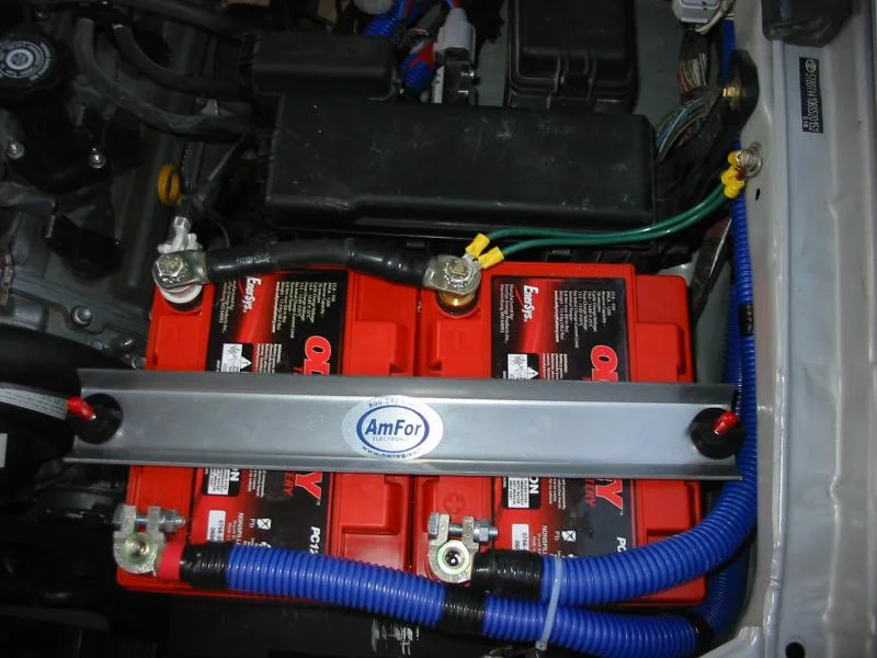

Lane, can you post pics of the batteries in the single tray?
I did a dual in my Tundra that might work in this application. Used a Hellroaring kit & Odyssey batteries. 2/0 welding cable, flame resistant wire loom. 2 Batteries fit in the stock location if turned sideways in a new tray.

They are 1200's with metal jacket. With Hellroaring there is no wires to cut splice to alternator etc.
I would say yes you need a dual system. Everything can run off the main battery and the other is back up. I can switch to both batteries if the load requires it via toggle switch on the dash.
All of my connections were soldered and crimped with shrink tubing protection.
