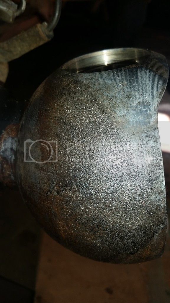

My truck came from Virginia, and Michigan before that with lackluster maintenance history. I am rebuilding the front axles now and am stuck trying to decide what I should I do about these pitted swivel balls. I cleaned them up the best I could and used some rust converter on them.
I am trying to decide if I should use some JB Weld to fill in the pits and sand smooth or just leave them be. I feel like they will not seal as well and increase potential for dirt intrusion if left pitted. JB Weld seems like it should be strong enough and hold up fine, but still the idea seems iffy to me.

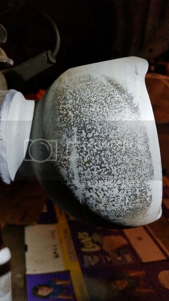

@Stevensnj - I used that exact filler primer! After 2 coats and some sanding this is what I had:

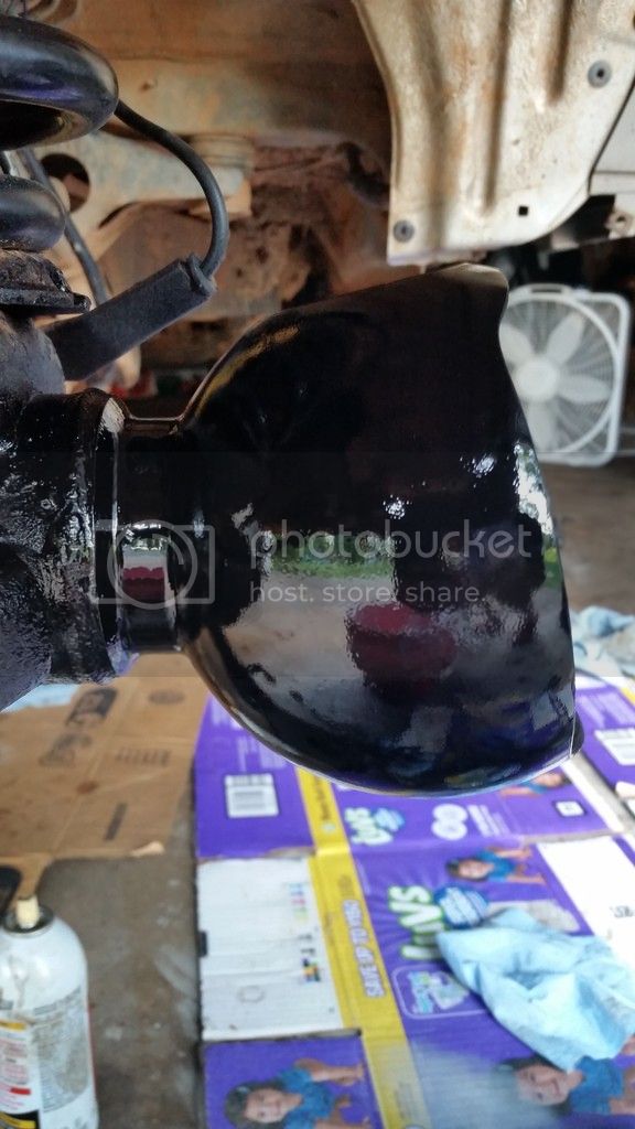

After some black epoxy paint:
I decided not to JB Weld. If the primer/ epoxy paint holds up well great. If not, I might try JB Weld the next time I do this job.
JB Weld is good stuff, just a lot of work it get it smooth on a round surface. Spray paint is comparatively easy and does the job.
