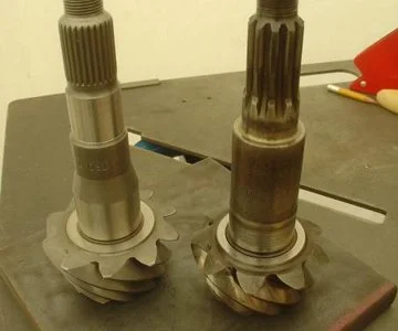

This will let you see why you don't need a crush sleeve:
The pinon on the right is a factory pinion. No crush sleeve required.
I don't know if I understand? first off I need to know if 40's use or don't use crush sleeves to begin with. cause I am trying to determine if mine does or does not have one without dissasembling. the answer is simple if all 40's use only shims. but no one has answered this yet. so I dont really understand what you image is showing me.
The picture above is from a '73 FJ-40. You mentioned that when you looked at a diagram of your 3rd member it didn't appear to have a crush sleeve. The reason it would need a crush sleeve is because the bearing would rest against the step on the pinion shaft. If you look at the pinion on the right left will notice it doesn't have that shelf on the shaft for the bearing to rest against, hence a crush or solid sleeve is needed. I opted for a solid sleeve as crush sleeves are use once and replace.

I rebuilt both my 3rd members and installed ARB's in both. I bought my new gears from Nitro which is the pinion on the left. They are not built with the shelf you see on the factory pinion on the right. Because of this you have two options, a crush sleeve or a solid spacer. Most kit will provide 2 crush sleeves because when you are setting things the first gets crushed and since things aren't exactly right the first time you have to take things apart. Once you take things apart you then have to replace the crush sleeve. A solid spacer doesn't crush and is more like the factory pinion so things can be taken apart and reassembled as many times as necessary and you don't have to replace it.
