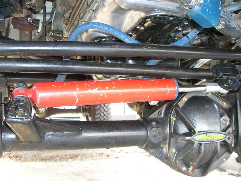

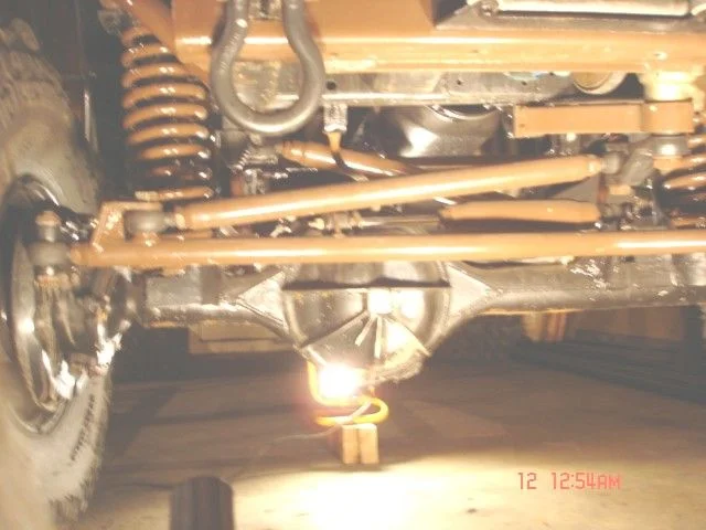

Yup, I've got an FJ80 axle sitting in my garage and the options are sadly very limiting with that axle. It seems it is really only destined for linked setups unless you want to go full hydro or (ooga booga) do a Z-link for steering.
I can certainly understand mounting the panhard is very difficult to run parallel to the draglink with the amount of room you have to work with. I tried to mount mine the *best way I could without it hitting the axle housing. Luckily, nothing but my sway bar barely touches my Y-LINK bars. I may try a 3 link on my 55 - haven't got to the suspension yet on my build. This is on my 40:
