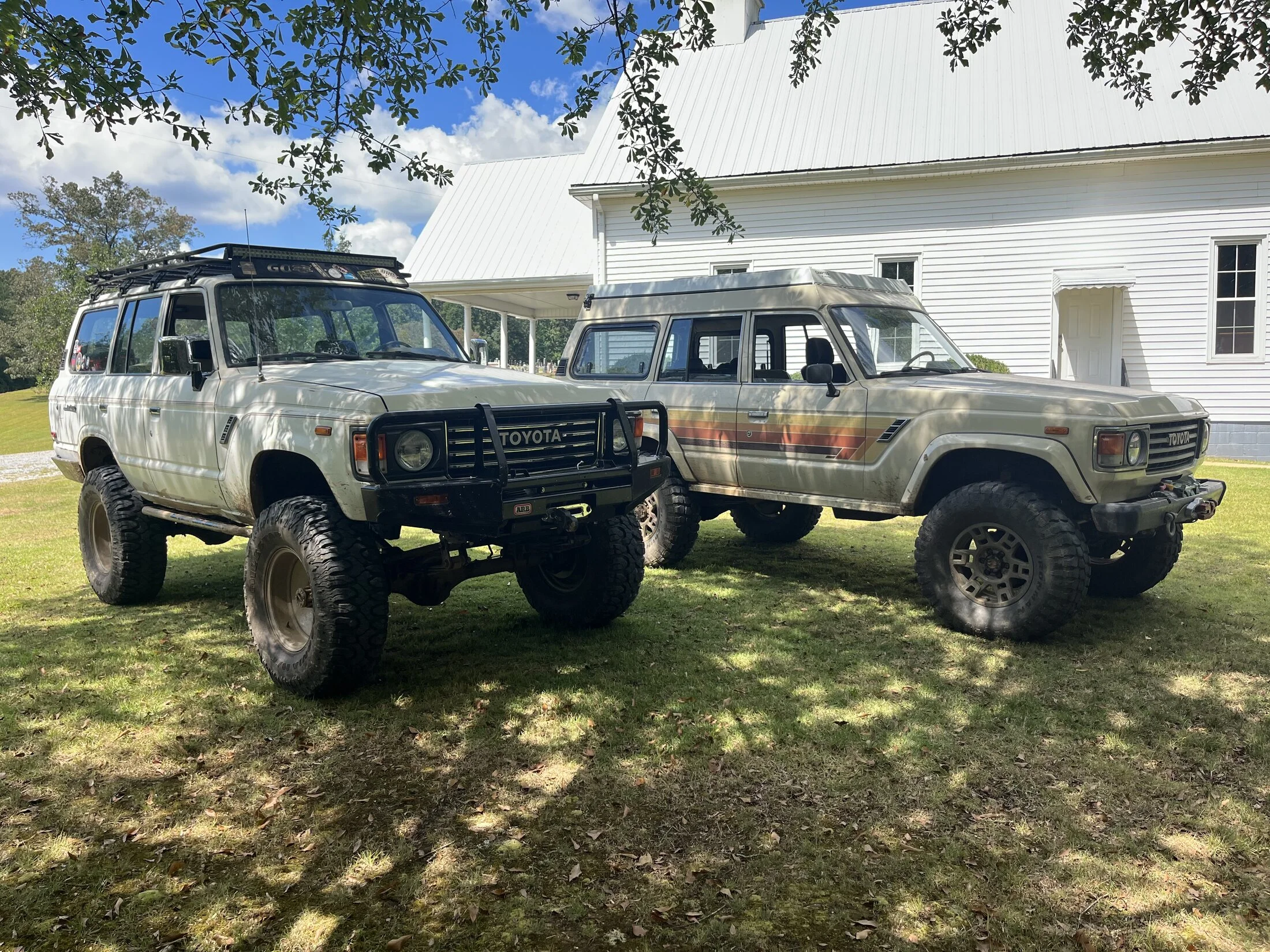

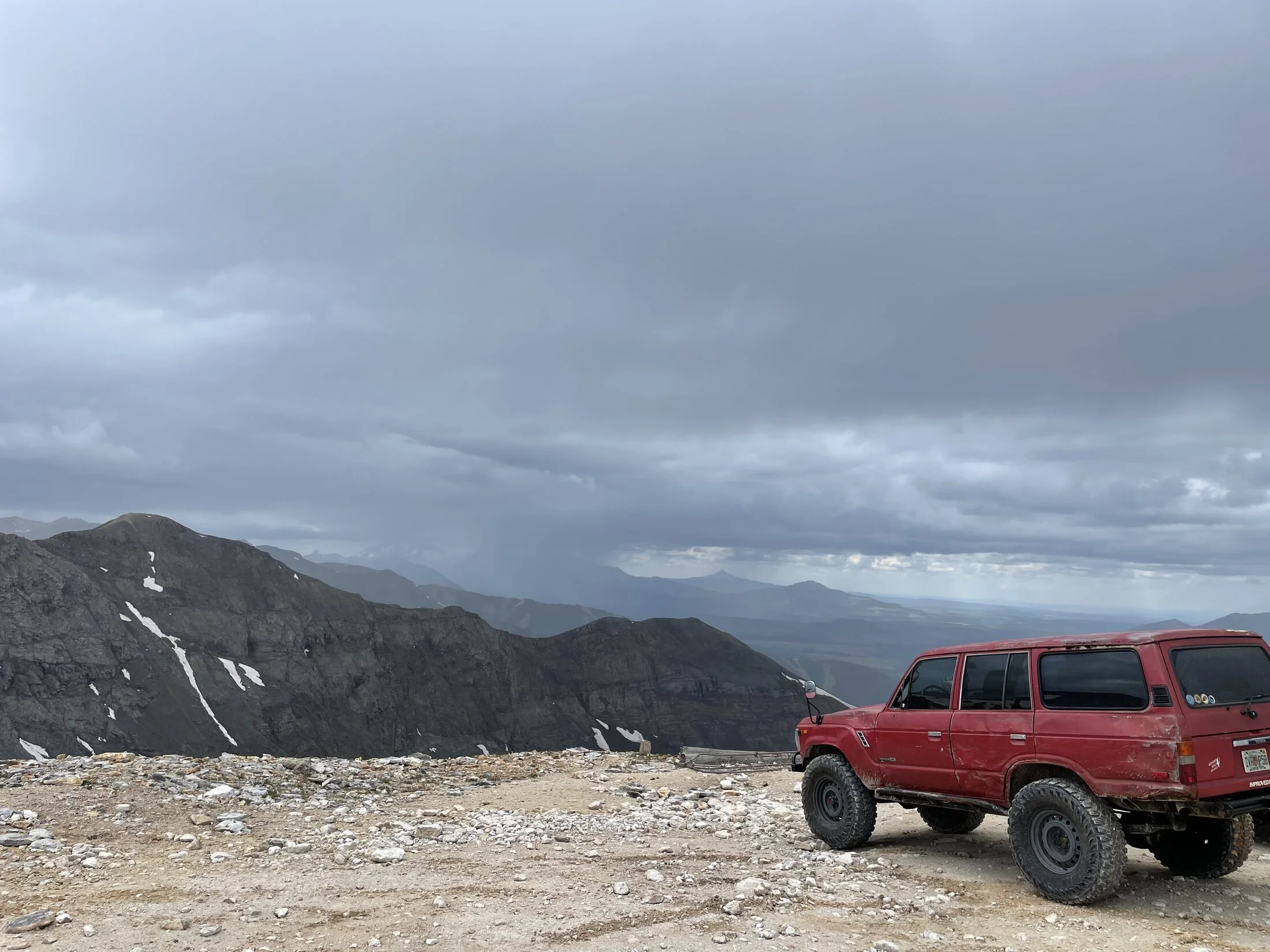

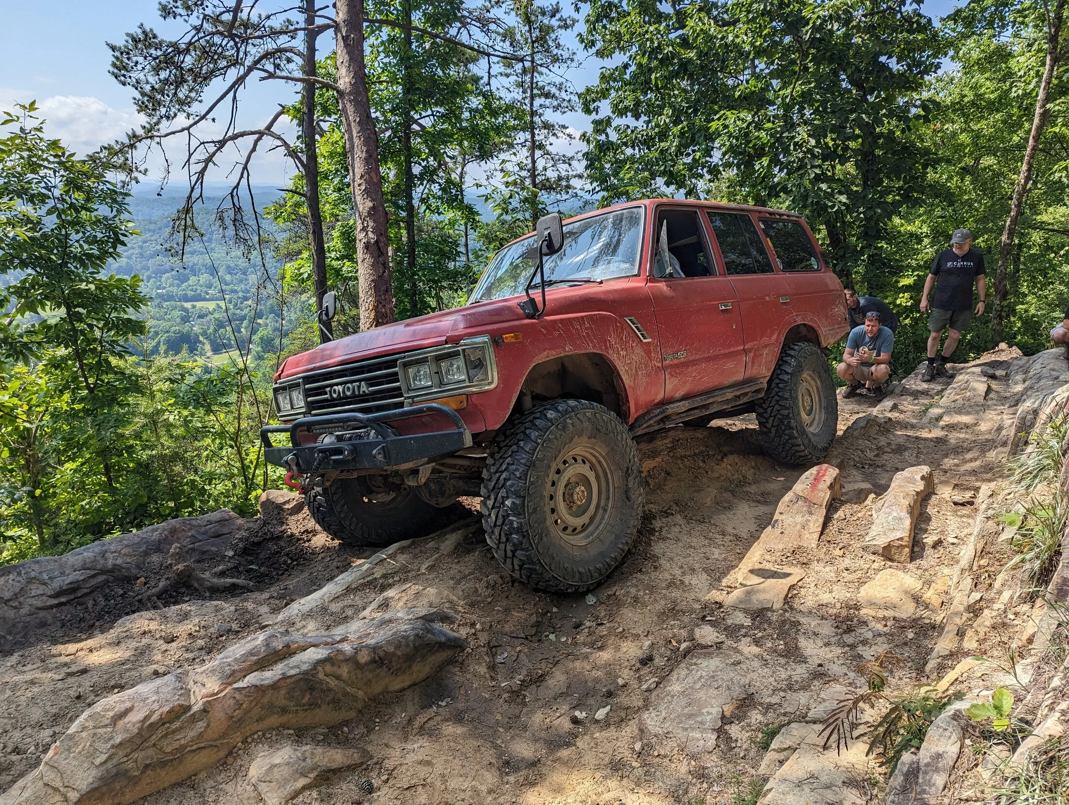

This is 80s with steelies and 37s but not really what you want

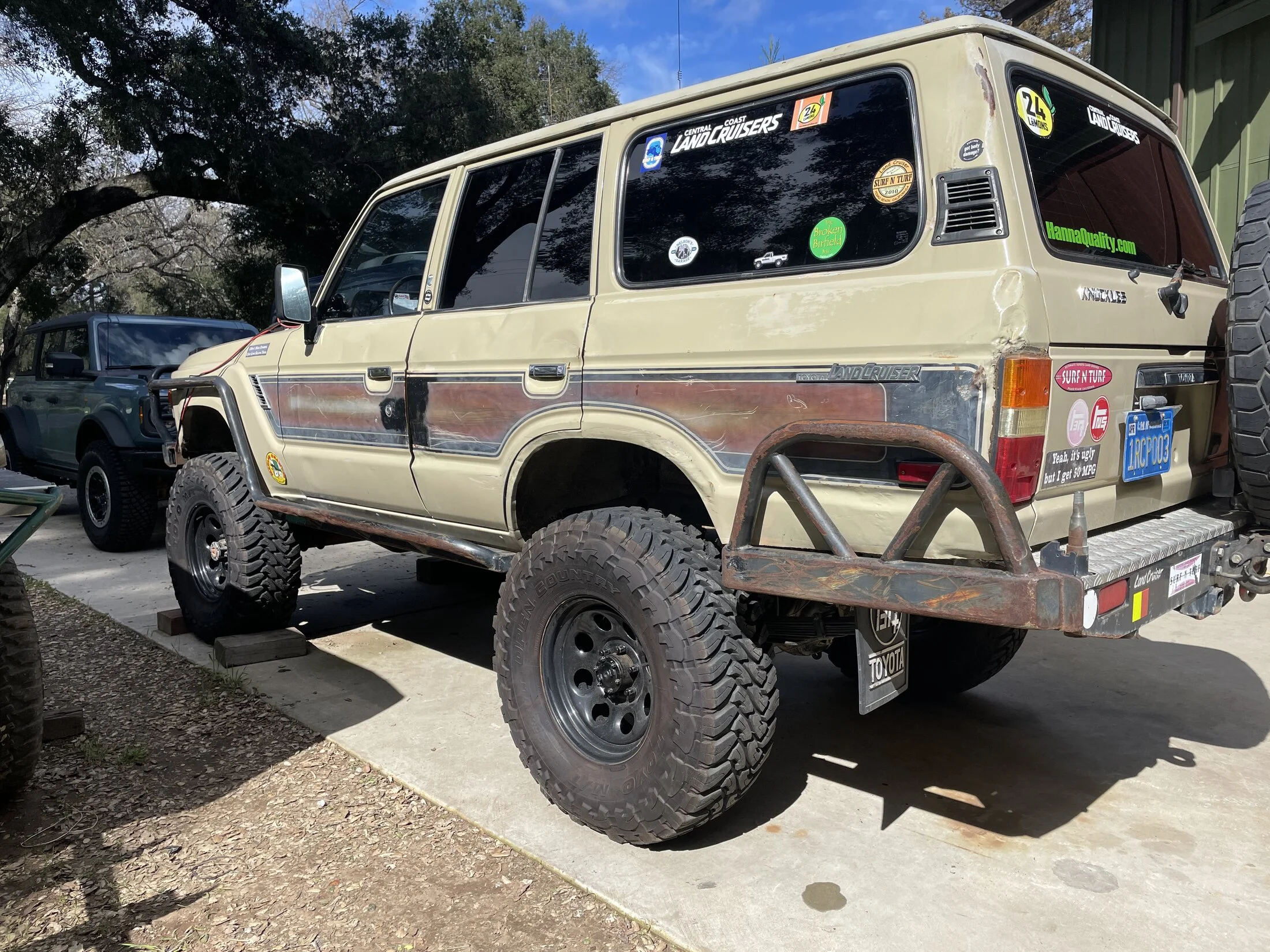

I have tons of pics on that setup…
Only been running it for +4 years :lol:
I’m 80-width too
How do you like the geolandars?
I liked them enough to replace them with a fresh set of the same thing earlier this year.
Hard to compare with other tires in terms of noise, wear etc as my 62 is pretty different then most
What I do know is I run them around 5psi off road without beadlocks and have never lost a bead or ripped a sidewall. And I use them. I ran my last set until they were completely toast

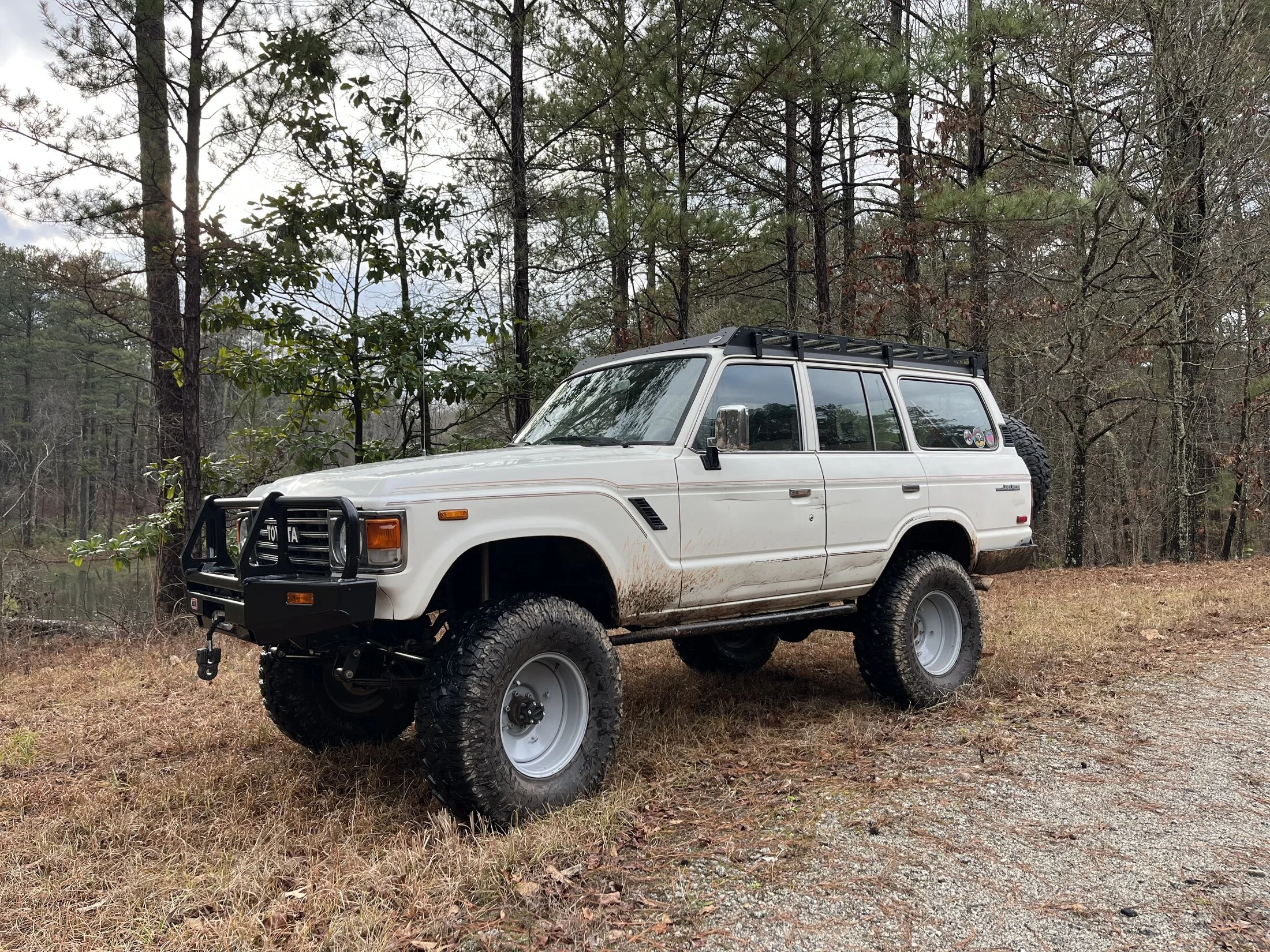

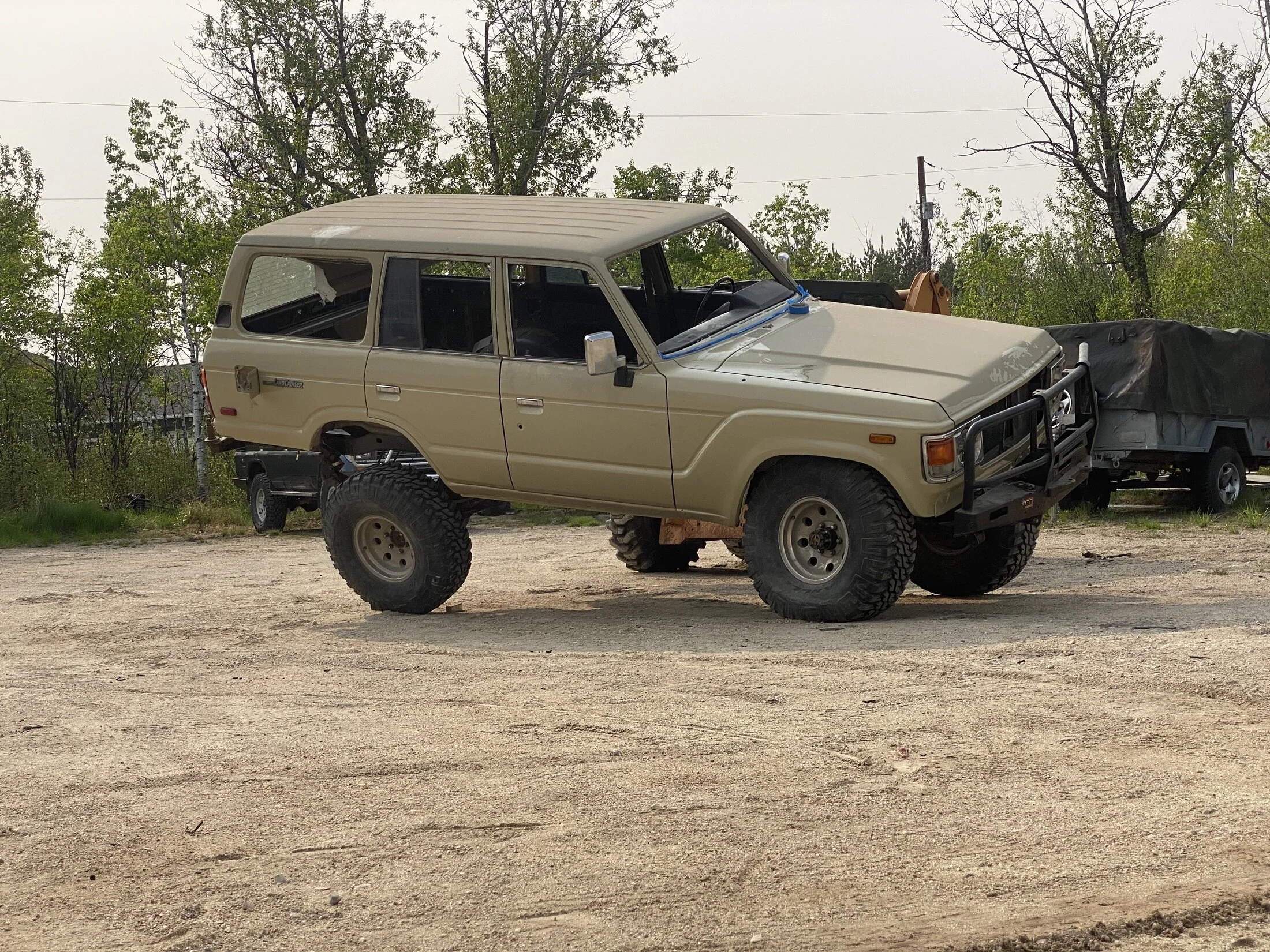

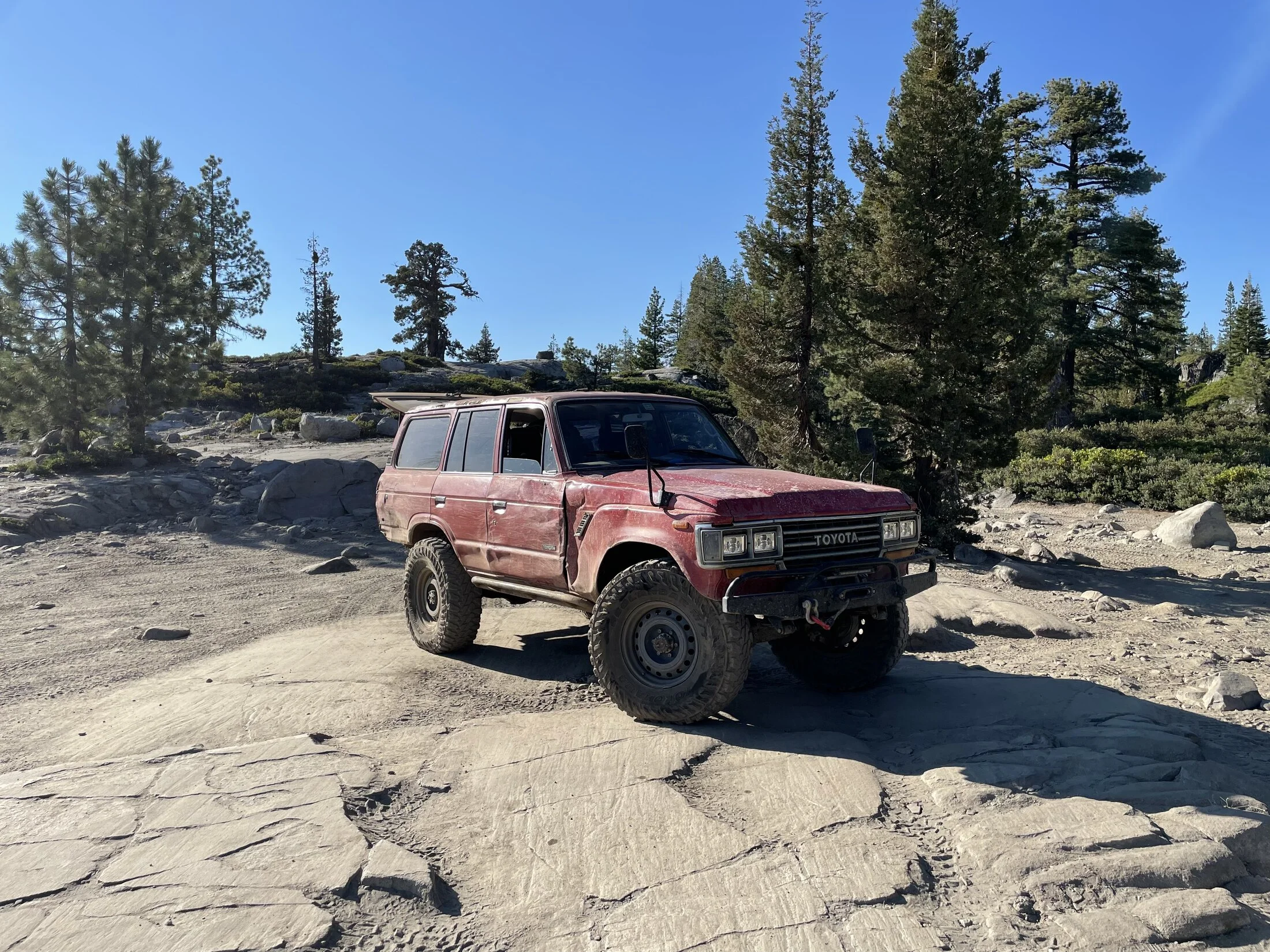

37’s on custom US Wheel steelies. 2.5” backspacing and no spacers
Holy scrub radius Batman. Also RIP semi-float rear shafts

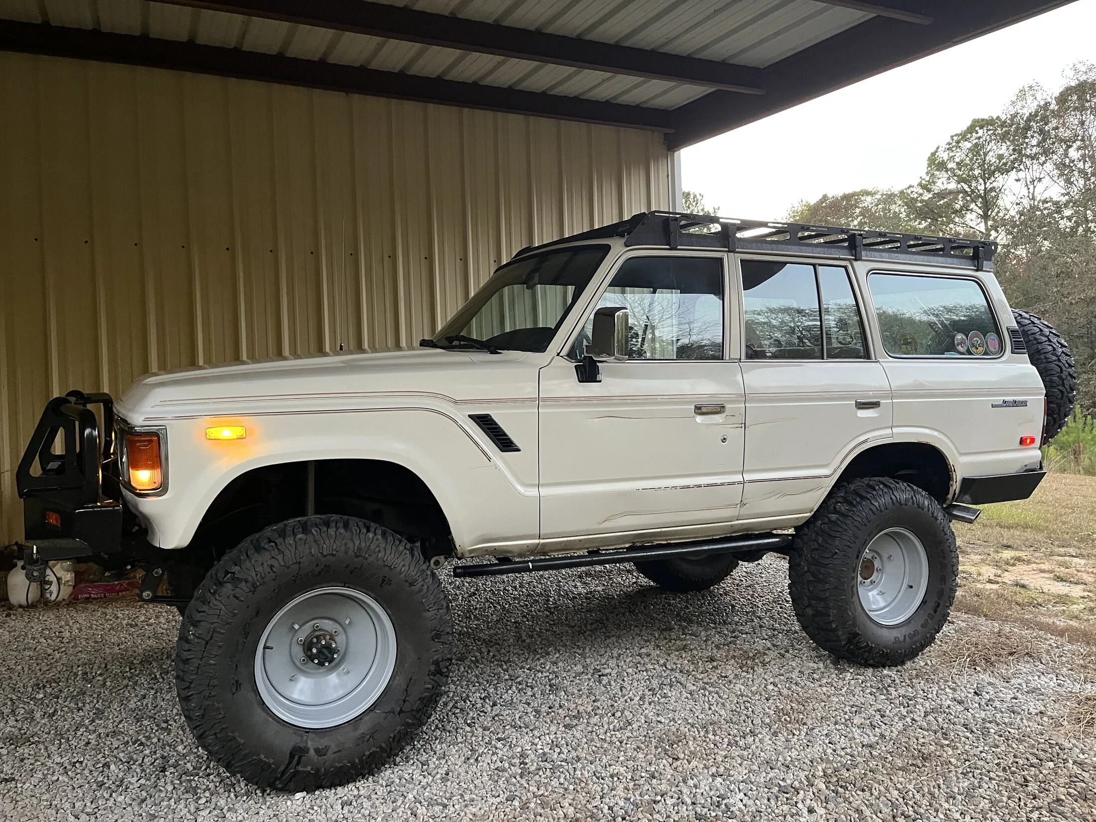

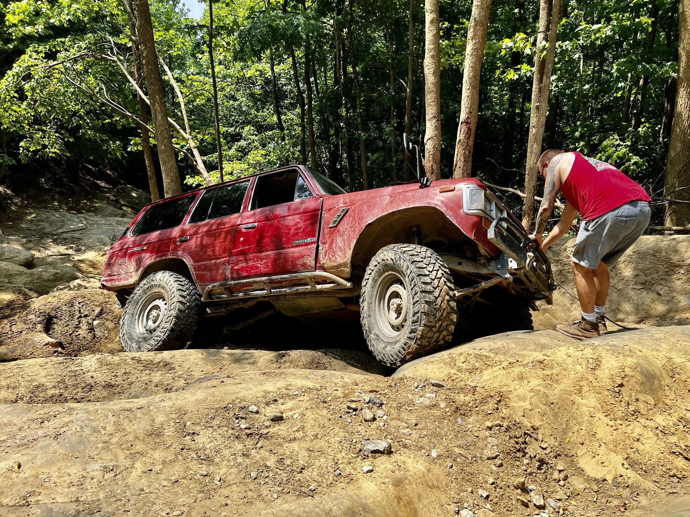

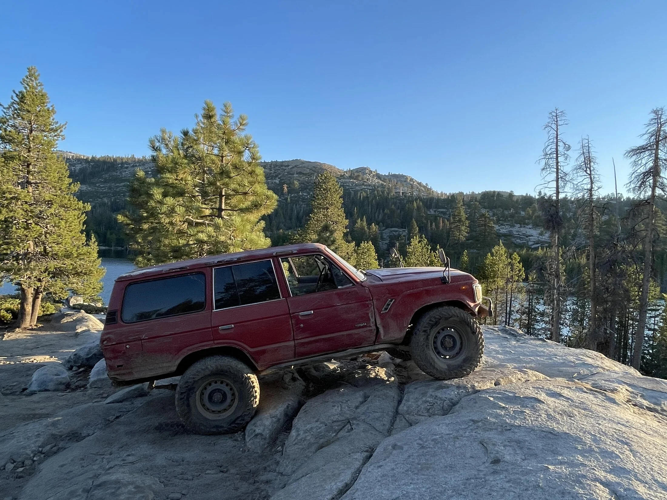

I have 37's on fjcruiser wheel's and I'm not planning to beat it up, but it looks awesome! 35''s will also flex better without cutting the front inner fenders.
37 w/ fjcruiser wheels soa. these will rub. The 35's barely fit when flexing.
35'S flexing with the same reverse eye springs SOA. it sits a bit taller then a lj78 on 33's with 2.5 inch lift.

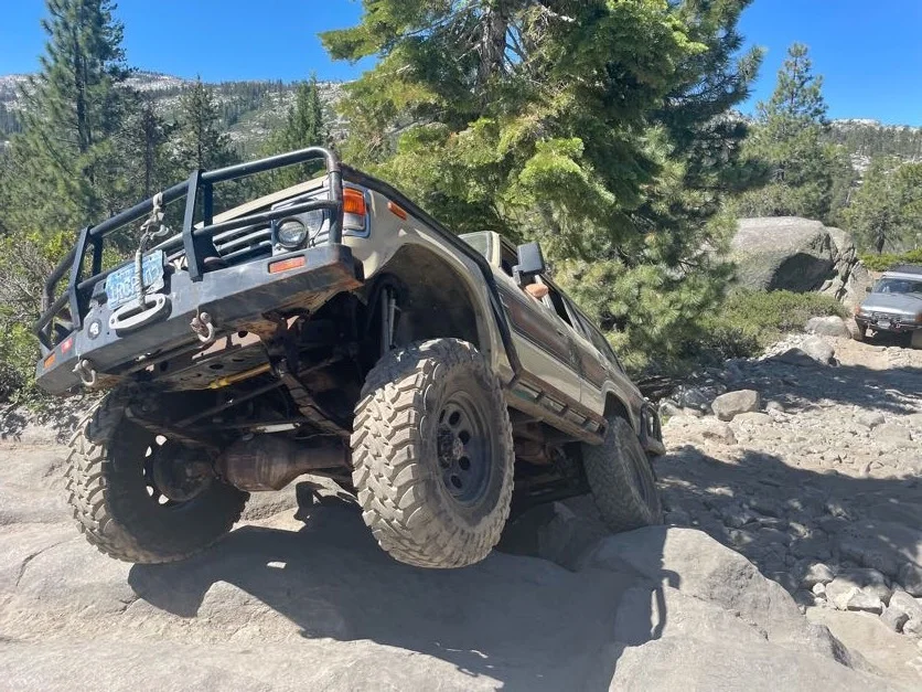

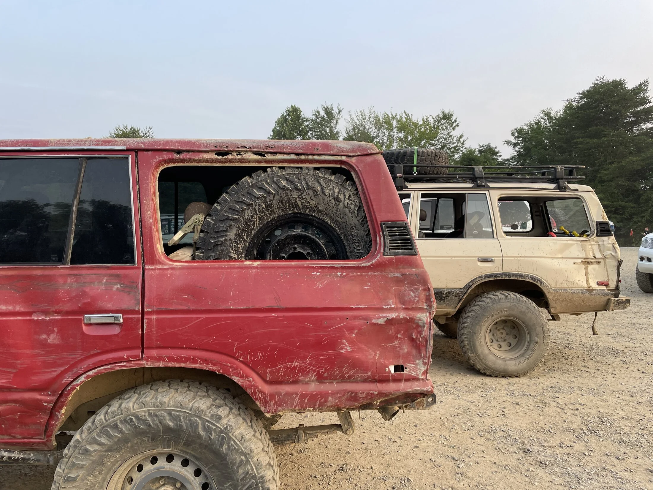

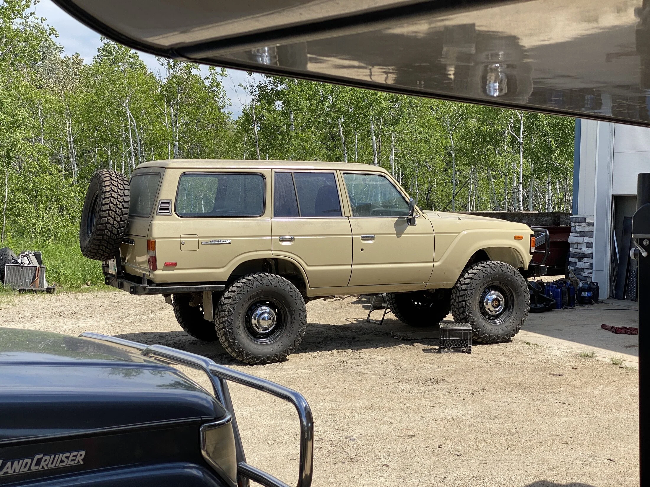

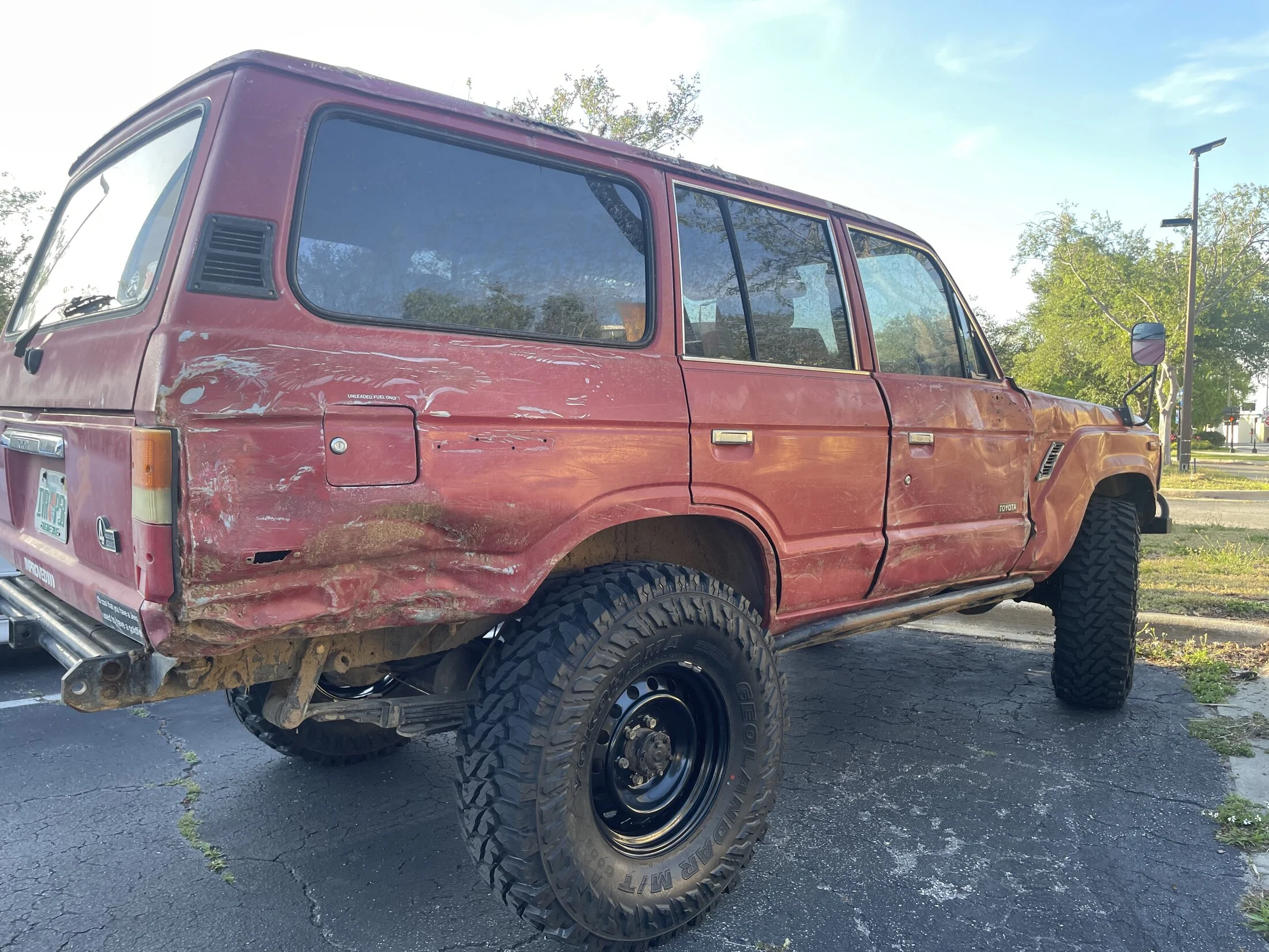

Same as Matt, 17s on 80 axles. I found that with the offset of the FJ Cruiser rims, the inside of the rear tire nearly
rides on the frame rail. Rubs the hell out of the fender well when articulating
