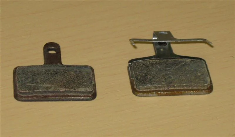

here is a pic
do they ressemble any other brand
that spring clip just pops off, not much meat on these things

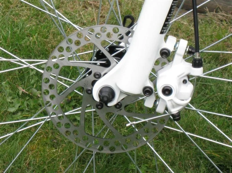

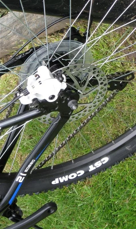

is there any trick to setting them up the front one was not mounted , do i just set it in place and tighten it up . it looks like there is some kind of adjustment built in to the mount or the cone washer type thinging on the bolt just centers it for you ?
You're going to wear out brake pads faster than you want. Are they available?
That's pretty much it. Just bolt it on, a bit loose pull the brake and it'll center/right itself to the rotor (make sure the wheel is on all the way) then tighten up the caliper.
