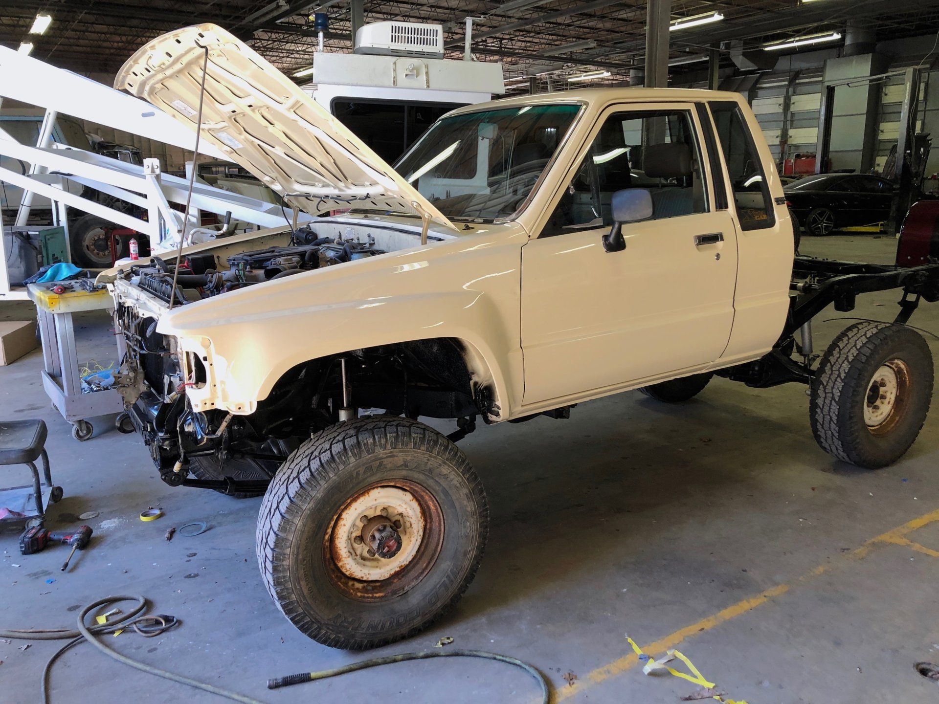

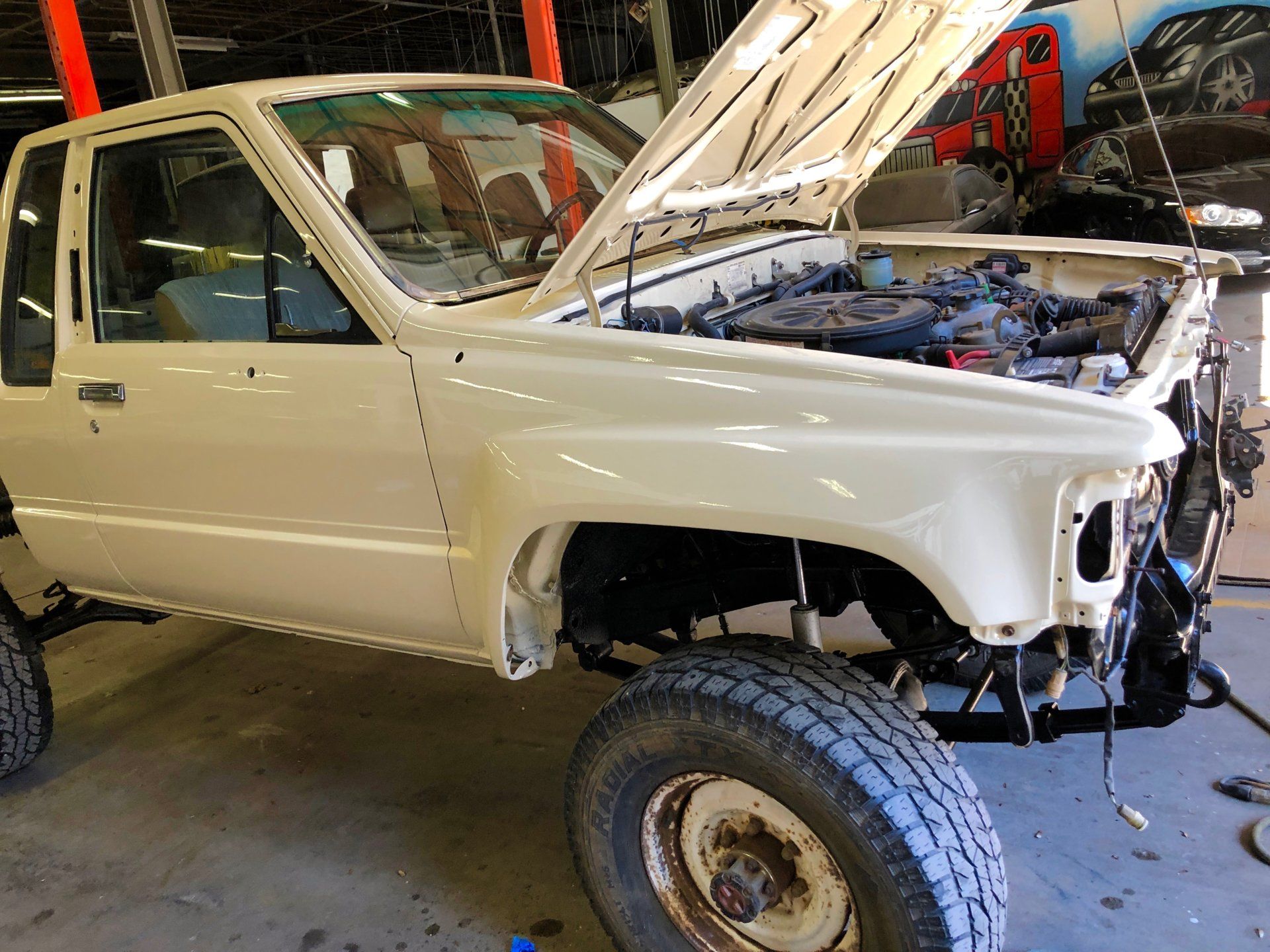

I’d say on average, it’s not “normal”, but it will yield better than average results. If you don’t have a tight budget, it’s definitely the proper way to paint.
If you just mask all that stuff, it’s much harder to properly prepare the surfaces for paint, and you often end up with paint lifting along the edges.
Did they give you a timeline for completion? They’ve had it quite a while now, no?
Those wheels are highly coveted. Be sure they get to a good home.
I just looked back... August 5 was your “green light” day. That’s a loooong time unless they are giving you a really good price!
For not changing colors, these guys seem to go all out - everything was removed - trim, glass, grille, hood... Is that normal?
Can't wait to ditch those %*#@ing wheels ;)
Are those 16" wheels?
If so I will gladly take them if I can figure out how to get them here...

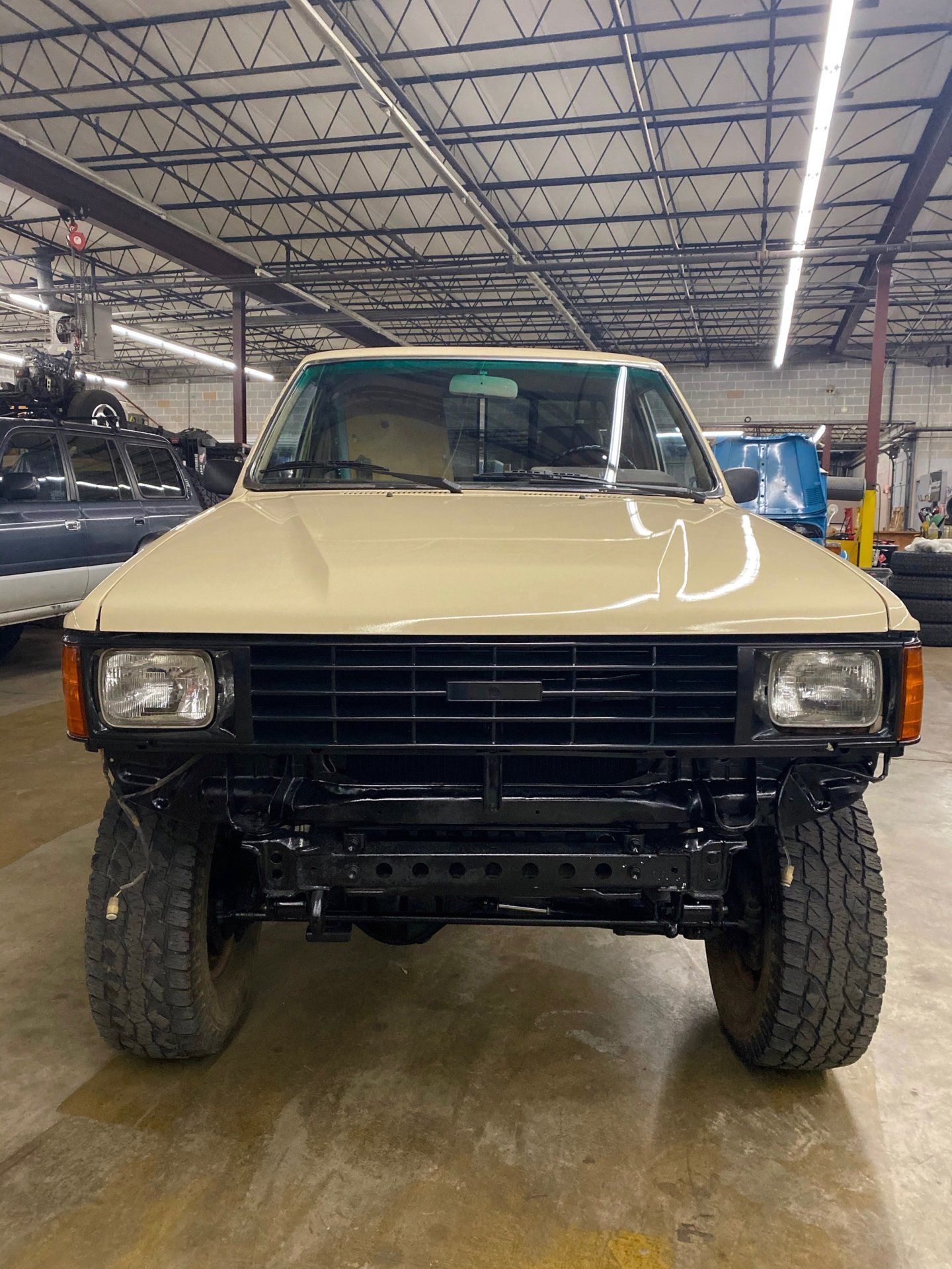

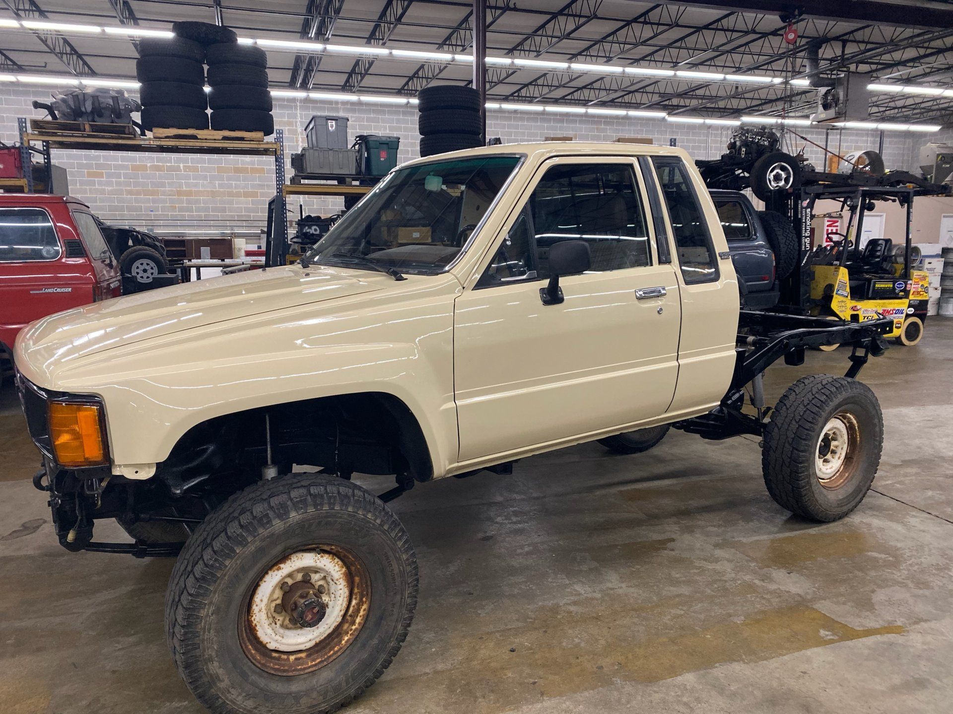

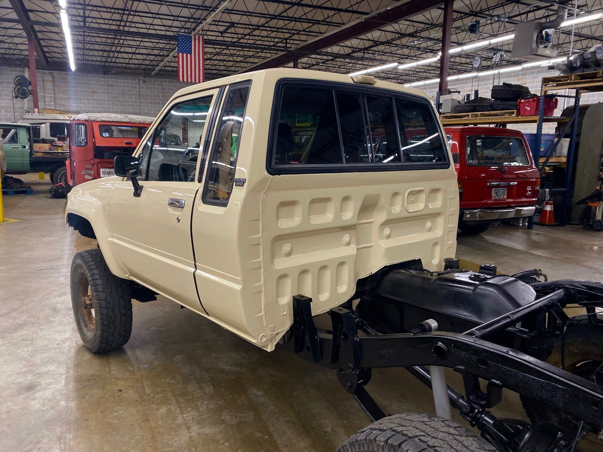

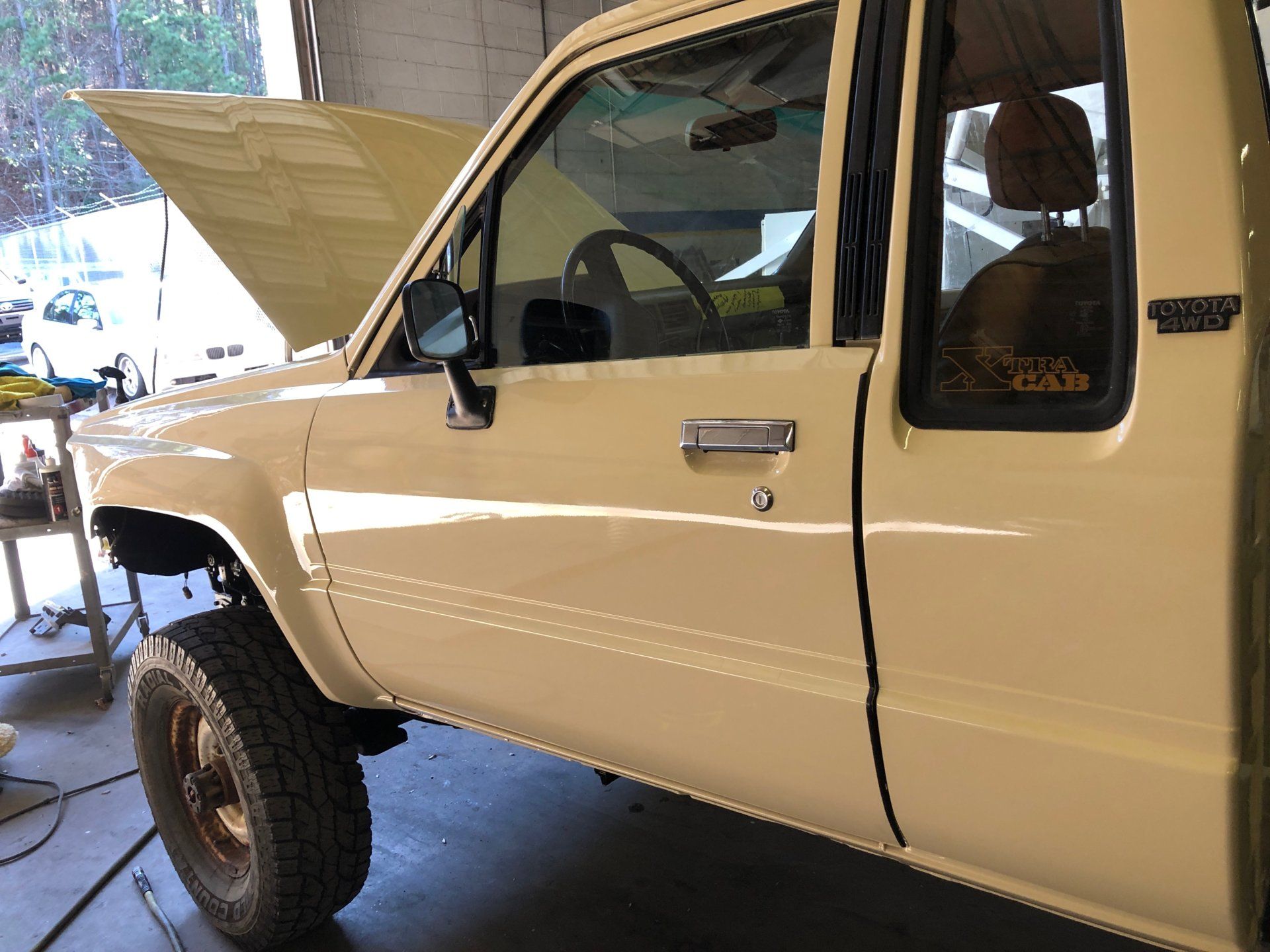

The truck is about to head over to ACC Garage. The bodyshop knocked it out of the park. Tony - the owner - said "You've been so patient so look here... " and walked me around the truck showing me what they did. This was before the fenders went on. Stuff that was NOT on the "work order":
- Pulled the strikers, cleaned up and reshot the jambs
- Redid the seam sealer under the hood and behind the fenders - and painted
- Painted the underside of the hood and cowl
- Cleaned up the frame, steering and suspension under the cab and painted everything
- Cleaned up and reshot the mirrors
- and a handful of things I'm forgetting.
So... if you're anywhere near Atlanta (and patient), I got a bodyshop for you.

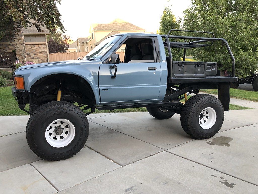

I can’t remember what you have planned for the flat bed. Looking at the pics, it’s almost a shame not to put an OEM bed and gate on it.
I have always thought @Box Rocket has the A#1 tray-back on his (son’s) Toyota truck, which I know you are aware of as you’ve posted in his thread...no matter, you have a beautiful truck and you are doing things over-the-top “right”!
Thanks @G-Cat
Yeah, @Box Rocket has one badass little truck. As similar (not really) as the trucks are, I have a hard time comparing them - that blue truck just looks like a 1:1 scale toy! It's just so well-done.
I wouldn't be surprised if the truck ends up with a regular bed. I'm keeping my eye out for a donor. It came up with the bodyshop yesterday - "... might be back with a bed to shoot". But I really do like the idea of a well-done "tray-back."
Next week, we're going to rebuild the flatbed - narrow, notch, shorten (slightly), build a spare mount (off-set behind the driver)... and maybe add some more 2" box to sort of shape the bed a bit - like, pull the lines down, e.g. box in the tail/brake lights and license plate... I have some sketches that may be working better on paper than steel ;)
Decking will likely be stained, kiln-dried PT pine. It looks really nice, but it's still cheap (compared to anything hard/exotic), so if I want to drill, cut, spill, scratch, I'm not going to sweat it.
Who knows, I may do all this, step back and say "Yep. Looks like $*#&, gotta find a proper bed" ;) But I do love the building, rebuilding part too.
Being a big fan of your 100, I'm excited to see your result. No pictures of your truck's rear-end in this thread...my only input would be to consider stock, OEM FJ-40 Series taillights. Their shape and OEM-ness always looks better (to me) than the round Jeep-style units.
