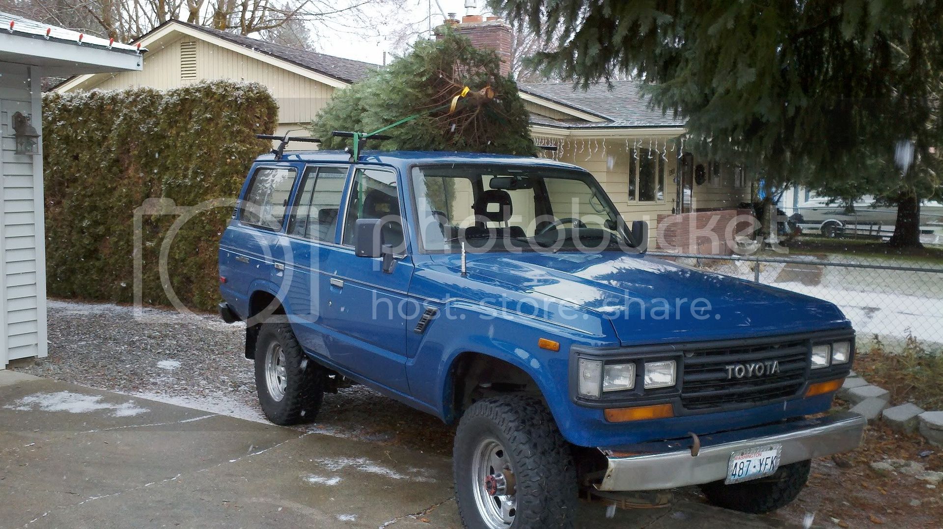

From picking up our Christmas tree this last December. Those are 31" mudders and it has a slight spring lift due to the full length Add-A-Leafs.
Thanks! How do you like the body lift? Did you get a kit or go the boat roller route?
I got the full body lift, urethane mount set and metric hardware from Roger Brown. He puts together a great kit. After researching the boat roller route and adding up what all I'd need for necessary hardware and urethane boat rollers, the cost came to just a hair under the Roger Brown kit, with a ton more work involved. I've run it for a little over a year and I love the setup. 1" is the most I would go, just for the sake of dialing in what, for my setup, is the ideal height for running 33" tires while allowing for decent flexibility (I've also removed my sway bars years ago) without rubbing. The only real caveat is that the ride is alot "sharper" for lack of a better way to put it. I use polygraphite bushings in my springs and with the poly body mounts, I feel every little detail in the road. I personally don't mind it, but there aren't many people who exactly enjoy riding in my truck after driving their cushy cars or SUVs :D

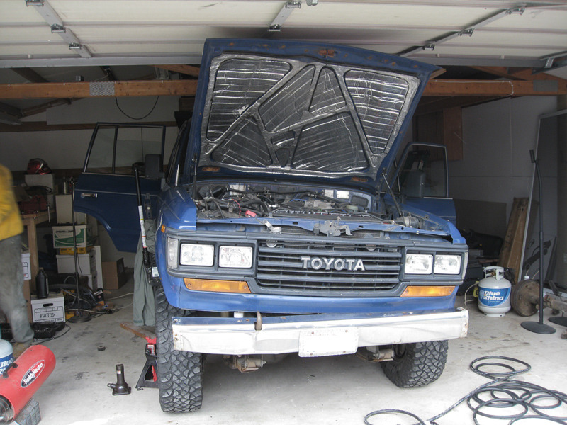

Edit: here are a few more pics I found from when I installed the kit (with the help of Climber8483 on here, who was compensated with steak and beer)

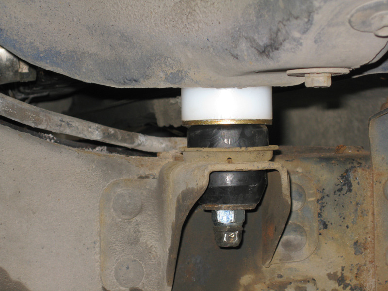

Hardware
One set installed. IIRC there were twelve in total. Six for each side on a 60/62 series
One side completed. Epic Cruiser Lean :D

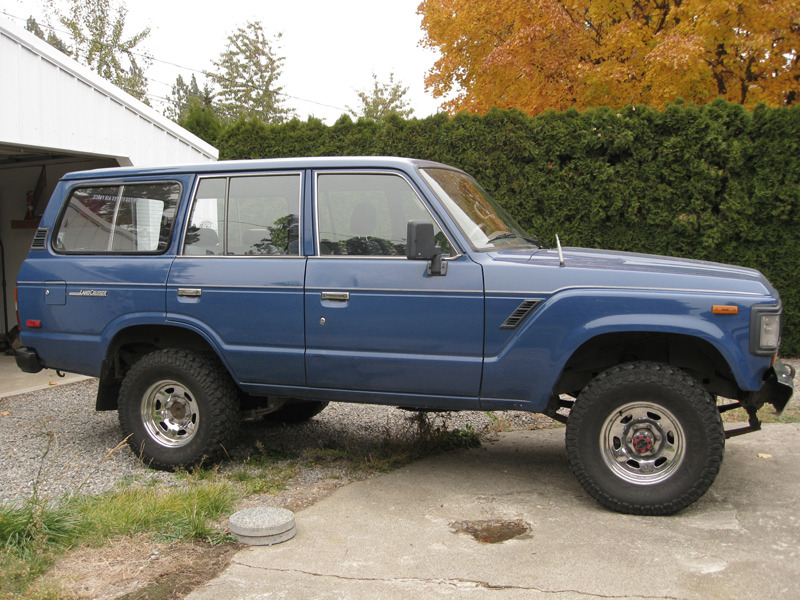

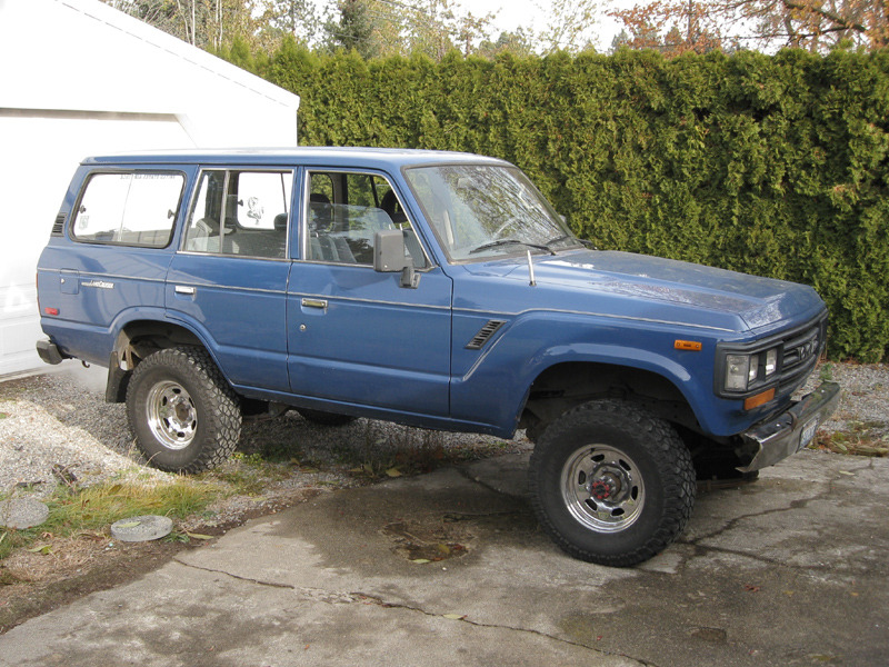

Side shot before installing the kit
...and after:

Yeah the bushings create alot more of a solid feel overall, which I like. The combination of poly spring and body bushings really help it feel like a solid new vehicle again and less like just some old truck with worn out rubber bushings. I'm hoping I can compensate for the stiffer, rougher ride by converting to Chevy 63" rear springs at some point in the future and moving my current rears to the front. With any luck that'll help improve overall ride comfort.
