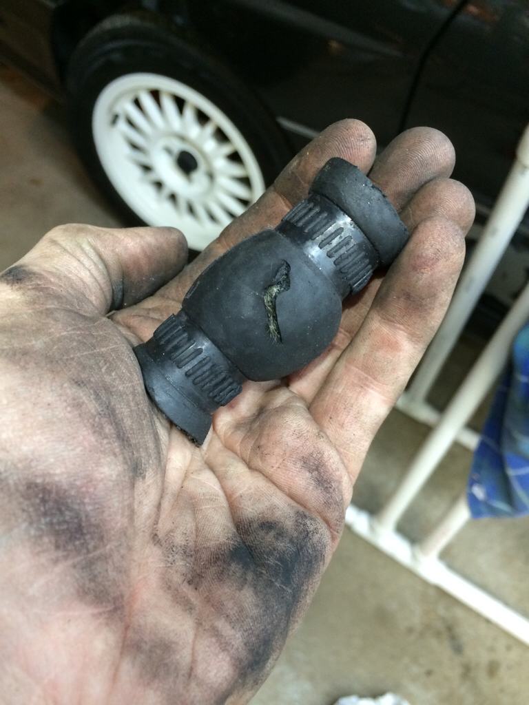

Pipe is looking a little worse for wear.
You realize they rot from the inside?
Yup, all other hoses I've done on it point to clean and good inside. However, keeping an eye on it (and other small ones) but opted to not replace on the last go-round - maybe next time I drain coolant.

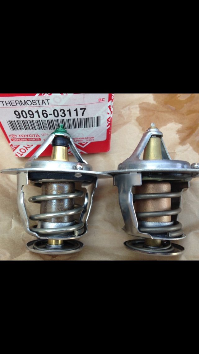

I don't have any pics of any old hoses I've replaced - but here's a pic of the old thermostat (next to the new),

For 230k+ my phh was in relatively good shape, though it did have a pinprick hole in the center that had begun to leak when under load on hot days.

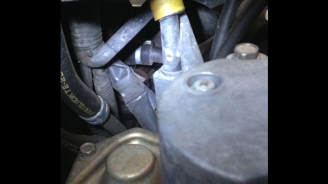

I had the misfortune of having to do this today.... FUN --->NOT!
But FWIW heres my 2 cents.
tools
8mm short gear wrench
12 mm to listen top tube bracket bolt
pry bar
optional (dominator radiator hose pick set) great to have
CALL AHEAD ASK THEM TO PHYSICALLY PULL PARTS OR TELL U CLOSEST STORE W AVAILABILITY
Qty .25 /ft napa "NBH H504" say h504 ->Hose silicon blue gates Part # buy .25ft (its a bulk Part number so they should have no issue doing it)
qty 2 # "BK 705-1500"ask for 705-1500 is constant torque type
or qty 2 (at the least)705-1550 which is the lined clamp good for silicon no pushing out
also some silicon spray to wet the inside. jack and support front driver corner remove wheel
remove inner shield to look similar to my pic. remove upper 12mm tube inlet pipe clamp
follow best effort to kill crappy cotter pin stainless headache clamp. then gut with dykes
use small vice grip needle nose to release std toyota jap squeeze clamp if needed use a hose pick set to release grip or slice w box cutter
cut napa nose to same exact size as oe or if apron 2.25 inches (pre tension clamps to be close to end size)
use brute force to move tube away from cyl head fitting.
take new silicon h504 piece spray inside w silicon shove onto cyl head nipple. spray hose again fight clamps between hose and inlet tube to get onto tube i aligned my clamps nuts to point down toward rear so they angled for easier tightening
alight tube close by hand (hard to move but close is fine due to silicon hose and spray)use pry bar to force tube back towards block (watching to make sure no pinch or burrs, catching on edge due to bad alignment)
took me less than 2 hrs for the physical get to and replace then an other hour or so to flush and refill then bleed.
I wish u a smooth fix
Cheers
Ed
FWIW
