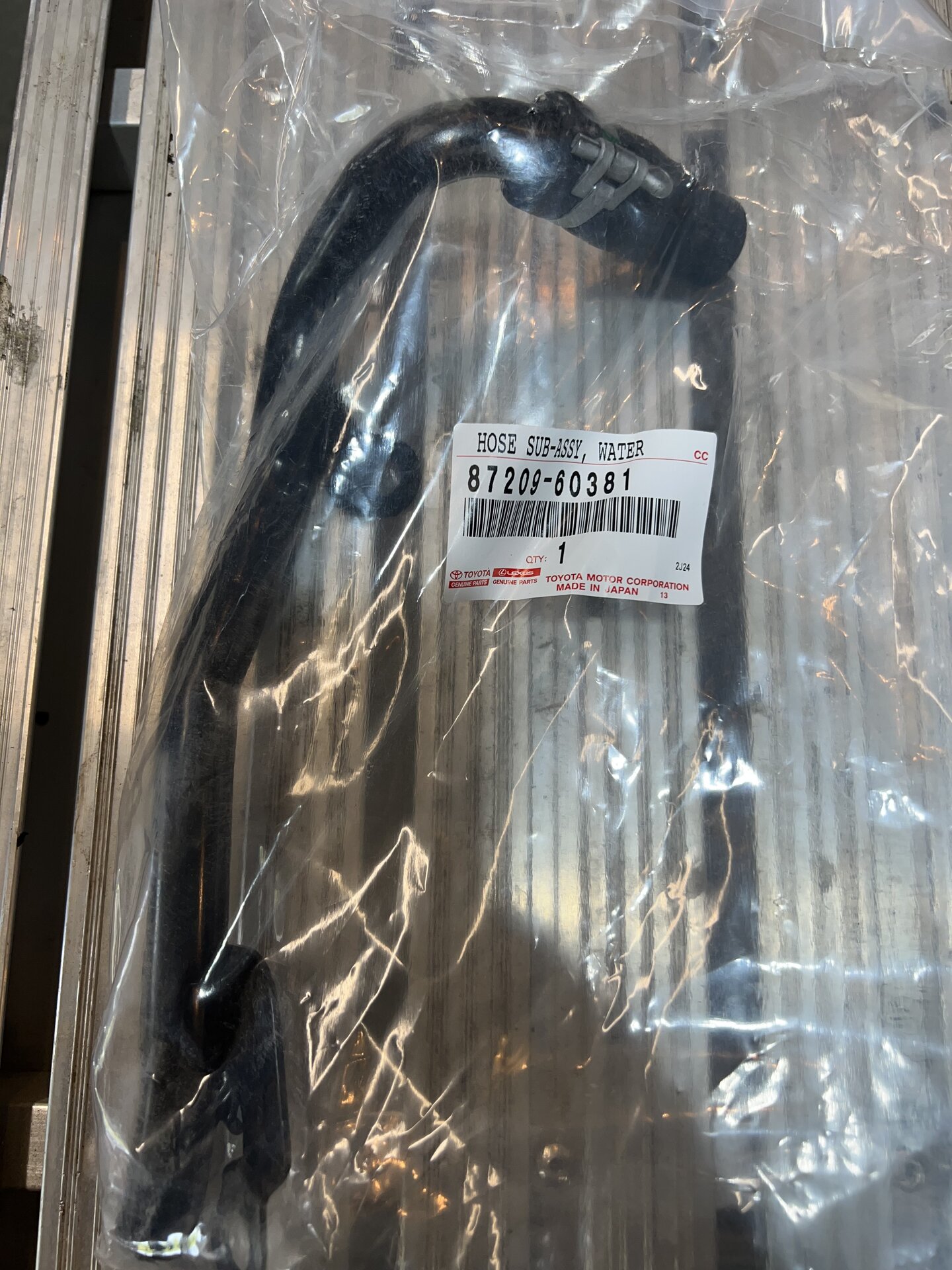

Part arrived.

Gates Green Stripe on the left. New OEM hose/pipe assembly on the right
(IIRC the scuff marks inside the OEM hose are from a test fit on another pipe).
To be clear, I cut a section of 5/8" Green Stripe the same length of the OEM hose section and attached it to the PHH pipe and head using Gates PG thermoplastic clamps.
