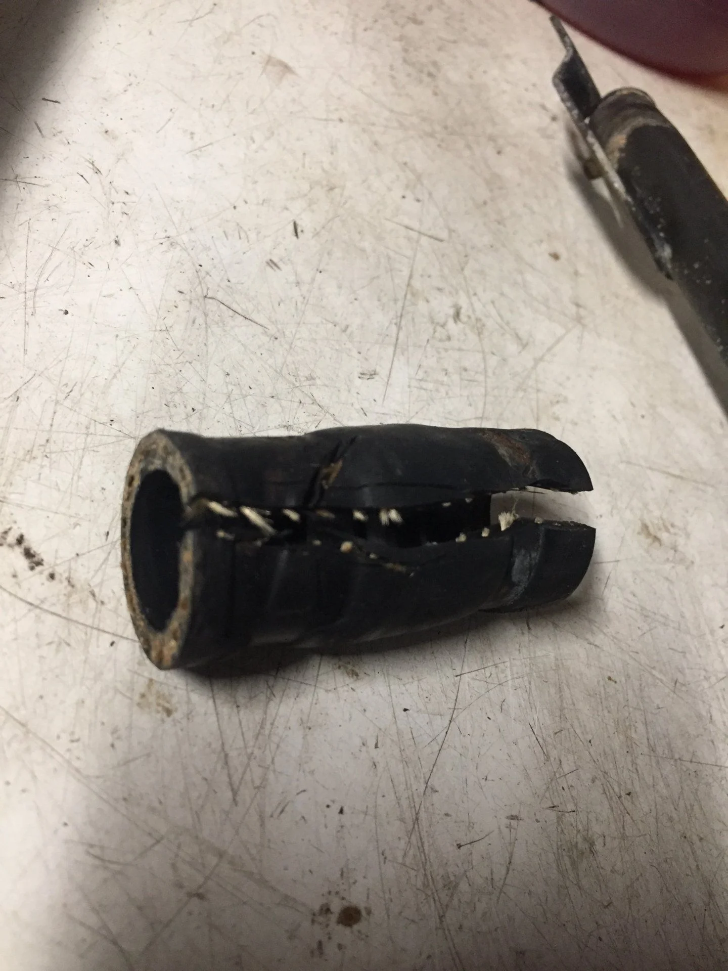

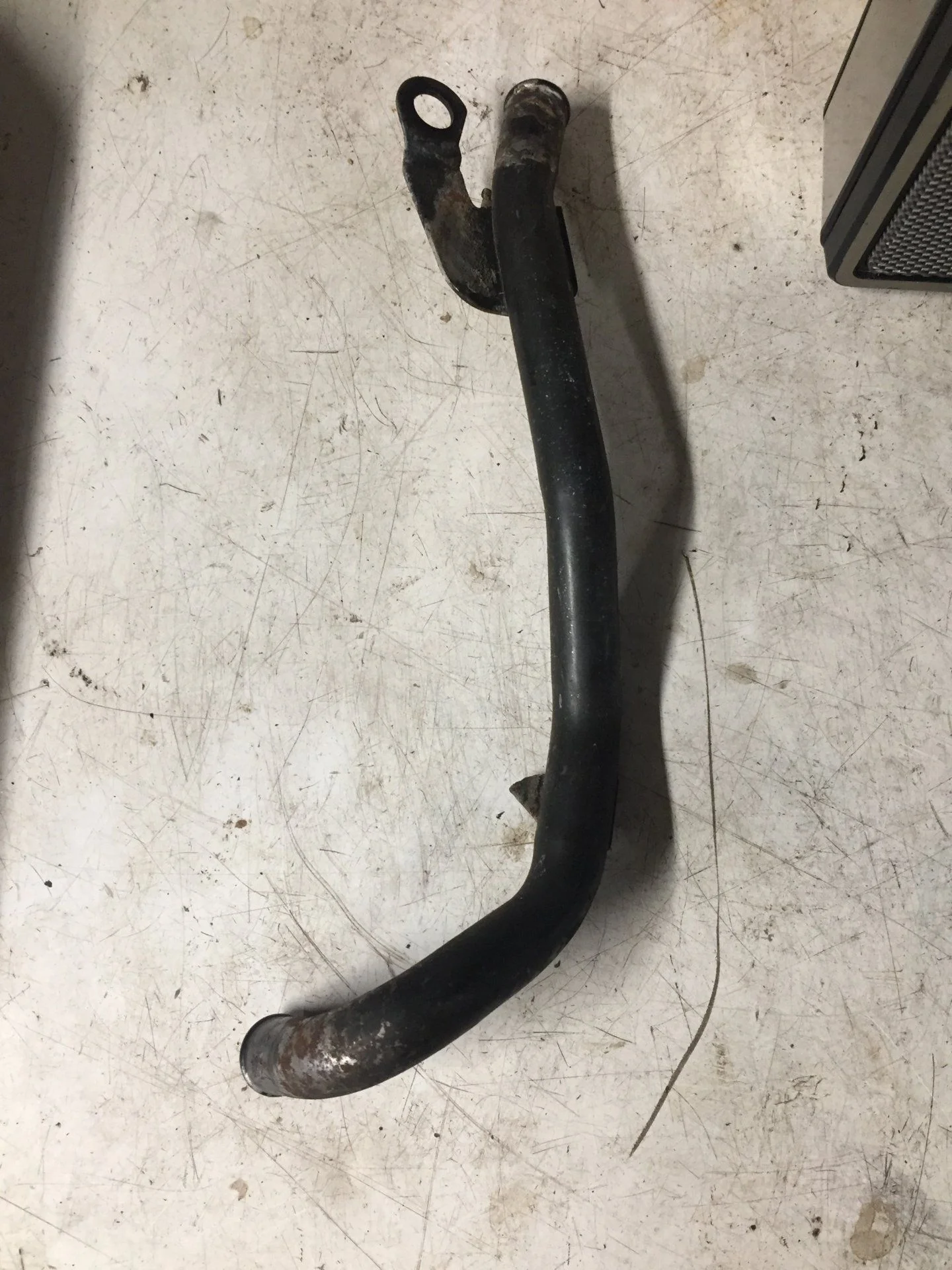

Did the PHH bypass this week.
Truck is 1996 with 200K.

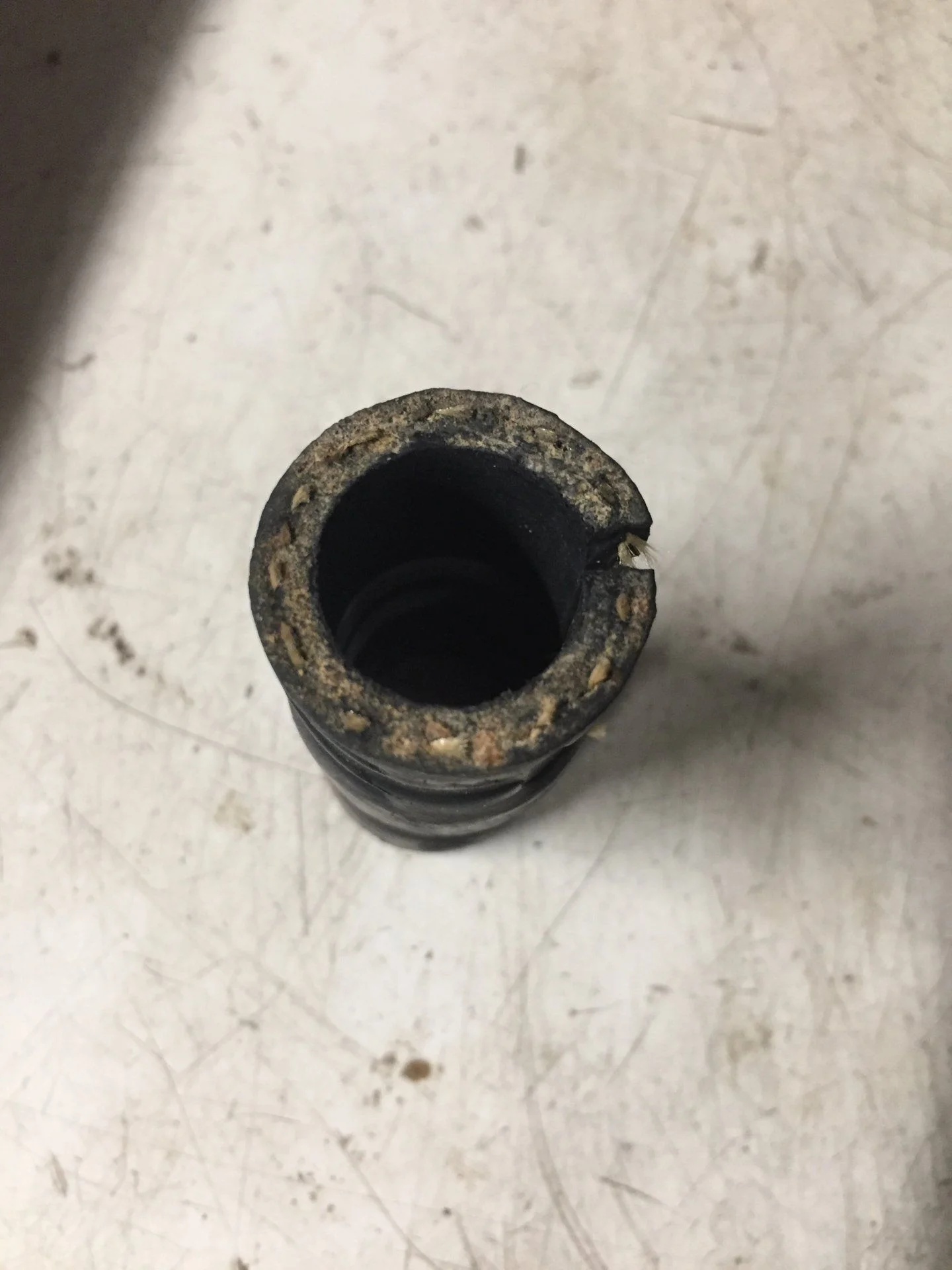

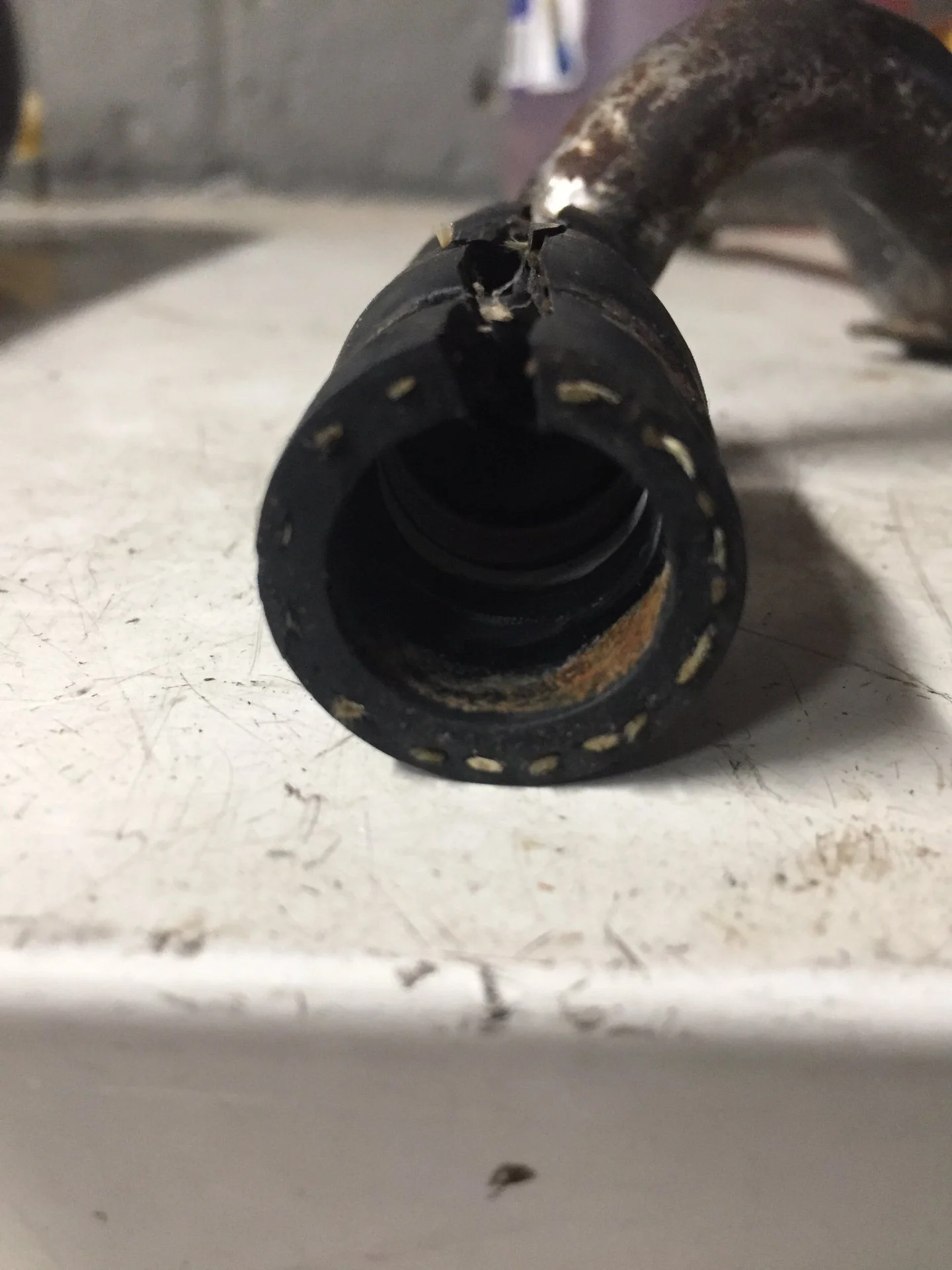

Did not look to be bad, but unless hose is bulging I'm unsure what a failing rubber hose looks like?
Did the full Bypass with Gates (white stripe) and Breeze Constant torque eliminating the Metal Tube and both long and short pieces of Rubber Hose. I was careful to make sure hose will not rub on anything.
I could not get the Hose clamp on Nipple to Move using 1 hand so I cut it with Dremel on cable. Was not an easy job. I think I spent more time on this than doing the 3 oil seals.
I Removed the top Bracket Bolt on solid pipe then wiggled it till bottom clamp busted.

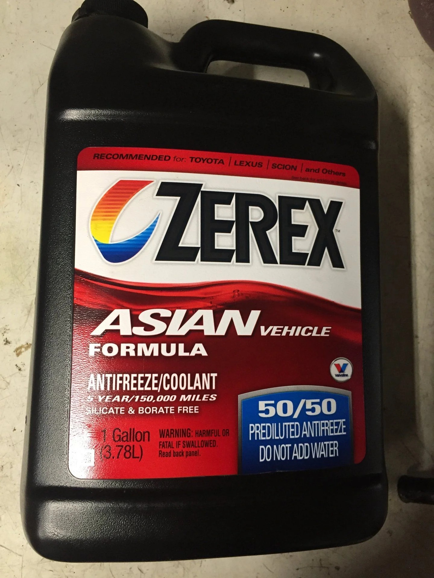

Been using the Asian formula from Napa for $15 (already mixed) and it seems to work as well as Toyota

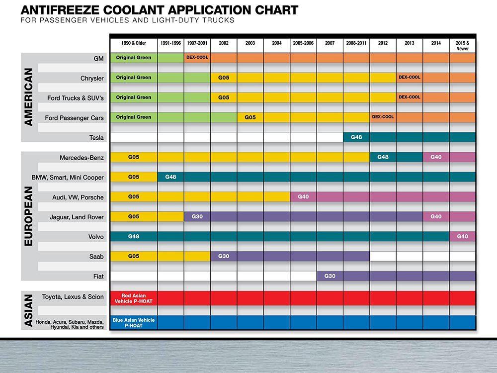

Why is Tesla mentioned on an anti-freeze chart?
Tesla batteries have coolant to regulate the battery temperature. Using battery power.
