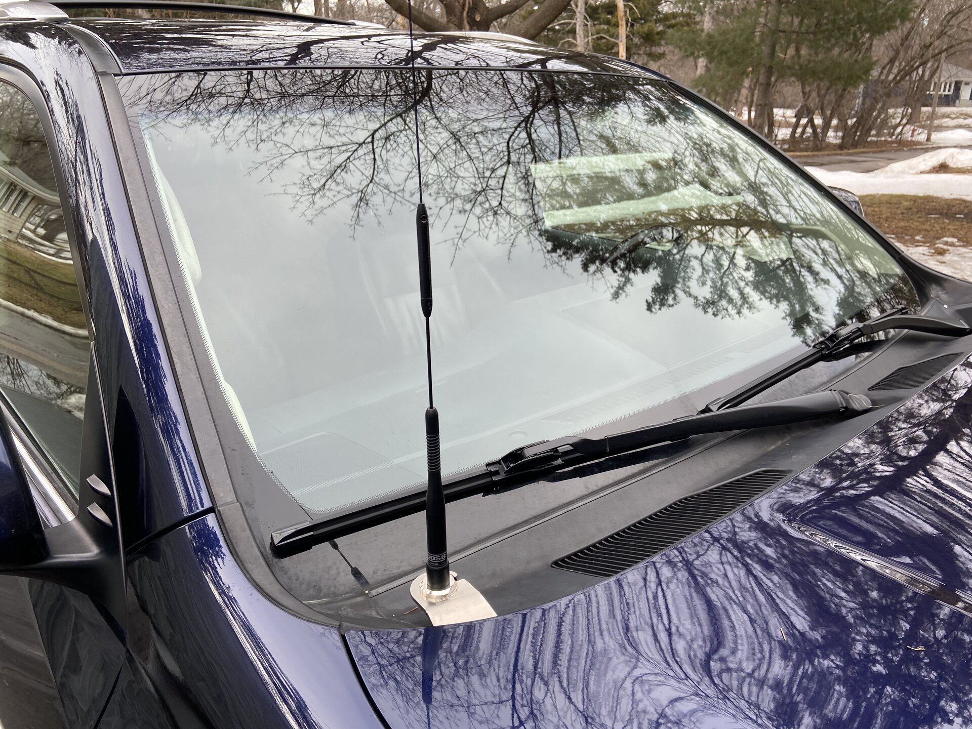

I have my 2m antenna on a fender mount with the coax run through the main harness grommet into the cab, under the dash and center console to the receiver under the passenger seat. I mounted the remote head unit (Radio is an ICOM IC-2730A) on a RAM mount arm in the storage cubby below the radio, which makes it easy to remove (just leaves the ball in the bottom of the storage area)

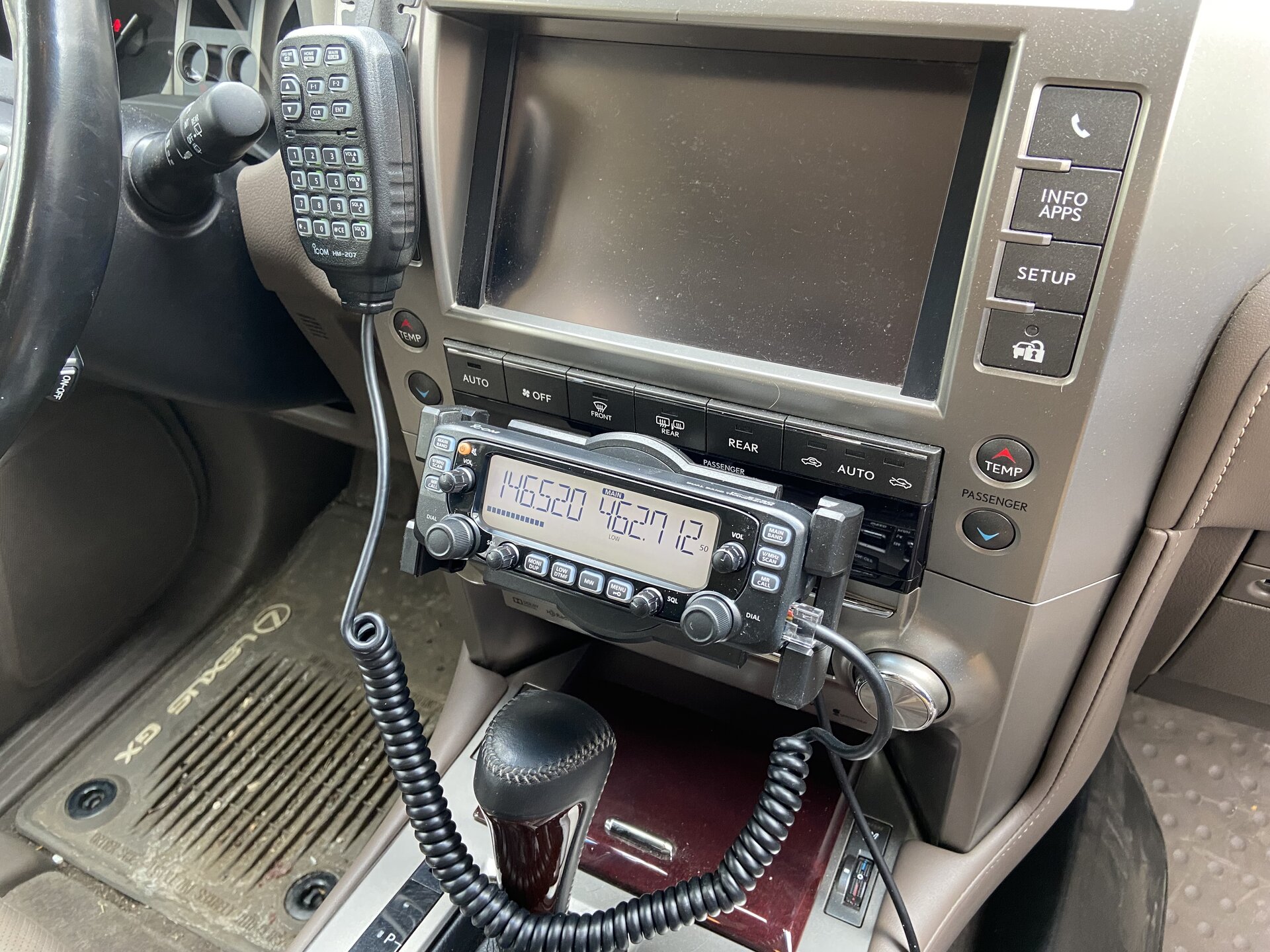

I use a CD slot phone/tablet mount for the radio, and a Kaon hood hinge antenna mount. Coax is run through the passenger side main wiring harness grommet. I'm happy with it. You'll want to get coax with a removable connector to make it feasible to run through the grommet.

How do you like the CD mount? Been considering them, how does it handle offroad?
It works well for the radio faceplate, which is pretty light. For a phone, it is pretty stable but down low, and if you like your phone to be vertical it will interfere with the shifter. For the most part it doesn't block access to any of the controls, but can block view of the clock.

I like the clean look of the cd slot mount for the mobile radio faceplate. Are you still pleased with its performance? Do you remember the name brand or perhaps have a link to that one? Thanks.
Brand name is Woleyi. I've had it a few years so not sure if they are around any more or not. It still works well for the radio faceplate.

Found it - I couldn't find it in my orders, but when I searched the jungle for Woleyi it said I bought this one in 2021.
