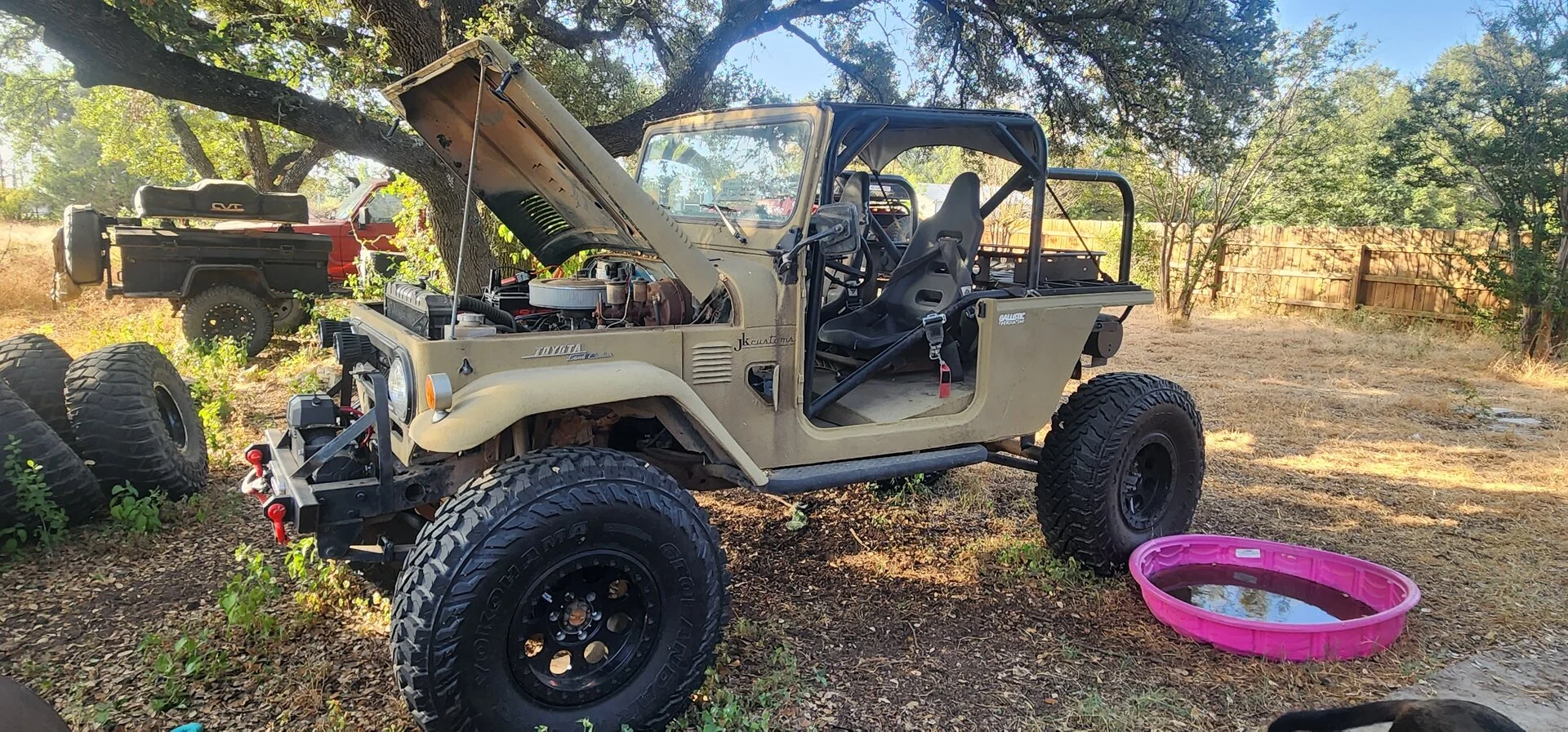

Back in town for a few days and decided to get everything running again. Big Red was the only truck to not give me issues, but did take a second to start in the freezing weather after sitting for 9 months.
Penelope gave me a hard time. I had to get a new battery, and figured out why it cranks but no spark. It came down to water and dirt getting in the fuel tank. I drained roughly 15 gallons out. Cleaned out what i can and changed 3 fuel filters before it ran right. But now I'm driving it down the highway and it pulls strong.
I had to jump start it at one point because I drained the new battery.
it was easier to have the pump do the draining.
This fuel filter was from 9 months of sitting.
This one was from driving 5 miles down the road. It started hesitating so I bought more filters and headed home.
This is where all the dirt and moisture entered the fuel cell. It's been sealed since.

Well I got her up and running. Turns out the new battery was faulty. Only took me half the day to figure it out. Drained it from bad gas, the fuel cell doesn't seem to be water proof. Then took her for an easy drive. She did 70mph no sweat. She needs an oil change and the holley Sniper install
It's back to having fuel issues. Seems like the foam in the 20 gallon fuel cell is disintegrating. It started hesitating at 65mph. Pulled over and changed the fuel filter ( I learned to always have a spare or two). Drive 5 miles home and the new one is already getting clogged.
Here's a two day old one.
here's a 5 mile old one.
I also stopped at a welding shop to get a quote for to reinforce the tow hitch. Looking to add a spare tire carrier and to be able to pull my trailer for the Colorado trip we're planning. I'm going to need a few more quotes as these guys can't get me in until at least October.
Been looking for welding shops near me. None were allowed by their insurance to touch an automobile. However, I did get a referral to a guy who will take a look at in on Monday. Hopefully this gets done quickly before the spare tire carrier arrives.
I also changed out the oil. I put in Mobil 5w30 synthetic, it was on sale and is generally a great brand. I ended up with 6.5 quarts in a Chevy 350. The oil filter alone took 1.5 quarts. I thought I might need 7 to accommodate the lines and the oil cooler, but will see how she does the next few days and I'll adjust as necessary. I drove it for a while, she seems to be doing well. No hesitation yet from the fuel filter getting clogged. I might power wash the inside of the fuel cell and take out the foam if that keeps happening. Managed 72 mph. It's crazy on my 62 with the Cummins it does 85 easily. This one seems to top off at 70ish mph.
