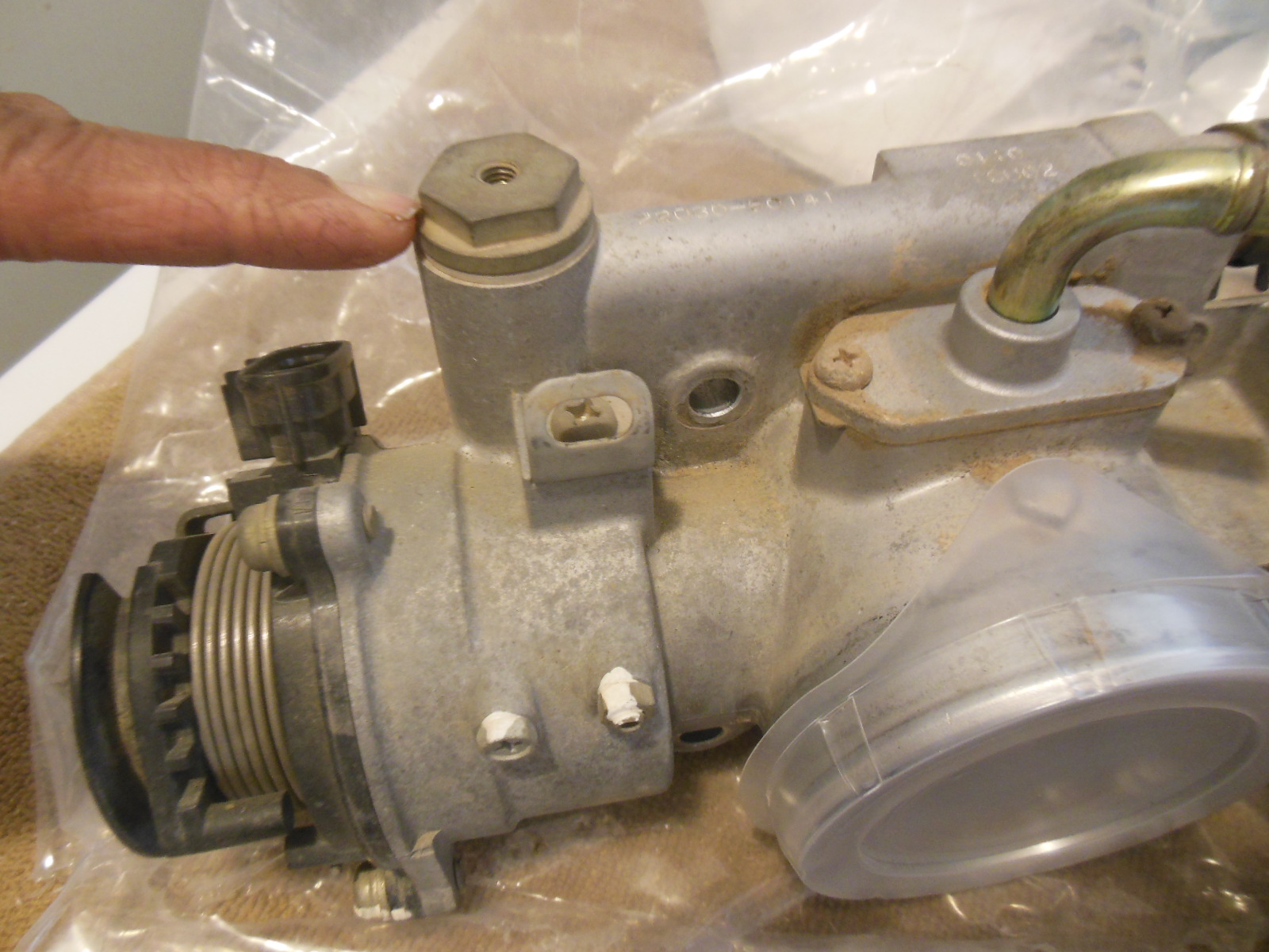

I think the top bolt 17 mm? located near the APPS on the throttle body is to remove air bubbles in the cooling system. I noticed that after completing a cooling system flush.

:hmm: What 17mm bolt (picture)?
The bolt I am pointing at. I saw Montero's have a bleeding valve/bolt at the top most location in the cooling system. The chamber attached to that bolt I am showing in the picture warms up with coolant running inside. The other end is attached to a hose which is connected to Oil cooler pipe in front of timing belt cover.
I recently replaced the throttle body on my 00 LC with 240K miles with an OEM new unit along with the new Denso radiator, Aisin Fan blade and OEM fan bracket.
