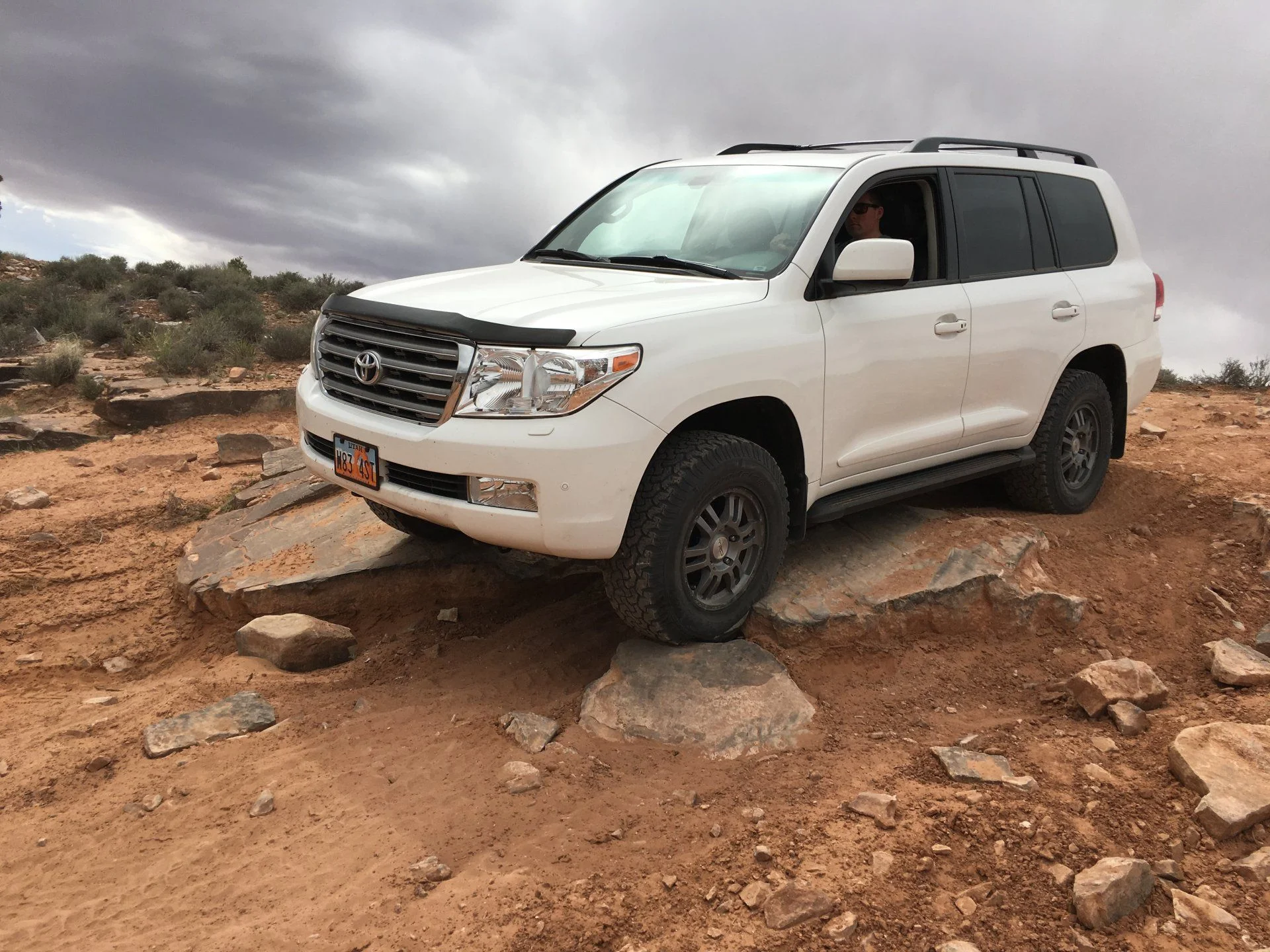

Been lurking on Mud for some time, but finally ready to jump in. I appreciate all the advice and tech here. After years of being “too busy,” I finally got my priorities straight and am stepping back into the scene. I have had many built-up Toyotas in the past, so I am not necessarily new to off-roading or Toyota, but I am definitely excited to have a cruiser.
After more than a year of watching for the right color and deal, I picked up a 2010 LC 200 series. My 5-year old daughter quickly named her Sally (the first thing I thought of when she said that was Mustang Sally). She’s a lot heavier than a mustang, but the 5.7L has plenty of "get up and go". Not sure why, but at least in our family when the kid names something it seems to stick, so Sally it is.
I plan to put her together to be a strong family adventure vehicle. Huge thanks to @cruiseroutfit I started with an OME 2” lift and SPC UCAs and after plenty of bruised knuckles and choice words for the KDSS, I was able to get out on the dirt for the weekend.
After the maiden run in Moab and a couple minor bumps, I can tell Armor will be the next major components. Plan on ARB front bumper, ARB skids, and Slee sliders. Need to figure out the rear bumper (perhaps Slee, others?) since that is what received the most damage.
View media item 53706
Future plans include drawers, roof rack, RTT?, and various electrical mods. But most importantly more family trips to the desert!

Thanks! Correct not the BP-51 I went with the heavy/medium kit. It rides a touch stiff but I haven't got the front bumper yet. Even without the bumper, I think it is better than stock. But, I felt the stock suspension was too soft.
Time will tell when as I progress how the weight will shift things out, but I think I will be pretty happy with it.
