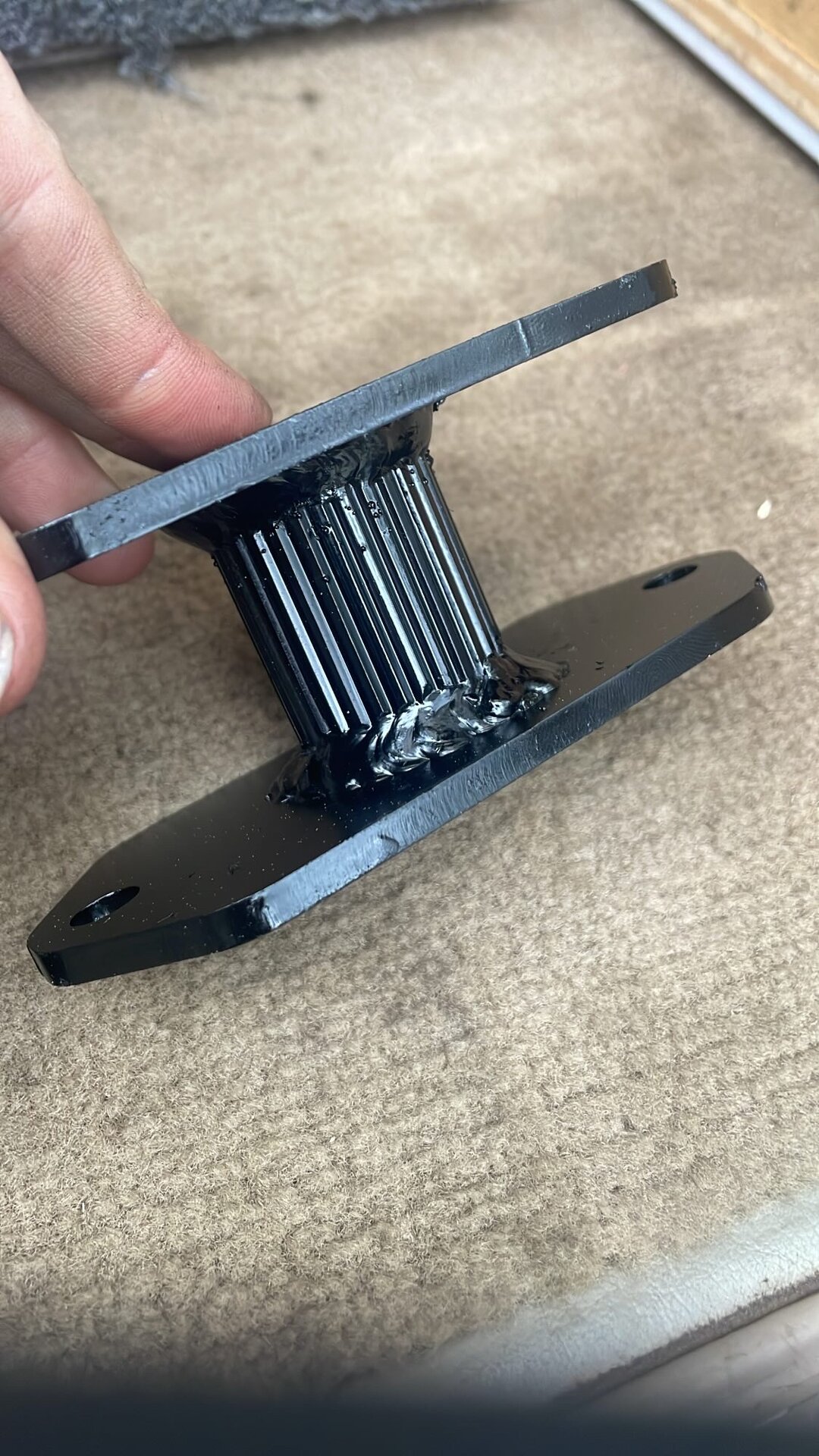

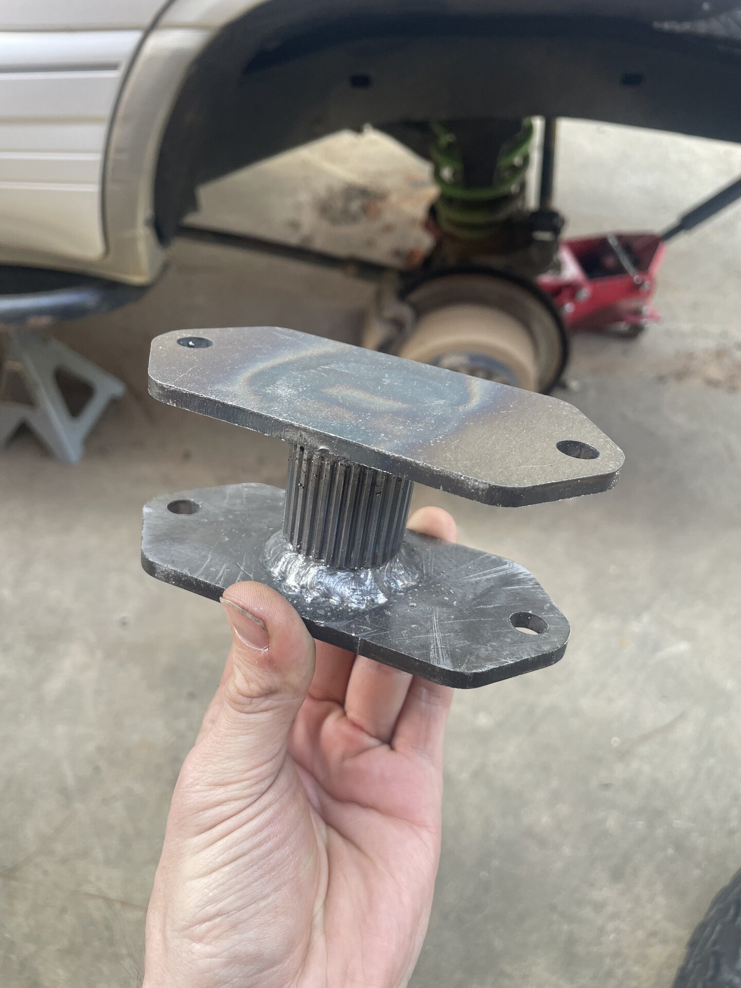

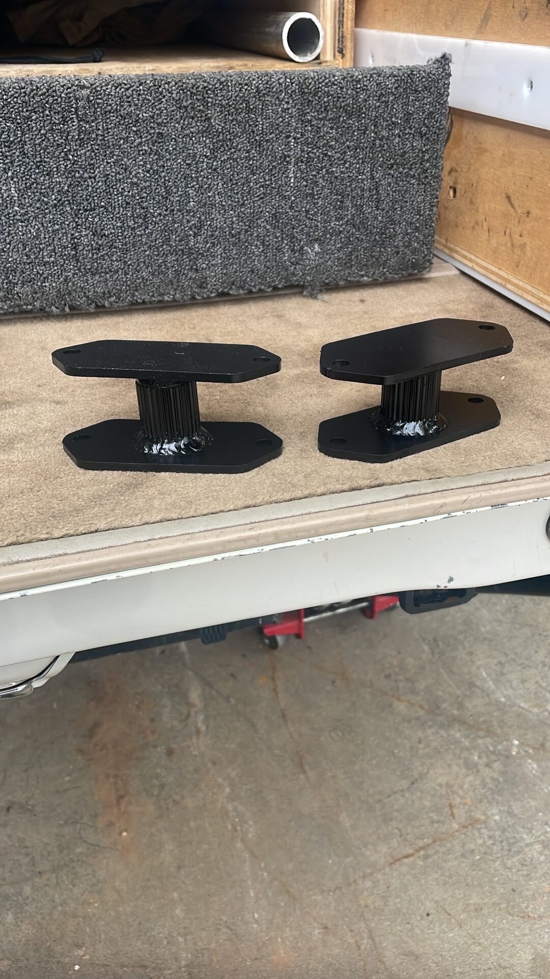

Welded up some 2” rear bumpstop spacers today. Recognize anything?
I see you are planning to increase the down travel but decrease the up travel. Any concerns with the reduced up travel?
I need to do the same. With my 35/12.5s, the tread has scrubbed some of the original undercoating from the rear passenger wheel well.
My only concern is that I’ll be tempted to throw 37s on it 😂
I’m sacrificing about 2.5-3” of uptravel but gaining that plus some extra in downtravel (which for rock crawling is ideal).
Bigger tires require bumpstop spacers (uptravel arrest) anyway, so why not gain some travel that really helps on the trails? That’s my logic anyway

The point is to gain downtravel, not clear tires in my case.
This isn’t a new concept. Im stealing a lot of this from other 100 builds out there

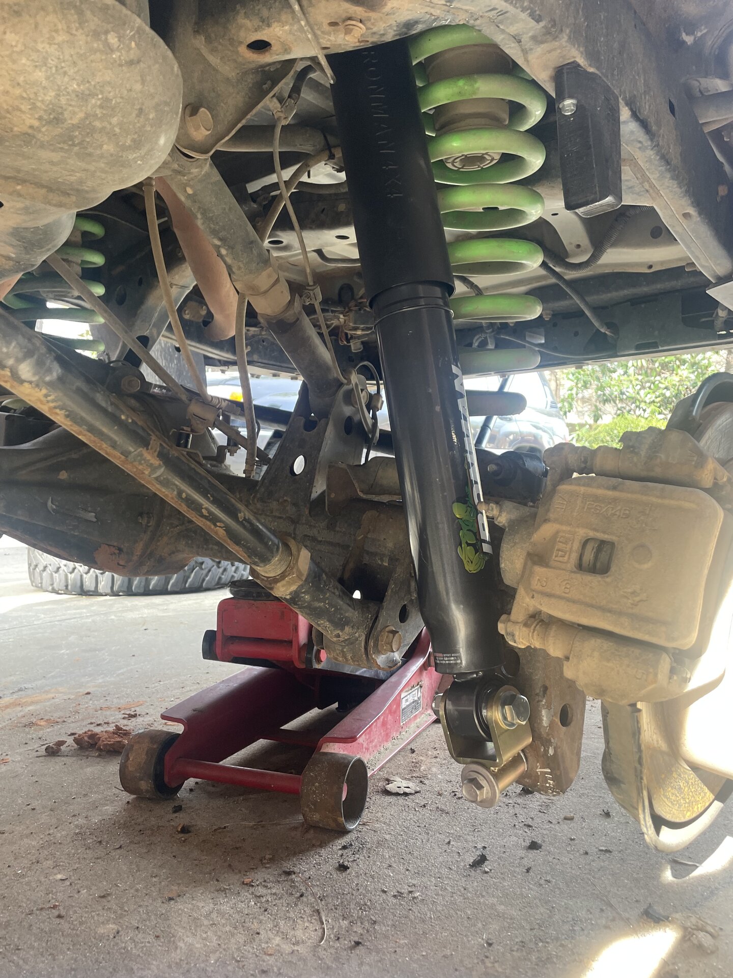

You getting the longer 80 L shocks or other longer shocks for the rear to gain that downtravel?

I thought I mentioned that- probably put that somewhere else. I'm running Ironman's 80 Series shocks for a 4" lift: 45682LFE
Also running AHC spacers from Japan 4x4

Exactly. To run the shock extensions you have to have longer bumpstops, or else you would destroy the shocks by driving them beyond full compression. A body lift won’t help with that.

The 80 series rear shocks are longer and will give you immediate results for more downtravel.

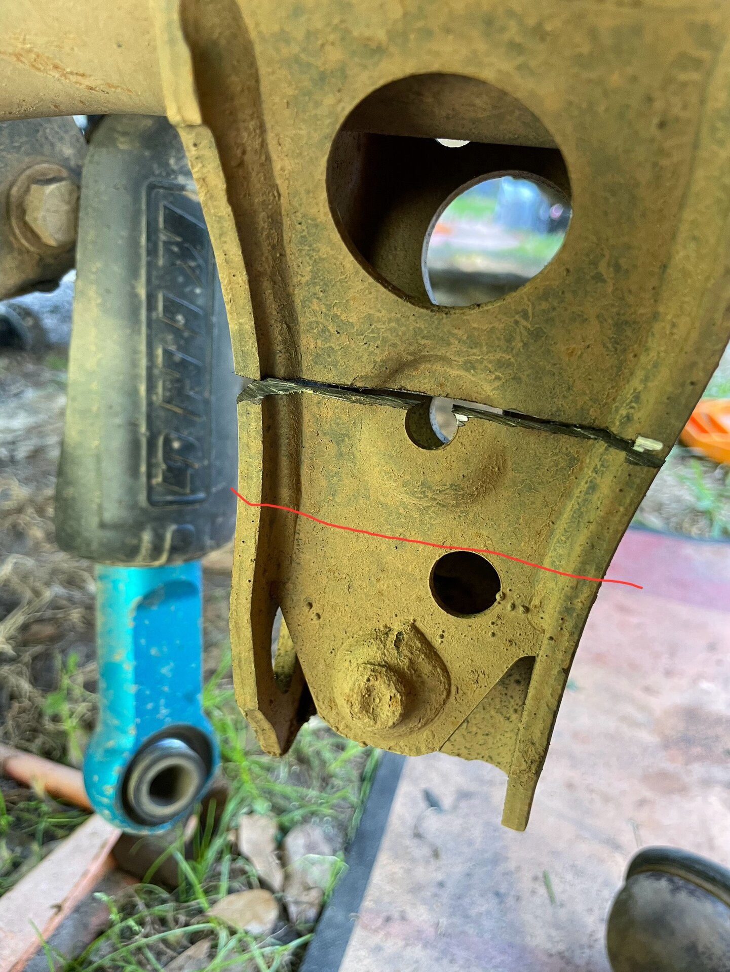

I added the AHC spacers in the rear which accomplish the same thing as doing a “shock mount chop” where you take out about 2” of your shock mounts, then re-weld them back in place. The AHC spacer is the bolt-on version of that mod.
Relocating the shock mount (pushing the ram up in its stroke at ride height) means you’ll need to run bumpstop spacers of the same length so you don’t destroy your shocks. The distance you’ve relocated the shock mount becomes the distance of additional downtravel you’ll have- so with these AHC spacers I saw about 2” of additional downtravel plus the additional downtravel of the 80 series shocks

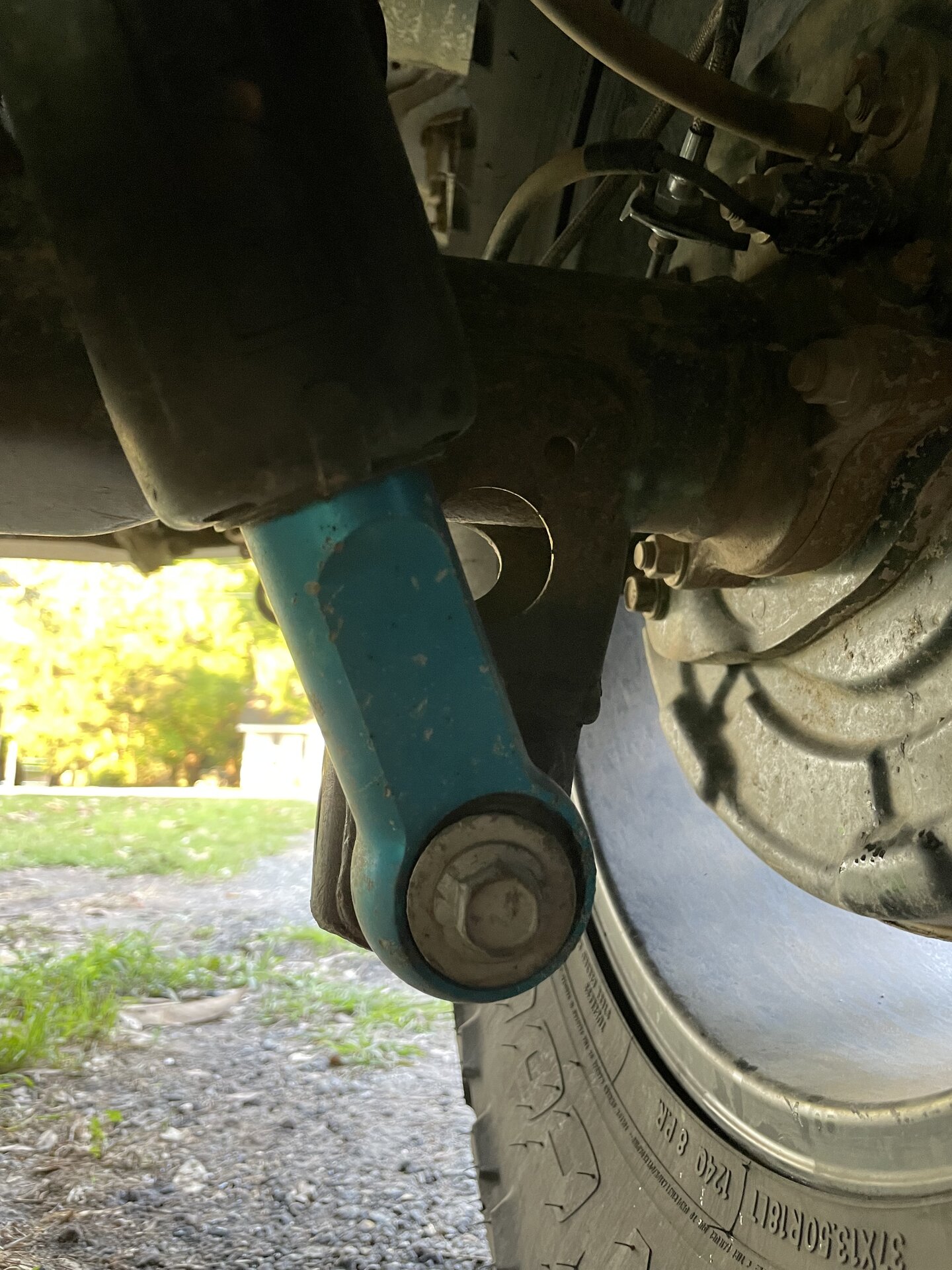

AHC Spacers keep you from having to do this:
img_5788-jpeg.3599374
