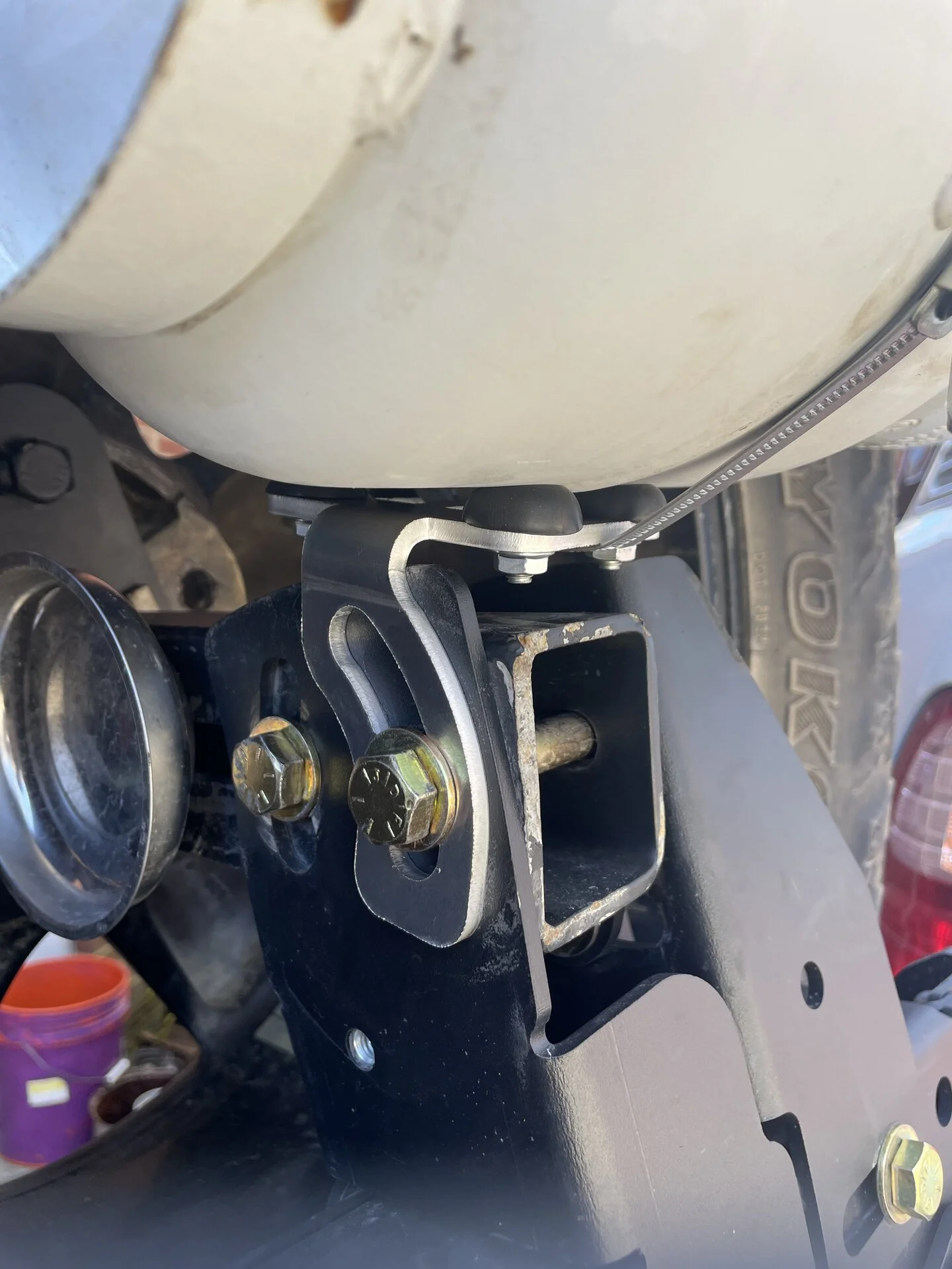

Also designed a propane mount for my dissent rear tire carrier swingout. Hassle free with a quick release clamp for easy fill.
is that a 10#er?
I'm gunning for a 20# tank mount. thinking under the table option on the non-tire side swing out. Reason for the 20#: if heading out for 1+ week in winter (SoCal version), it should run tent heater/fire pit for the duration. happy wife = happy copilot.
