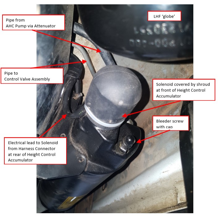

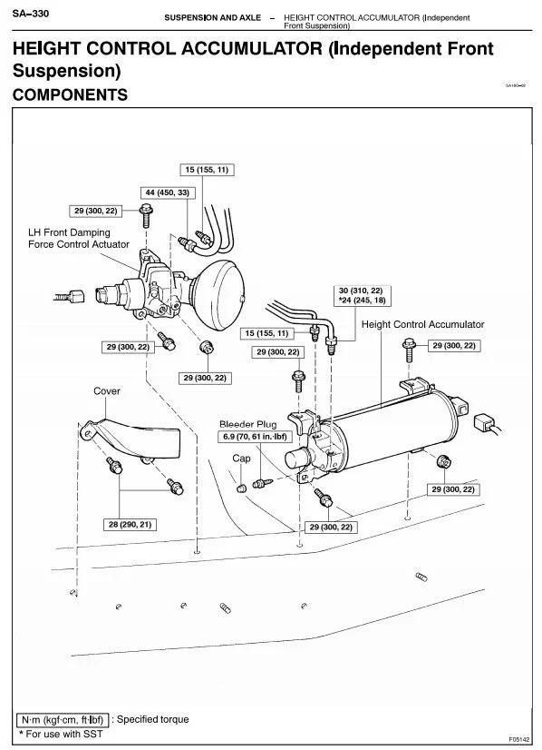

Edited 22nd May 2021: Mistake in pipe labels on pic of Height Control Accumulator noticed by @patchagan , now corrected
There is a lot of detail in these posts because the title of your thread makes it easy for others to find and these problems with the Height Control Accumulator will happen more often as LC100/LX470 vehicles get older -- so the posts may help someone .....
The frozen remnant of the bleeder valve is likely to stay safely in place in the Height Control Accumulator (HCA) for all time unless efforts are made to dislodge it. The AHC system will continue to work just fine so long as the solenoid valve at the front of the HCA works properly when required.
The AHC system still can be bled via the bleeder valves on the Damping Force Control Actuators to which the ‘globes’ are attached. This will not be perfect but it is far better than not bleeding. Given enough discharge/recharge cycles – meaning multiple cycles of lowering and raising the vehicle which causes the AHC fluid in the HCA to empty and refill – then the old fluid eventually will be diluted by new fluid added at the AHC tank and as fluid is cycled out of the HCA and leaves the AHC system via the bleeders at the Actuators.
So unless there are other problems with AHC operation, dealing with the HCA and the broken bleeder is not urgent and can be left on the “when convenient” list.
Some past threads have mentioned repair using an Ezi-out to remove the stuck bleeder valve – the general idea is illustrated in this video but is not specific to the HCA:
The point is that there really is not enough room to do something like this with HCA in situ on the vehicle chassis. Even if it this method was possible, great care would be needed to safely manage the release of any stored hydraulic pressure. For this reason, it would be better and safer to deal with the HCA and the problematic broken bleeder in a workshop after the HCA has been removed carefully and safely from the vehicle.

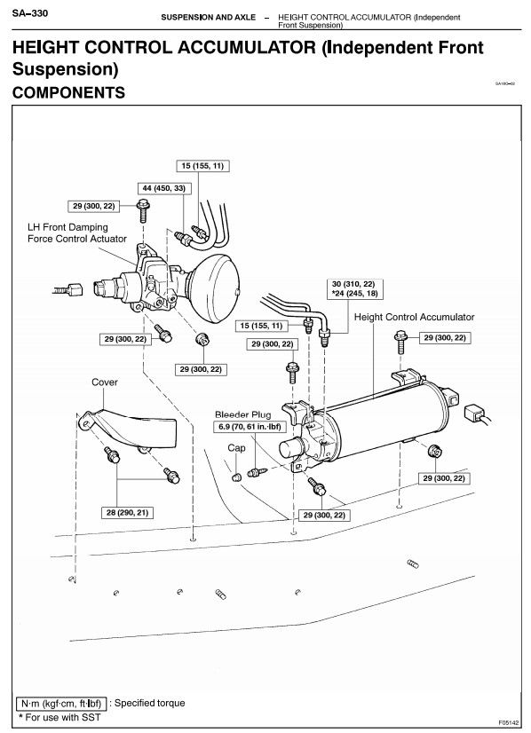

There are two pipes attached to the HCA – one from the AHC Pump to the HCA via the Attenuator, and, one short pipe from the HCA which runs over the top of the chassis rail to the Control Valve Assembly which is mounted on the inner side of the chassis rail.
If the solenoid valve in the HCA is tight internally (meaning not leaky nor faulty) then hydraulic disconnection should not be difficult. It is worth checking the operation of the HCA solenoid valve while it is still in the vehicle as described in previous posts. If the valve is faulty or if the pipes are frozen or weakened with rust, then be prepared to manage a messy discharge during disconnection and take care of personal safety (especially eyes), also as mentioned in the previous posts.
Repair or replacement then can be considered.

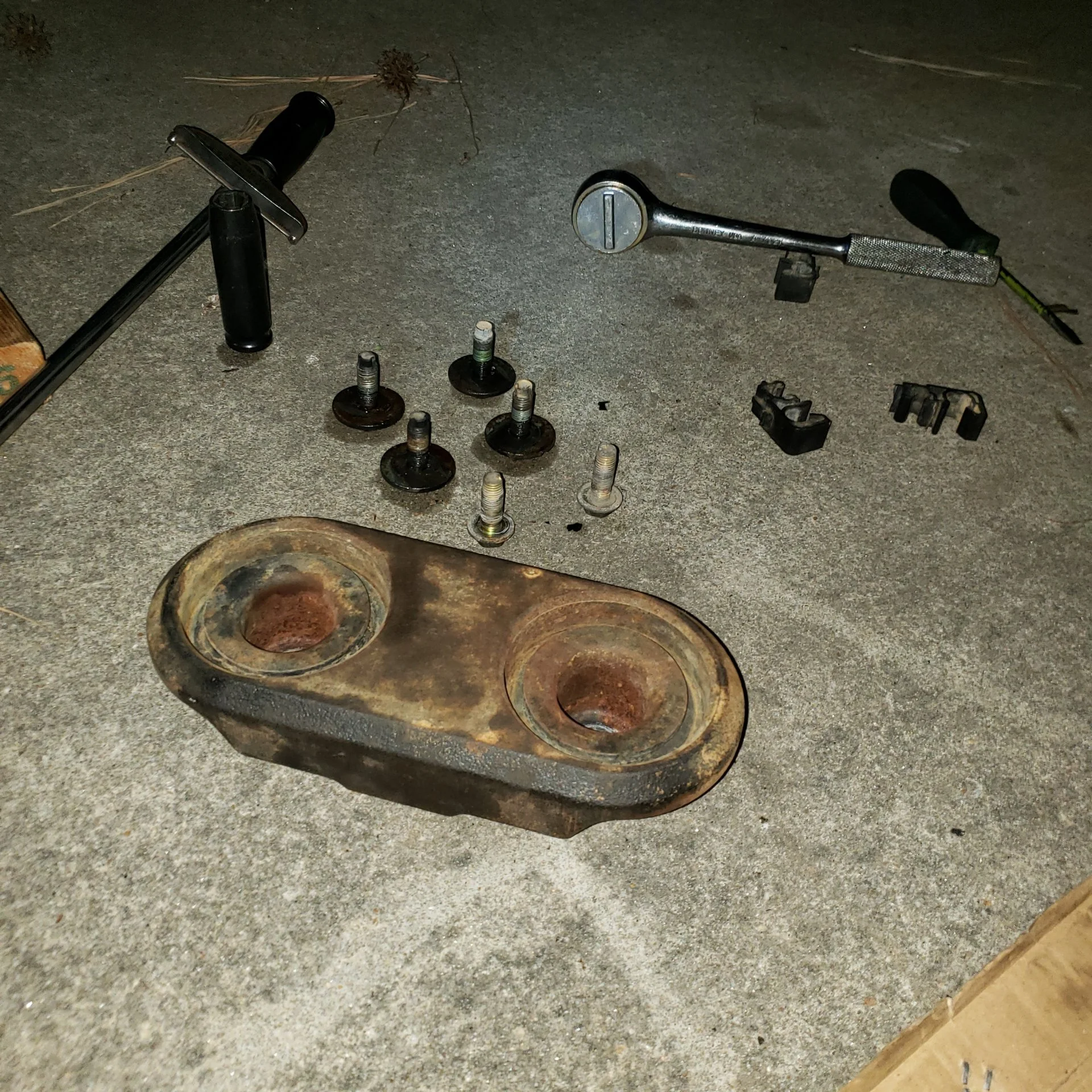

I just rounded the bolt-head on tube No. 2 trying to get it out. I'm not sure how to get it off without cutting it.
Update on some items. Might start a new thread if this interests anyone.
Backstory:
I recently attempted to replace my HCA but Tube No. 2 (Part No. 48982-60042) was extremely stuck in the HCA. I rounded off the plug for Tube No. 2 and wound up having to cut it off. I purchased a new one from Toyota, five bleeder screws and five rubber boots.
I was able to replace the AHC line without even tearing apart the entire truck (I'll try to explain but it took hours of shimmying, trial, and error).
I started by removing the old AHC Tube No. 2, stretching and maneuvering it out starting with the reservoir side (the side running along the frame toward the AHC pump). Once the frame side is able to move and all the plastic clips have been disconnected, it is impossible to get the tube out without removing four bolt that hold the crossmember to the PS frame rail. Once these four bolts are removed, I also removed the counter weight to create more working room. At this point you're able to pull the rest of the tube towards the passenger side from the HCA.
This process took ages and many frustrating moments. Make sure to pay attention to how the tube is routed around the exhaust, transmission, other tubes/lines, cables, etc. Once the old tube is out of the way, reverse the process and put the new part into place. I found that inverting the tube and rotating it 180 degrees a few times (this would have been so much easier with a vehicle lift) helped maneuver it through all the miscellaneous stuff between the frame and body.
This is probably a good time to admit that this may not ever be duplicated by anyone in their right mind. I still don't entirely understand how I was able to put in the new part.
Next steps for me are to remove those rusty bolts holding on the globe and globe housing. Time for a refresh.
This has quickly devolved into a ramble post. Hopefully this can help someone.

The tube labels on your photograph diagram are actually incorrect. The larger (14mm) tube into the HCA is the inlet tube from the AHC pump assembly (runs up the PS frame rail). The smaller (10mm) tube out of the HCA runs to the "control panel" assembly on the Driver's side frame rail.
Thank you @patchagan -- there definitely was a mistake in the labels in my pic of the Height Control Accumulator far above, now "Late Edited" with correct labels at Post #8. Apologies offered to all for any confusion caused.
It is not particularly relevant but there are some differences in pipe routing between LHD and RHD vehicles. The AHC Pump assembly and pipe down to the Attenuator and onwards to the Height Control Accumulator are all on the Left Hand Side in a RHD vehicle, with the pump itself oriented on the forward side of the overall AHC Pump/Motor/Sensors/Tank assembly. This done in the factory build to provide room in front of the RHD driver for the brake master cylinder and its accumulator. Interestingly, the pipe at the pump outlet is the smaller diameter pipe but changes to the larger diameter after the Attenuator and onwards to the Height Control Accumulator.
Interesting about the LHD vs RHD. Thanks for the clarification. I missed the edit apparently.

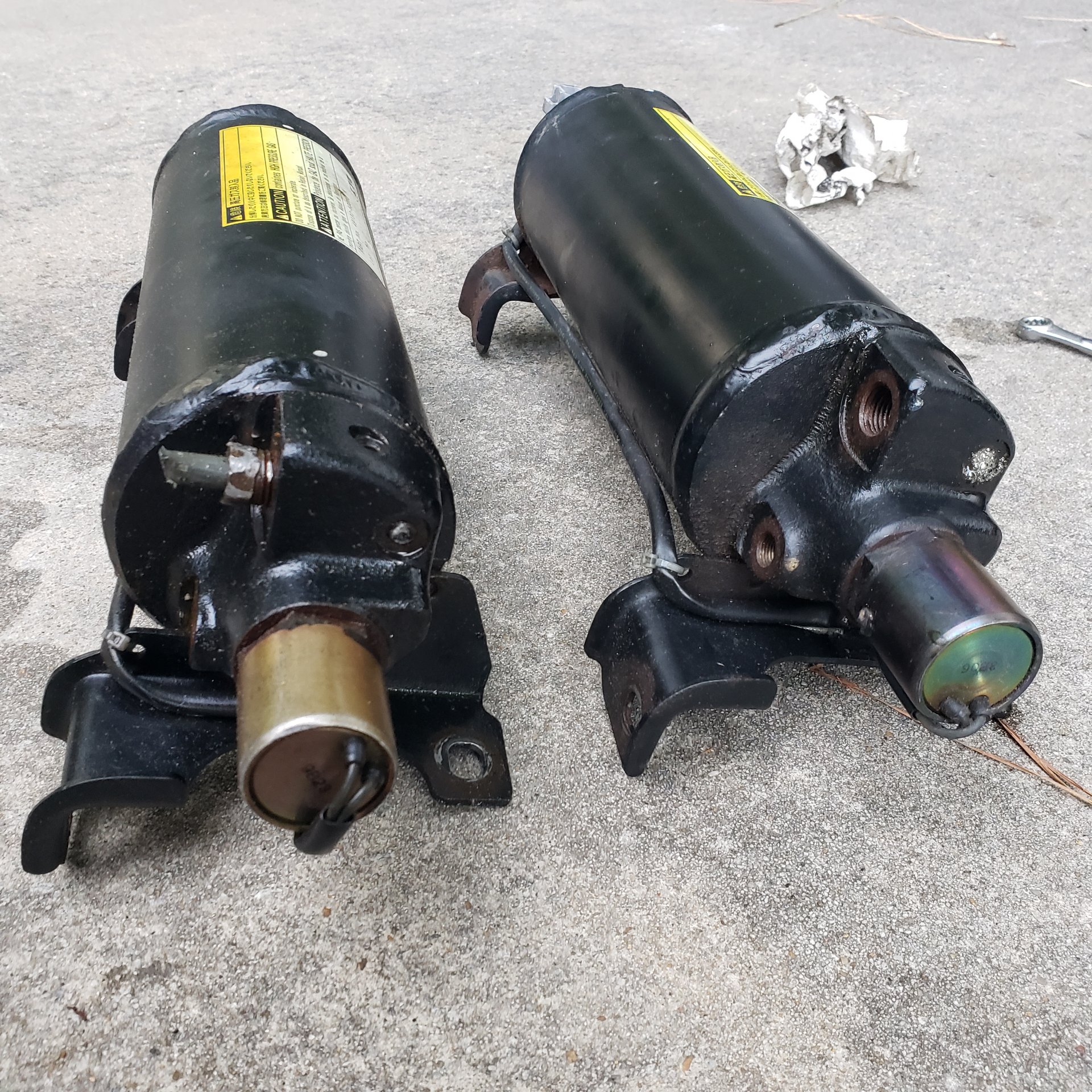

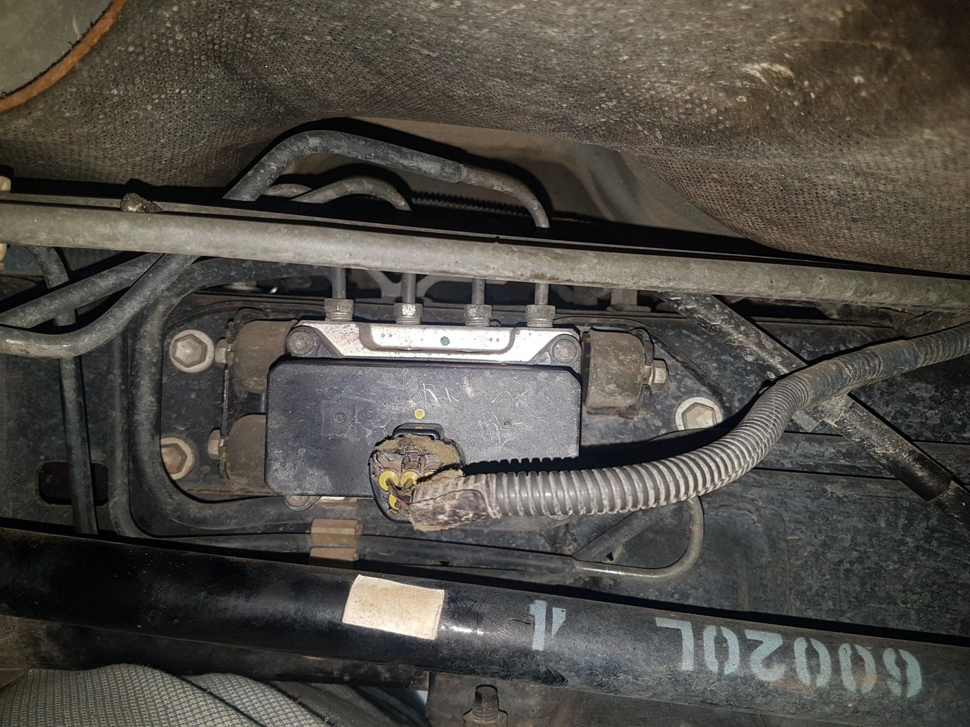

I unfortunately have a broken bleeder on my southern LX 470 (Texas-234K miles) too! I thought about trying to drill out the sheared bleeder stub in situ, but - No Tempo LImit posted earlier is probably correct... drilling out and using an extractor, while on jack stands, lying on your back, and drilling with a hand drill, completely parallel to the stud, is nearly impossible. So...............
I decided to REMOVE the Accumulator.. and what a PITA it is!! Ya'll are right about this procedure.
Ok, so as I'm removing the larger supply tube 14mm, and using a crowfoot, flare wrench, after 2 days soaking in PB Blaster,, then using a MAPP gas torch to heat it, and finally banging ( shock) on the accumulator,.with a BFH....... I managed to get the damn thing loosened & eventually removed. But not without rounding off the sides like (CRUISER PATCH did in a similar post ) The other connection to the Accumulator- 10 mm flare nut I also heated with a torch and soaked in PB blaster, and it came out easily.
Ok, so there's the background ... now my question guys...
There are ( 2 )12 mm bolts ON TOP of the frame rail in addition to the 2 on the side ( which you can easily remove) The fwd one is accessible after removing the pressure globe and the bracket for the running board. HOWEVER... the rear bolt is not accessible on either side of the frame. On the inboard side are 4-5 fluid lines, and on the outboard side, is the accumulator. There is a small gap on the outboard side to move the end of a 12mm wrench, but I don't see how to put the box end over the head of the bolt! This part was installed at the factory BEFORE the body was fixed to the frame ( no thought was given to how to remove those 2 bolts in the future obviously by any mechanic or Ih8MUD groupie like us).
But somehow, several people have removed their accumulators and removed that "hidden " rear bolt.
My question is ..HOW DID YOU DO IT?? is there a special service tool wrench with two 90deg "S-" bends I need to make to reach the head of the 12mm aft bolt on top the frame rail?
I am about to get a Sawzall and just the rear bracket off ( if I can get the blade in the gap between the frame rail ) and simply ignore that 4th top bolt when re-mounting the accumulator

Does anyone know the part number to replace that black rubber/plastic solenoid shroud cover at the end of the height control accumulator?
Backstory:
View attachment 2680773View attachment 2680774
Do you happen to know the part number to replace that black rubber/plastic solenoid shroud cover at the end of the height control accumulator?
