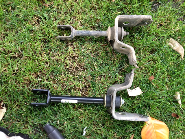

Just installed all the rear sway bar parts. Thought some pictures would be helpful. I agree with above, 3 of 4 sway bar bracket mount bolts broke on my old rusty 100. This one was fine.
Replaced all the rear sway bar bushings with Whiteline Poly bushings. Except for the top 4 sandwiching the bracket.
I ordered Man-A-Fre's 80-Series extended sway bar links and used those with the 80 series bushings but the one 100 series washer (the non gold washer in the pictures).
As you can see the Man-A-Fre links are about an inch longer than OEM.
Assembled OEM vs Man-A-Fre
The Man-A-Fre goes Washer-Bushing-Bracket-Bushing-Washer-Nut. While the OEM 100 one adds another washer: Washer-Bushing-Washer-Bracket-Bushing-Washer-Nut.

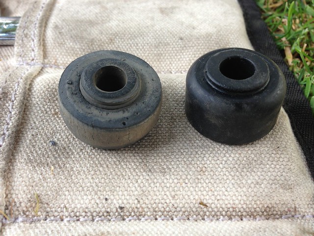

Whiteline on the left. OEM in the center.
80 (left) vs 100 (right) Bushings
They seemed similar enough to me that I stuck with the 80 ones.
For anyone who needs to know, the torque spec's are as follows:
FRONT:
-Stabilizer bar links
-bolt (through stabilizer bar link and mount): 38ft lbf
-nut (on top of assembly): 18ft lbf
-Stabilizer bar brackets (mount to frame) : ft lbf
REAR:
-Bracket bolts: 13 ft lbf
-bolt (through stabilizer bar link & stabilizer bar): 19ft lbf
-nut (on top of assembly): 11 ft lbf
-stabilizer bar brackets: 13ft lbf
