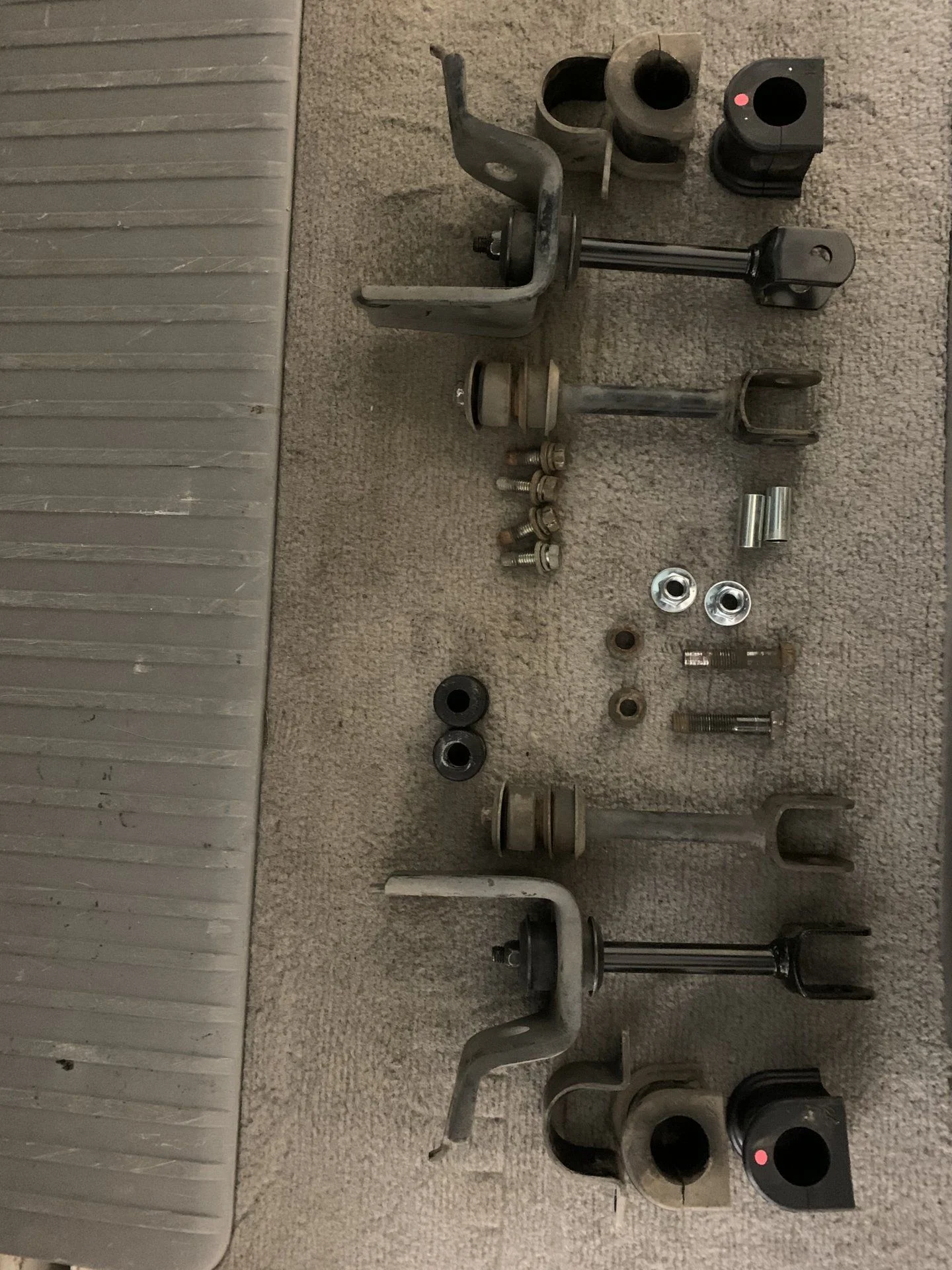

Just got my rear sway bar parts.
Does anyone know if I have to put in the rubber bushing into sway bar first and the the metal spacer? Or put the spacer into the bushing then press it into sway bar.
This is for rear.
Thanks

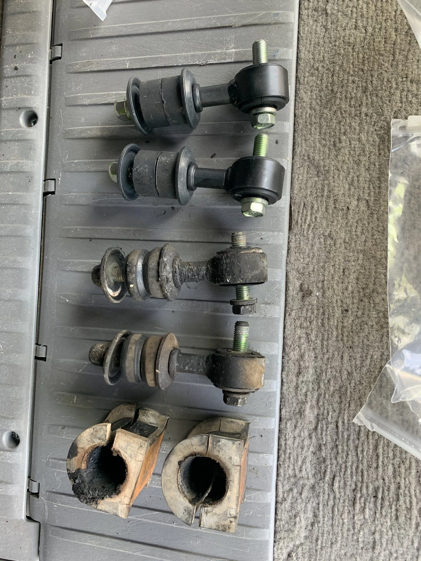

Did the front and rear anti sway bar end links and bushings this weekend using 6 inch ramps and my driveway (and an fm radio).
Now this 2006 lc drives better when cornering and seems to track a new one. Old bushings werent as bad as imagined as the vehicle has 195k odo but I wanted to get this done before a 200,000 mile timing belt/ water pump job. And its done...

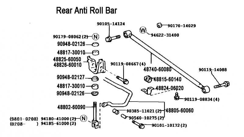

Rear:
Sway Bar Bushings
qty 2x
48815-60140 AHC equipped= 48815-26250
Sway Bar Links
qty 2x
48802-60090
Link Stablizer Cushion
qty 4x
48817-30010
Link retainer Cush 1
qty 4x
90948-02126
Link Retainer Cush 2
qty 2x
90948-02127
Sway Bar Bush
qty 2x
90385-11021
Sway Bar Spacer
qty 2x
90560-10275
Link Retainer Nut
qty 2x
90179-08062
Sway Bar Lock Nut
qty 2x
94180-41000
optional
Sway bar Bracket LH
qty 1x
48825-60050
Sway bar Bracket RH
qty 1x
48826-60010
Sway Bar Bush Brackets
qty 2x
48824-06020
Sway Bush Bracket Bolts
qty 4x
90119-08834
Sway Bar Bolt
qty 2x
90101-10172
