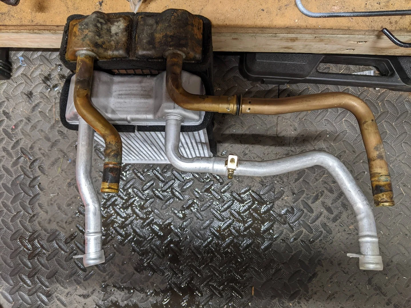

Mine vs a new one (FOUR SEASONS 92413), but afair, a pre 11/96 heater core. The pipe on the right is way off on the new one, and the left pipe is slightly off and probably doesn't line up with the firewall grommet.

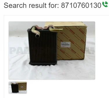

I think I have the early version: 8710760130. Picture from PartSouq. Extension Tube: 8724860430
Both appear to be not available.
Looks like you need the new style with pipes not connected.

Off point here, but, can you verify that the aftermarket unit there is aluminum, not just sprayed silver for some reason?
Never mind. Followed your link and it is indeed AL.
It is lighter compared to the original and silver inside the tubes.
