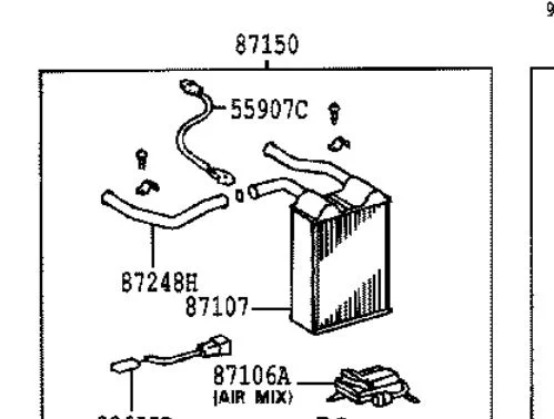

Is anyone familiar with the differences between the front heater core from pre 8/96 and post 8/96?
They are different part numbers and the pre 8/96 version is no longer available (as far as I can find).
Is the post 8/96 version usable in a pre 8/96 cruiser?

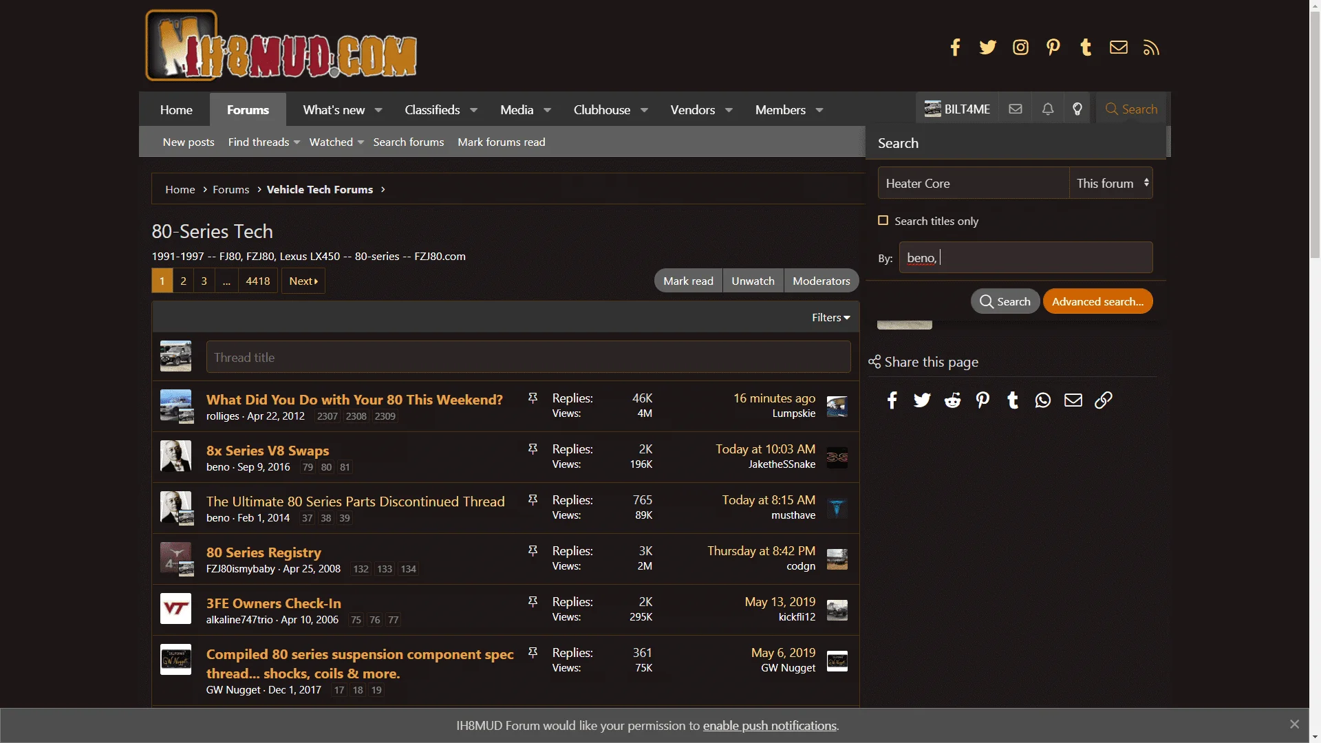

Do a search (upper RH corner) and search for : Heater Core from Member beno. You will get all the info you need.

I see Beto’s response there, but in that case the owner was using an aftermarket core from what I can tell. There are other strings that say that the air box has to be swapped for a post 8/96. So conflicting info.
I was hoping someone with firsthand knowledge of putting a factory post 8/96 heater core in a pre 8/96 cruiser.

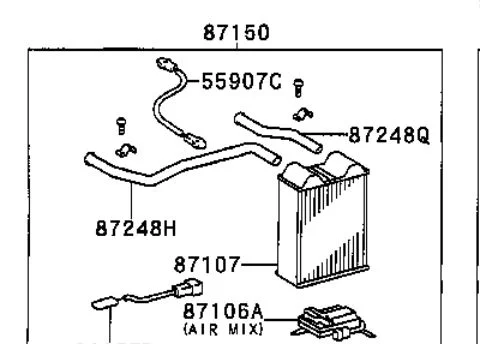

Bumping this old thread. I'm actually planning a dash replacement on my 80. I've slowly overhauled all the vitals on my rig, but I'm more than likely running the OG heater core. I figured this would be a good while you're in there item.
Anyone know if the pipes that are mentioned are needed when replacing the heater core with the one (87107-60270) that's still available? Any other solutions?

Just to be clear though the pipes mentioned in the thread above that are NLA, what does one do if they need to replace those?
The pipes are discontinued.
Replace them. They're just pipes. the engine side may have beads on them, I can't remember offhand. Anyone can roll a bead on a tube.
