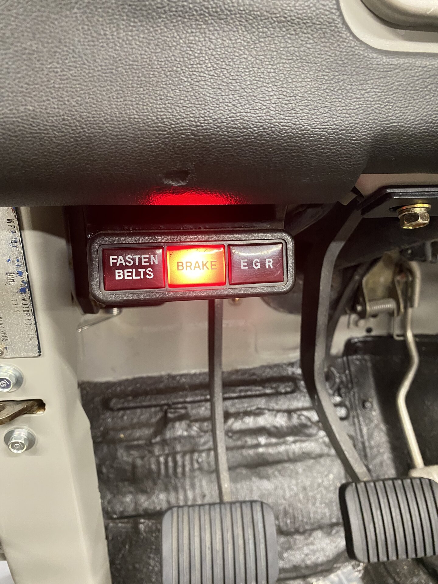

As I wrap up my Parking Brake rebuild on my 75 FJ40, I am trying to figure out the Parking Brake Switch circuit. The switch works fine. I have it operating correctly (based on my multimeter) when the brake is set and released. The problem is with the ignition on and the brake set, the brake warning light does not illuminate. Since the wires enter the wiring harness and disappear I don't know how to troubleshoot this further. I did run a bypass jumper to ensure it is not the switch and I know the bulb works.

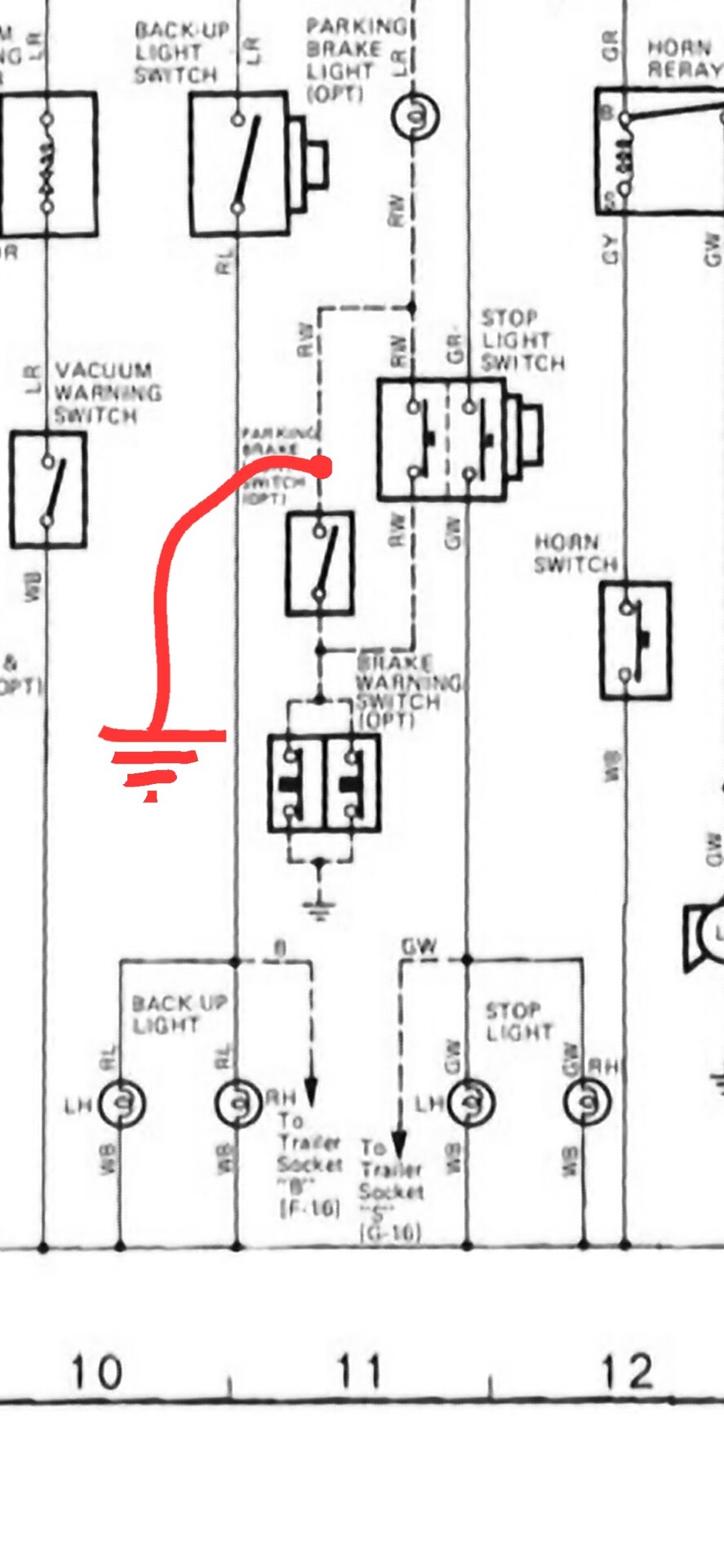

Be sure your parking brake circuit is completing the ground at the brake master cylinder, item #34 on the wiring diagram in post #4 above. For help see post #19 < click here > in this thread.
note: Post #11 in that same thread, Matt posted the Toyota Manual's diagram as well.

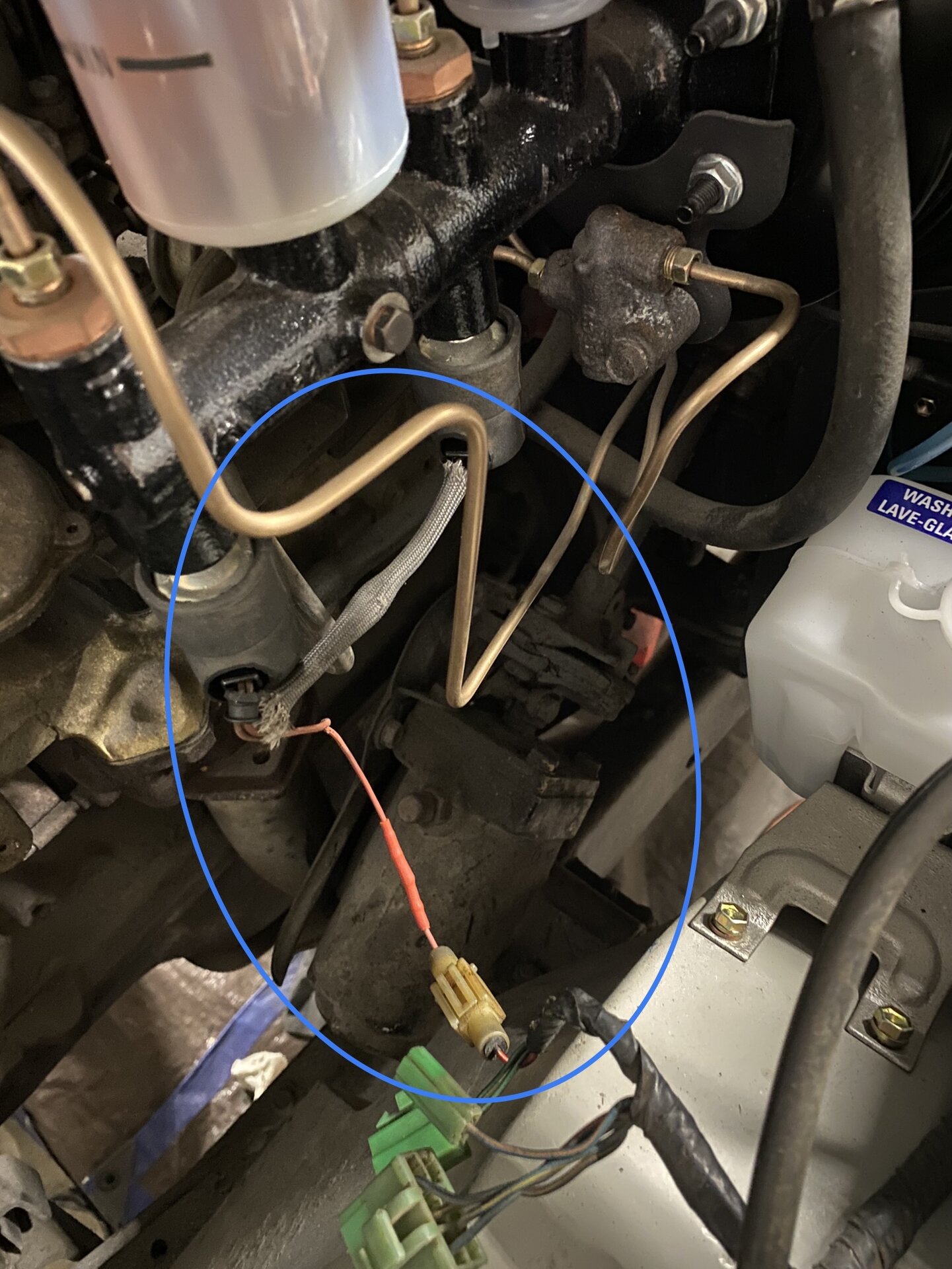

I just went through this exact same scenario on my ‘75 Fj40. I confirmed all brake light switches and bulbs were good but still had no dash brake light signal come on with the key turned on when the brake handle was pulled. After some frustrating troubleshooting and some thorough Mud searches, the problem turned out to be the short wire/plug section that connects from the main wire harness to the 2 sensors on the brake master cylinder. The wire under the sheath was badly corroded and not allowing enough electricity to pass through the master cylinder sensors to complete the brake system circuit (just an educated guess). Not sure if I’m using all the right technical terms, but hopefully you get what I’m saying. After replacing that section of wire from the main harness to the brake master sensors the dash brake light all illuminated like they are supposed to. Hopefully it is an easy fix like this to get your brake monitoring light to work properly.

Grounding the Red/White makes it light.
Grounding the master cylinder switch makes it light.
Bypassing the e-brake switch with a jumper has no effect on the light.
Attaching the switch to the Red/White I tested above and grounding the other side of the switch lights the light unless I push the switch and then it goes out. So the switch works.
I will trace the "return" ground wire and see if there is a break. Otherwise I could just run it to a new ground.
So if I understand correctly; if you ground either of the two wires at the master cylinder while the handbrake is applied, then the light comes on - that's good because it shows that everything is working except the last stage. .
That sounds like you have either a bad connection to both master cylinder switches, or from the MC body to ground, or they're stuck open, or you have residual pressure in your brake lines holding those pressure switches open.
Test the continuity of each of those pressure switches with the foot brake on and off a few times. They should be open circuit while the foot brake is applied, and closed circuit when the foot brake is released.
