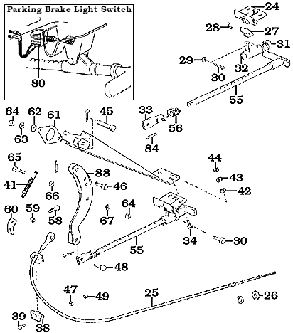

Hello all. After seeing @GA Architect s post. I was empowered to get my own working. Everything is hooked up. But I can’t see where the switch that is actuated by the parking break is located. It’s just hanging. Does anyone have a picture of the location? I can’t find a picture in my manuals. Thank you all for any help..
!! Oh ya!! Sorry folks! It’s an April of 77 fj40.
How about a shout-out to SOR ( click here ).....see pick below
It screws into the back of the bracket that attaches the parking brake assembly to the lower dash. And if you need actual photos, I can take some this afternoon.
That’s interesting.. I saw that spot but didn’t see why it Would work .. but seeing it exploded.. I’ll do some poking around!!
Note, once you find the location and screw the switch in, there is a fine line of working depth. Screw it in too far and the brake won't release, not screw it in enough and it wont activate the switch. Thus is the reason for the extra nut on the switch's threads, to lock in place once you find the working depth.

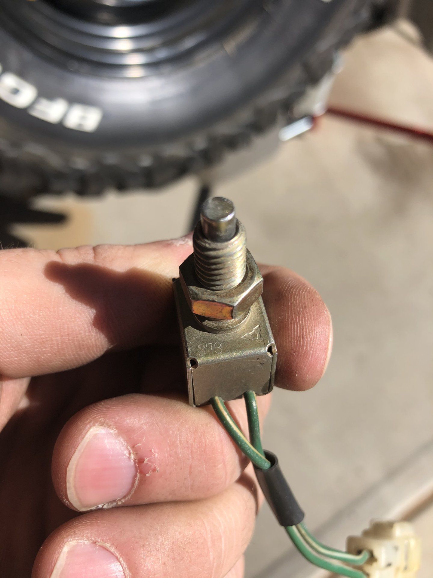

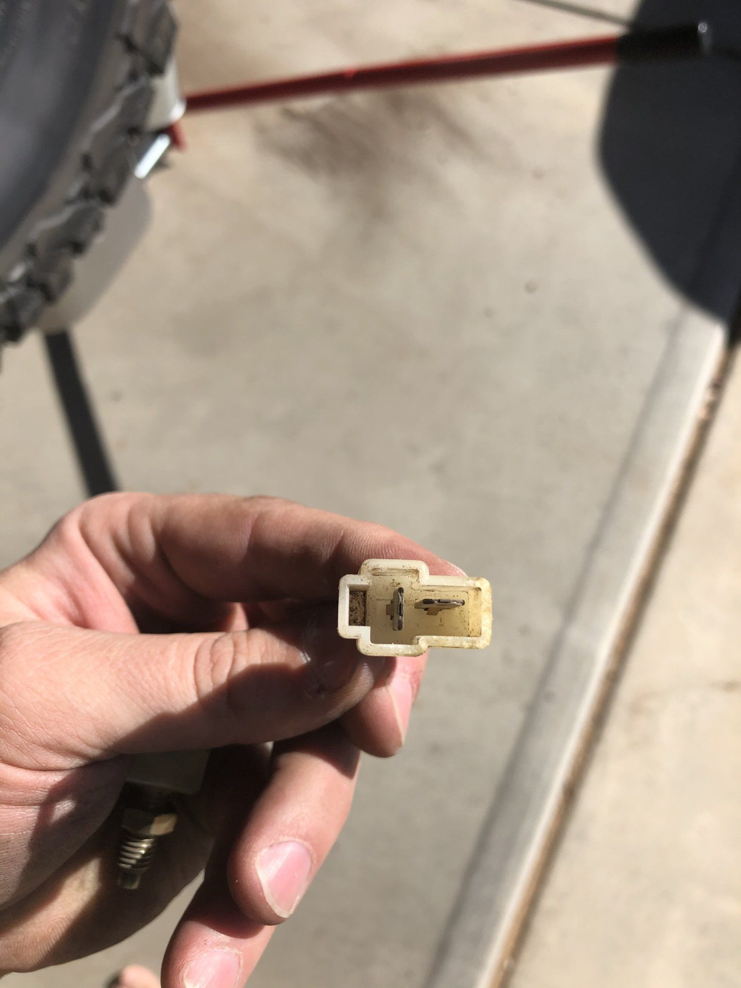

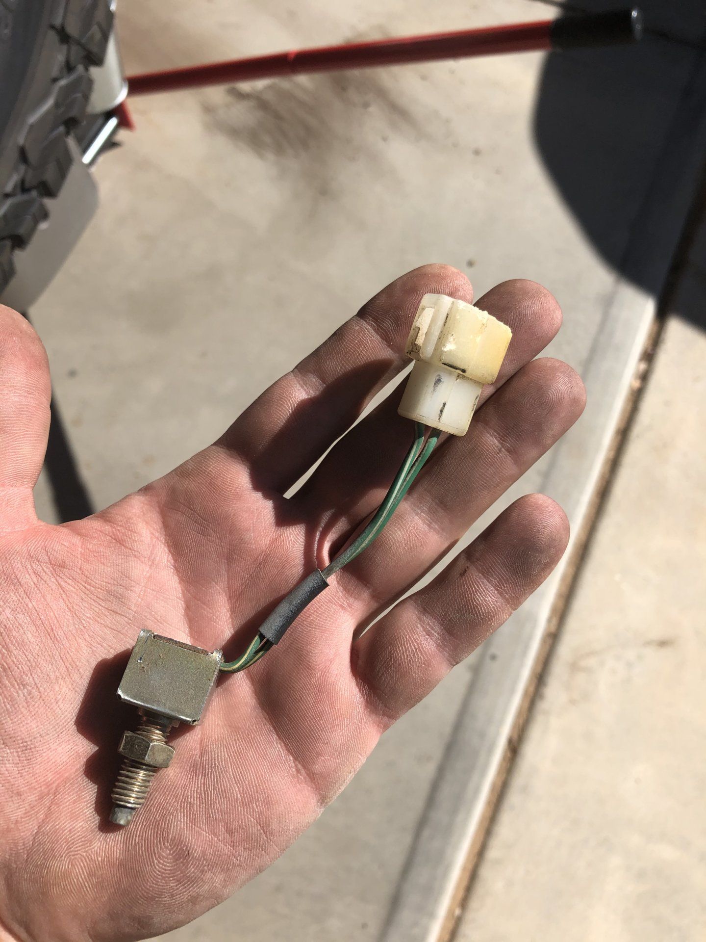

Here are some pics.
Note, the ground for the parking brake is/are attached to the brake warning switch under the brake master cylinder.
