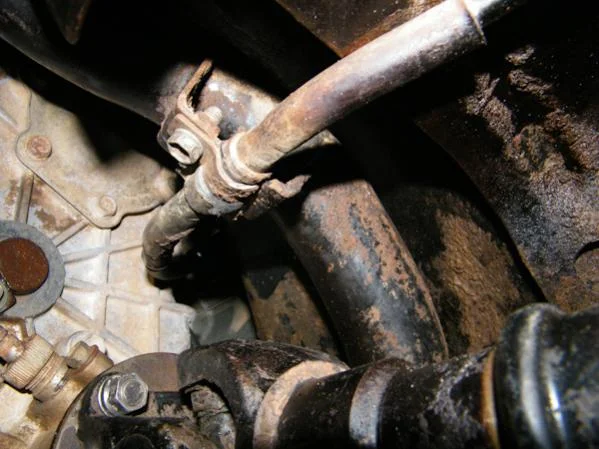

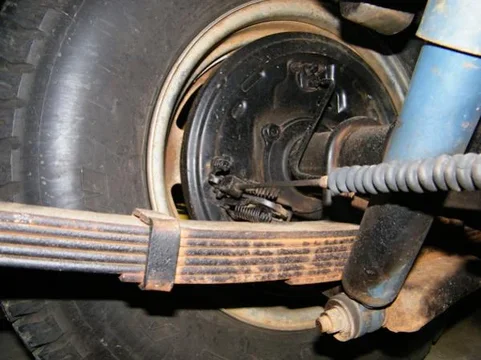

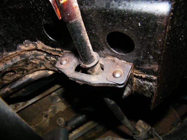

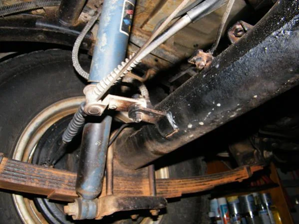

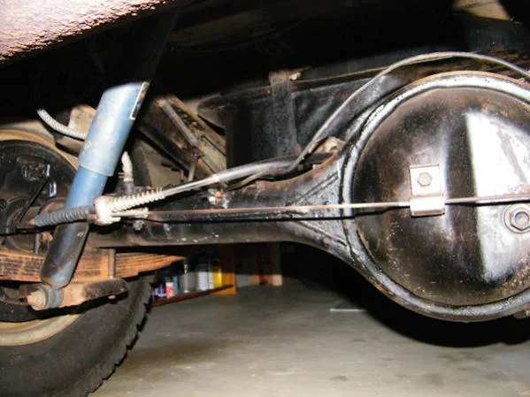

Hey Mark,
Here we go, if it looks back-to-front just view them with a mirror - you all drive on the wrong side of the road over there

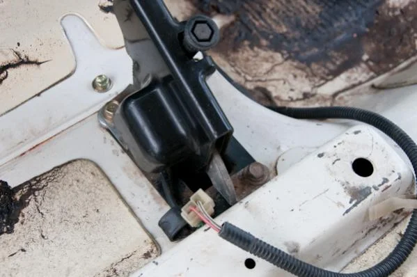

Running from front to back...more pics in the next post

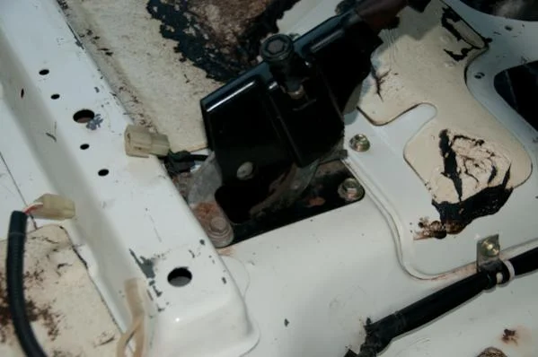

From the underside of the bracket that bolts into the floor

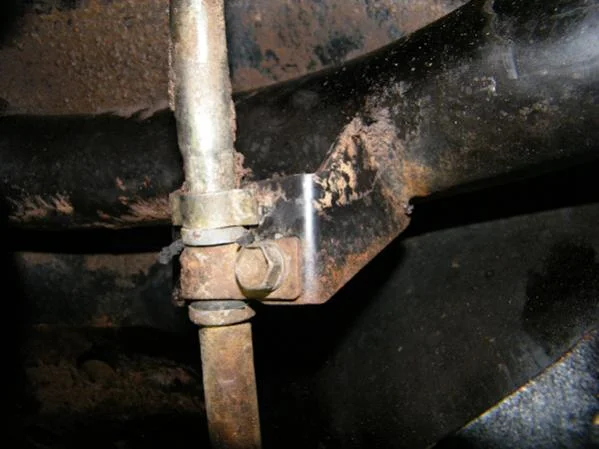

Fits to the bracket on the cross-member just behind the gearbox

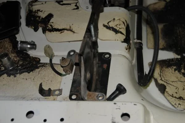

Another bracket fits to a cross member
Bracket on side of fuel tank

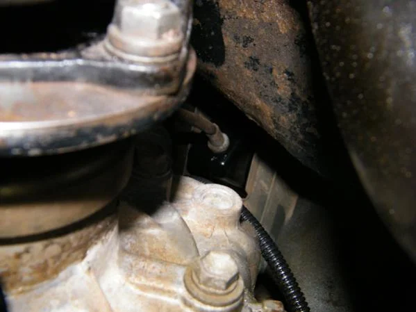

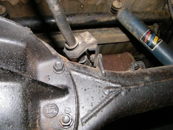

And then to the top of the rear diff (looking from front to back)

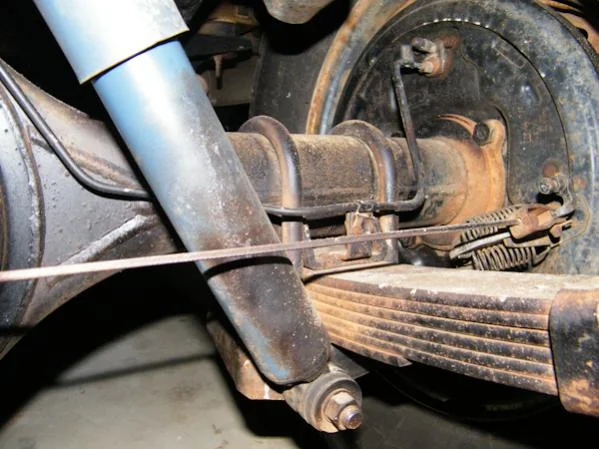

Behind the rear diff, you'll see the cable "splits", with the one end going to the left wheel, and another to the right wheel. Also note the guide which bolts to the rear of the diff housing

THANKS!!!!
I have it attached to the drums abs the "back" of the axle. Now I see how it attaches to the to of the axle, the cross members and the fuel tank (I'll have to do something different there as this is a 78 and earlier Aqualu tub.

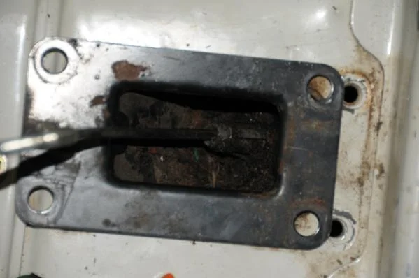

I'd like to see better how the cable goes up to the floor lever and where the lever is from the top side too...
THANKS!!!
Mark I Have a tub and frame from a 82. It still have the springs and rear axle attached. The cable is loose but I'll bet all the attachment points are still there. The cable is still attached to the axle. It attaches on the other side of the diff on LHD. Could get some pictures tonight.
