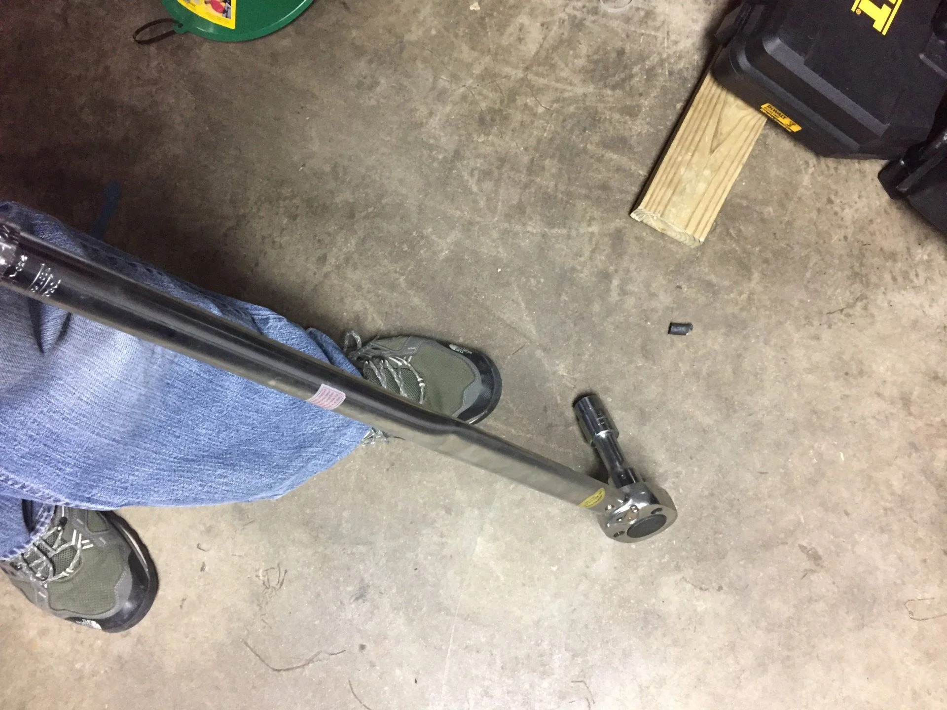

How do one even get to 181???
With one of these:
Ah yes, the ol' white knuckle slammer
