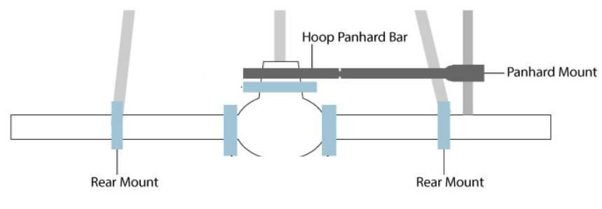

Here's a couple old posts, one with a picture that might help explain. More people with larger lifts should get the panhard drop correction. Much like UCAs for lifts over 2" on the front end, the drop bracket would be that correction for the rear axle.
This is helpful. I'm realizing your lift is pretty aggressive. I do believe your latest issues are attributable to the 20mm spacers you installed, as that puts you way up there at 24" wheel center to hub, which is roughly a 3"+ lift.
The panhard will pull the rear axle towards the driver side of the centerline notably at that height. Additionally because of the displacement, the trailing arm geometry will change the thrust angle again towards driver (as we can see in the alignment). The rear axle is putting power down offset of center, and is thrusting towards driver causing the overall vehicle to pull to the right. Combine that with aggressive offsets, and I can understand why.
@linuxgod is on the right path with recommending an aftermarket panhard to re-center the rear axle. Toe steer will still be an issue when the suspension cycles, but at least in steady state ahead, should really help with the pull.
It's an interesting idea, and maybe I can help answer why. It might be hard to picture, so I'll try my best with the notional picture below.
The adjustable panhard isn't just about centering the tires, but moreso to center the axle. Reason being when the axle is displaced to one side, the trailing arms are not even (gray arms at an angle that locate the axle front to rear). One is at a steeper angle relative to the other. Which means that one side of the axle is pulled further forward than the other. This creates a thrust angle that is no longer square with the car.
Re-centering the axle can reduce pull on even roads. But it won't necessarily improve toe steer when the suspension cycles due to the steeper panhard bar angle.

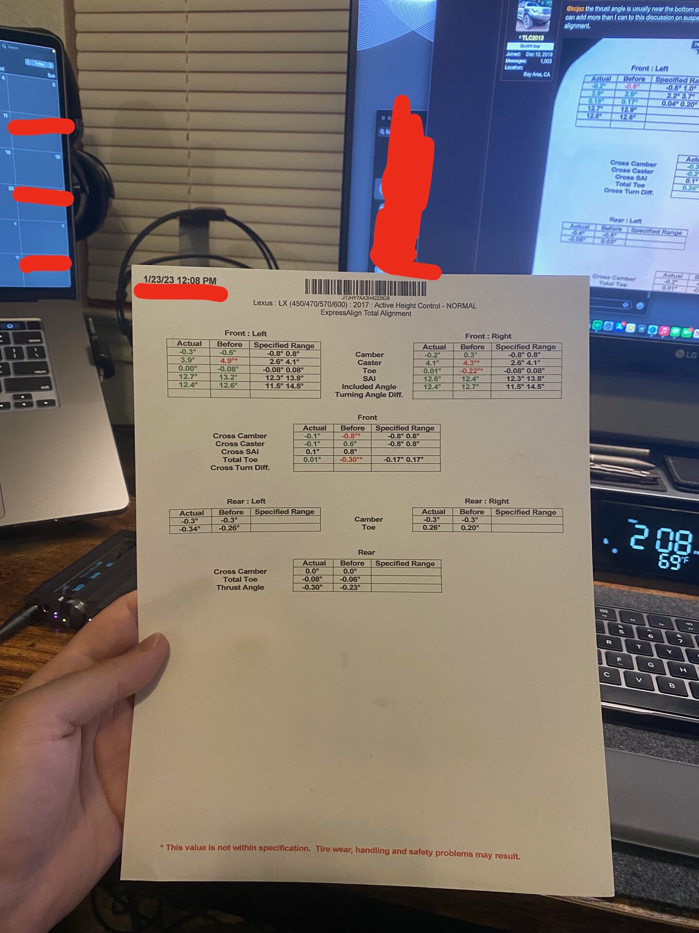

@kcjaz the thrust angle is usually near the bottom of the alignment print out. I think you hit all the points of it. Higher lift results in increased angle. @TeCKis300 he can add more than I can to this discussion on suspension geometry and thrust angles. I have no idea why the “before” and “actual” number changes with an alignment.
Problem is thrust angle cannot be reliable measured in the LX because the rear will dump when off. I have another visit this wed and need to seriously bribe some guys to do multiple rollbacks with the truck running somehow. They have a true 4 wheel ramp with floating rear pads too. And will even let me in the bay to play with my panhard (giggity).
Got everything as neutral as possible like i asked, and im aiming for 4+ caster on both, but there is something wrong with my driver side...
Frame warp, welds, something. And its not weighted down because I'm not siting in it.
Also look how the rear "toe" changed for no reason.
There was another poster who mentioned their front left never wearing right i think in my bitch thread too? I seem to have the same issue.
Its the first wheel to always want to break traction and ABS first.

Thrust angle is impacted and why i have adjustable bar back there. Not because youre wrong, but because its skewed relative to the front.
The panhard will pull the rear axle out of square by the nature of its swing against the fixed 4 link, creating tension at the pinion.
Its just a side effect of the amount of articulation back there, not a design flaw.
Thats what solved my driveline wobble in that laborious thread i made.

Those are some good numbers but yeah that rear toe reading seems abnormal. I always try and shoot for a fraction more caster on the passenger side to account for road crown. That is interesting how your thrust angle is at -.30. I do wonder how the system measures the "before" and "actual". I have seen my thrust angle fluctuate from -.15 all the way to -.30 once the alignment was completed. It has got to be a system anomaly as once the tech completes the alignment they hardly ever take the time to put the truck back on the rack to double check their numbers. The next alignment I got after seeing the -.30 thrust angle only registered -.15 degrees
Good numbers... yeah I hope!
Took me 4 attempts though to finally find 1) a brand new top of the line hunter rack 2) a tech that gave a s***.
