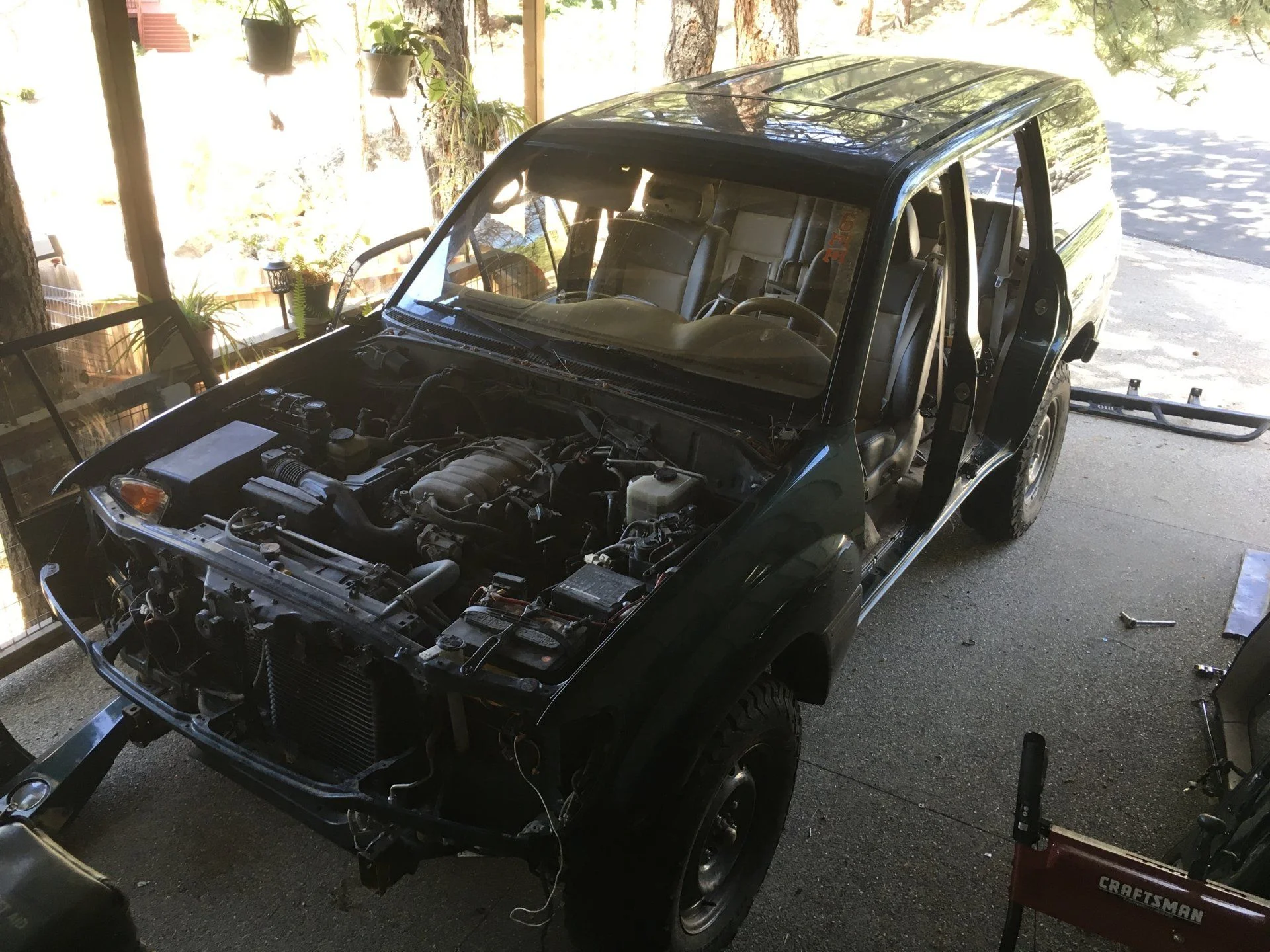

I am finally making time for this. Been wanting to paint this thing for a few years now. I originally planned to use quicksand but changed my mind to the new Toyota color Calvary blue. Not the bright, deep blue they are using, it’s the soft earthy blue on the Tacoma and 4 runner. I know, I know, some of you green lovers will think I’m crazy to color change. I’m not crazy though, HIH is only a couple weeks away, I got this ;) it’s the perfect time to strip a vehicle down to do a complete color change, no problem. No, seriously though, I am an idiot. But it will be cool when it’s done.
FYI, I am an auto body guy, I have restored many classic VW’s throughout my life. So, I know how to do this stuff. The best part is that this paint job will end up costing me about $600 max :) and that’s PPG paint, not cheap junk.
I will have daily updates and detailed photos though the week. :popcorn:
Step 1, strip all the parts off the vehicle so that I can access all the jambs for paint. Need to get all the jambs painted so that they can dry well enough to mask on the new paint. Then work on the bodywork while paint is drying. Shoot the roof during this period of time too, it will be white.
