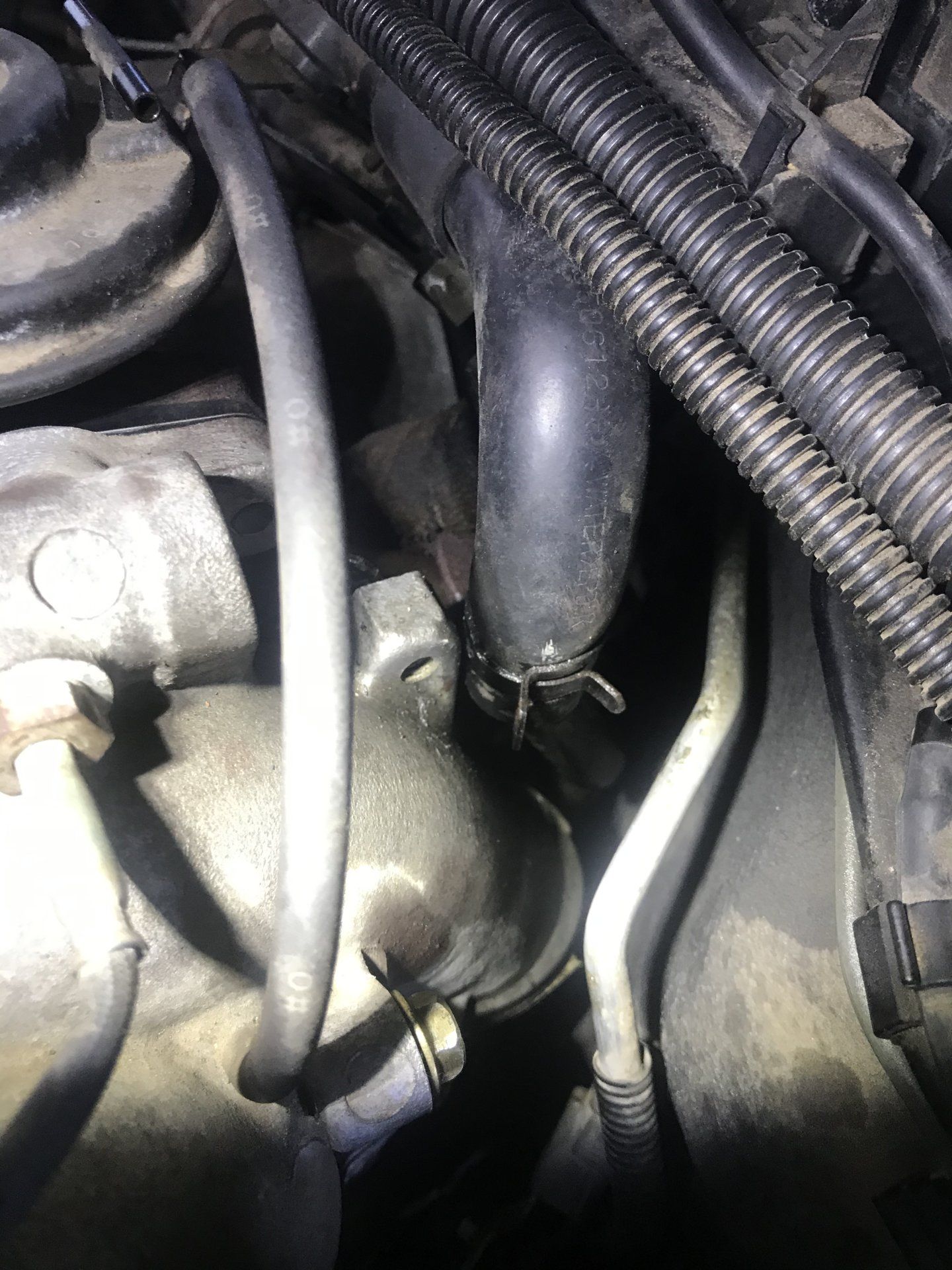

Is there a trick for getting the TB cooling hose off? it's up underneath the intake manifold. I can barely touch it, let alone get pliers on the hose clamp to remove the hose clamp and pull the hose off.

Do a search for "bypass hose #1" and you'll find an answer.

- get to the TB bypass hose through the wheel well
