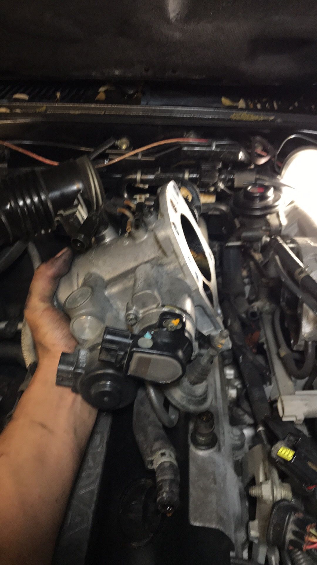

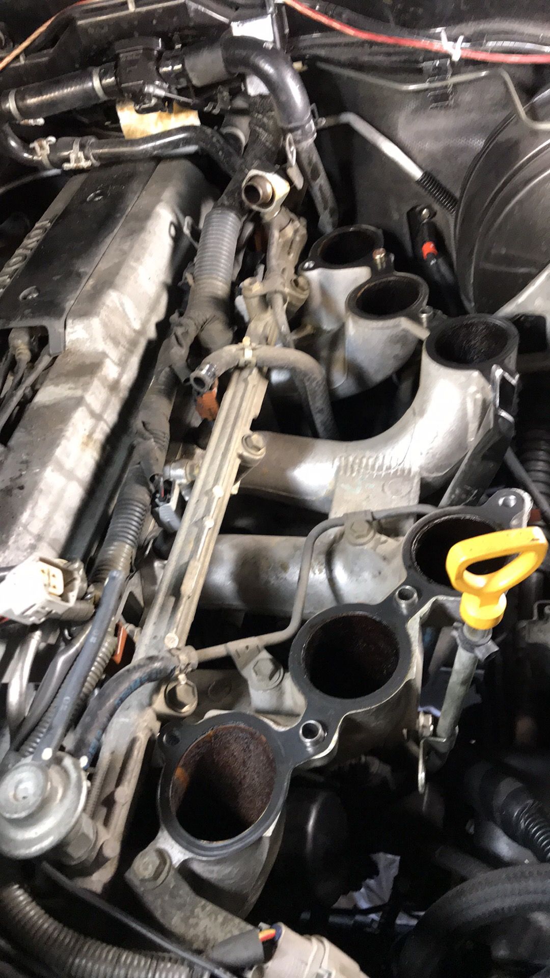

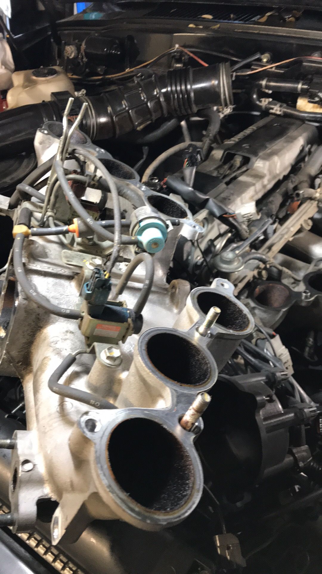

Over the weekend I attempted to tackle my P0401 on my 97 LX450 with 285k, as my inspection/registration is about to expire. I'd replaced the EGR vacuum modulator a couple weeks ago because it didn't pass the test, but that didn't stop P0401 from coming back. I ordered all the gaskets, EGR VSV, some 5/32 and 5/16 vac hose, and dove in.
Removed TB and cleaned, removed upper intake and cleaned out the port (didn't seem to be clogged), replaced EGR VSV and all the little hoses underneath the intake. I left the EGR valve in place because I couldn't get a good grip/leverage on the large nut so I removed the studs and was able to get the upper intake off that way. Put everything back together with new gaskets and hoses where I could.
Started the truck up and was relieved that everything felt and drove the same as before. This was my biggest undertaking on the LX so far and it took me about 8 hours total over Saturday and Sunday. Needless to say, my wife was not happy with me spending that much time on the LX.
Today on my way to lunch P0401 came back :bang:... I don't want to take the truck to the shop, but at this point I doubt I can convince my wife to let me spend any more time fighting P0401.
Any ideas/suggestions before I throw in the towel?
