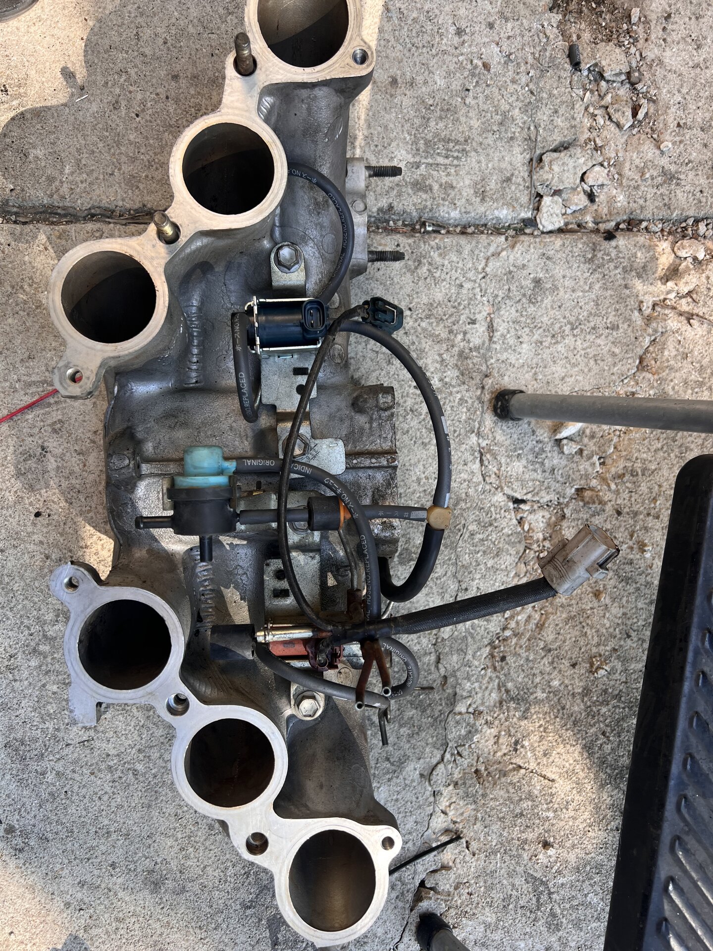

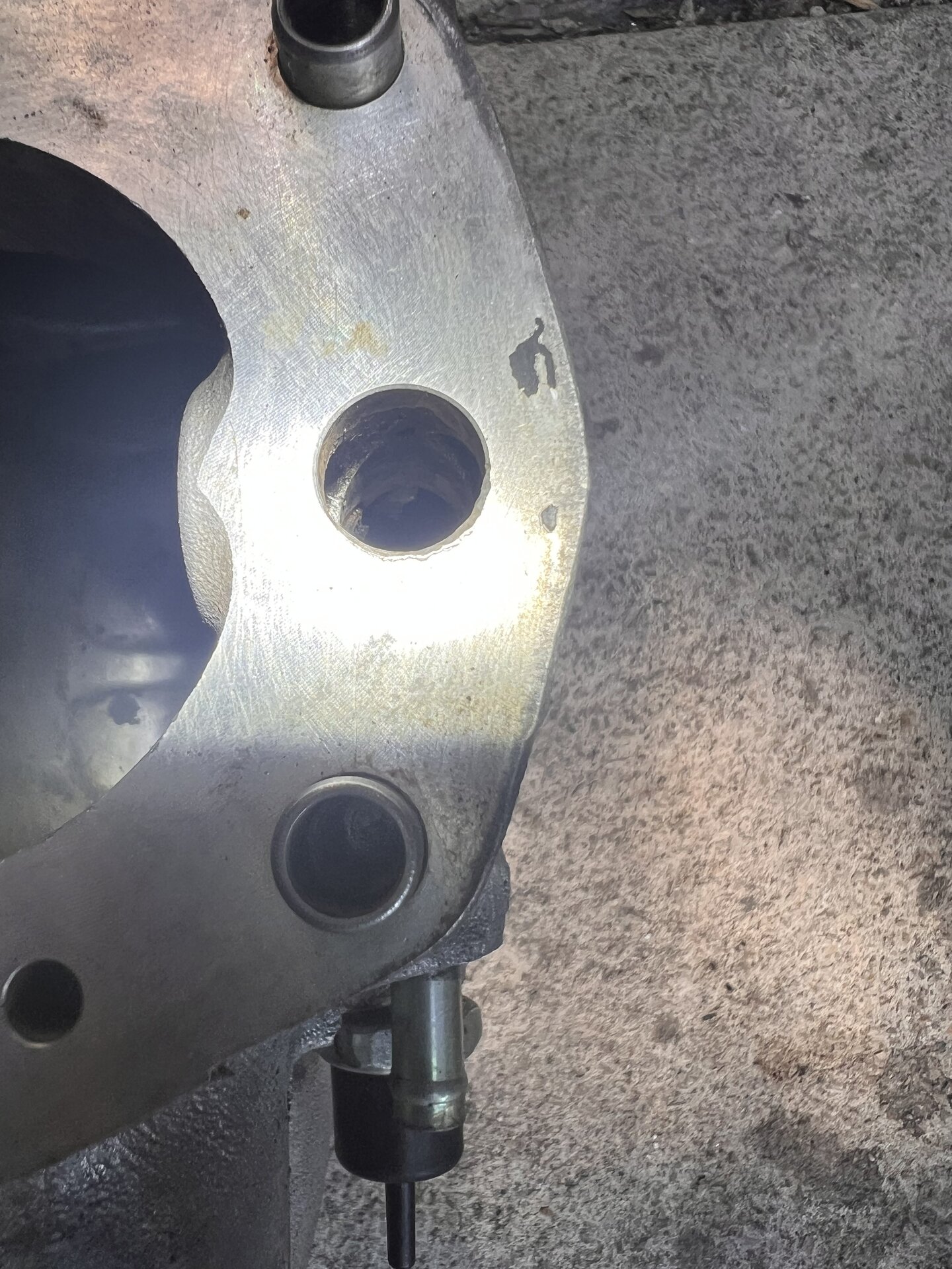

So this weekend I did this fix pulled the manifold/throttle body cleaned both. Replaced all vacuum lines and VSV. Put back together and the truck won’t start. It turns over like it wants to but won’t fire to life.
I have some questions on some ports on the manifold itself. There is one by the EGR sensor connector and one on the underside of the manifold by the VSV (here in this pic I have the VSV hooked up to it) what are these for and where do the lines from the go to?
And here is some pics on my cleaning job

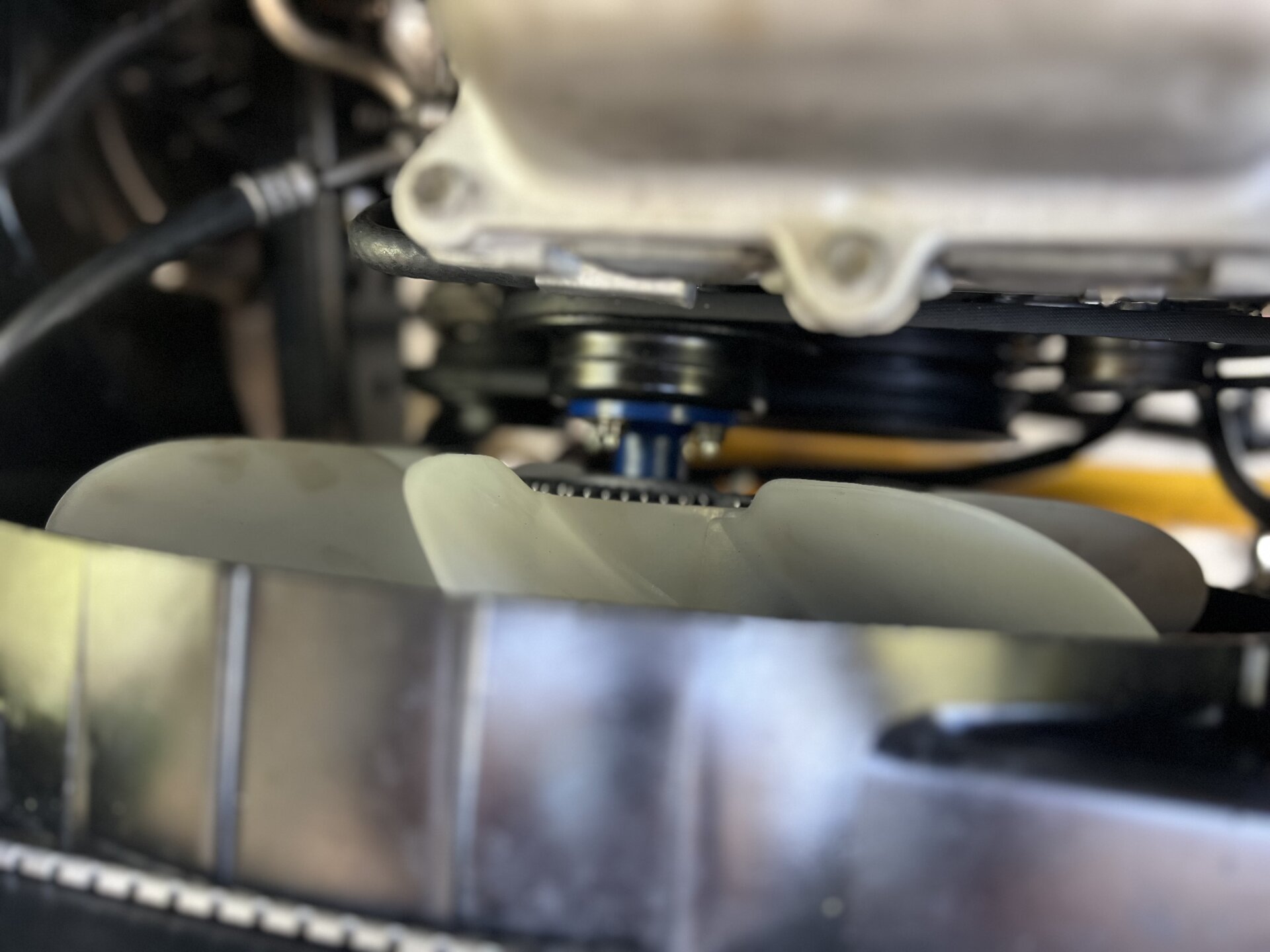

I did a ton of swaps this weekend.
Radiator
Blue hub fan clutch
Water pump
Fan
Upgraded alternator kit from Landrank
New fuel filter
VSV
All new water and vacuum lines
Was highly anticipating hearing this thing run with all the new gear but huge fail when it wouldn’t fire. Anyone have any ideas? All vacuum lines are correct bolts torqued everything seems in place. The only things in question are those manifold ports.

This lines shouldn’t keep it from starting, they’ll just make it run like crap if theyre hooked up wrong. Are you positive nothing else was knocked loose, or maybe a connector not seated? I’d go though the standard troubleshooting process to determine which of the big three (fuel, spark, compression) you aren't getting. Once you’ve ID’d that, you’ll have an idea which way to go with troubleshooting.
X2. If it's not firing up, then I would guess electrical connection - unless the fuel VSV and /or fuel lines have an issue.
Pulled the throttle body this morning and everything is in place. If I got a defective VSV would it cause no start? Would cleaning the VCV with throttle cleaner ruin it? If so would a failed VCV cause no start? I’m at a loss here I have no idea what the issue is I’ll try and upload a video
My guess would be you're not getting fuel after the fuel filter replacement. See if your fuel pump is pumping, you should hear it. If not check fuses. Make sure you are getting pressure to the rail.
