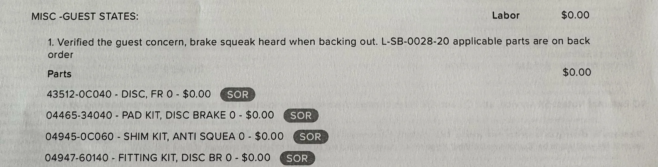

I’m now at two minor problems with the GX. The first was an air line came loose in the passenger seat which was easily fixed. The second is my brake pads are singing loudly when backing up. Sometimes when braking lightly going forward. Is much louder when hitting the dusty trails. Function is fine.
There is a Lexus service notification for this. Parts are on backorder. Basically new pads/rotors/shims combination. Here is the parts list.

10/25/2024 update - New front rotors/pads/shims came in and truck has been updated by Longo Service Department. No more singing brakes. No change in brake feel or performance in the drive home. Will go easy on the brakes for next few hundred miles while the new pads bed into the new rotors.

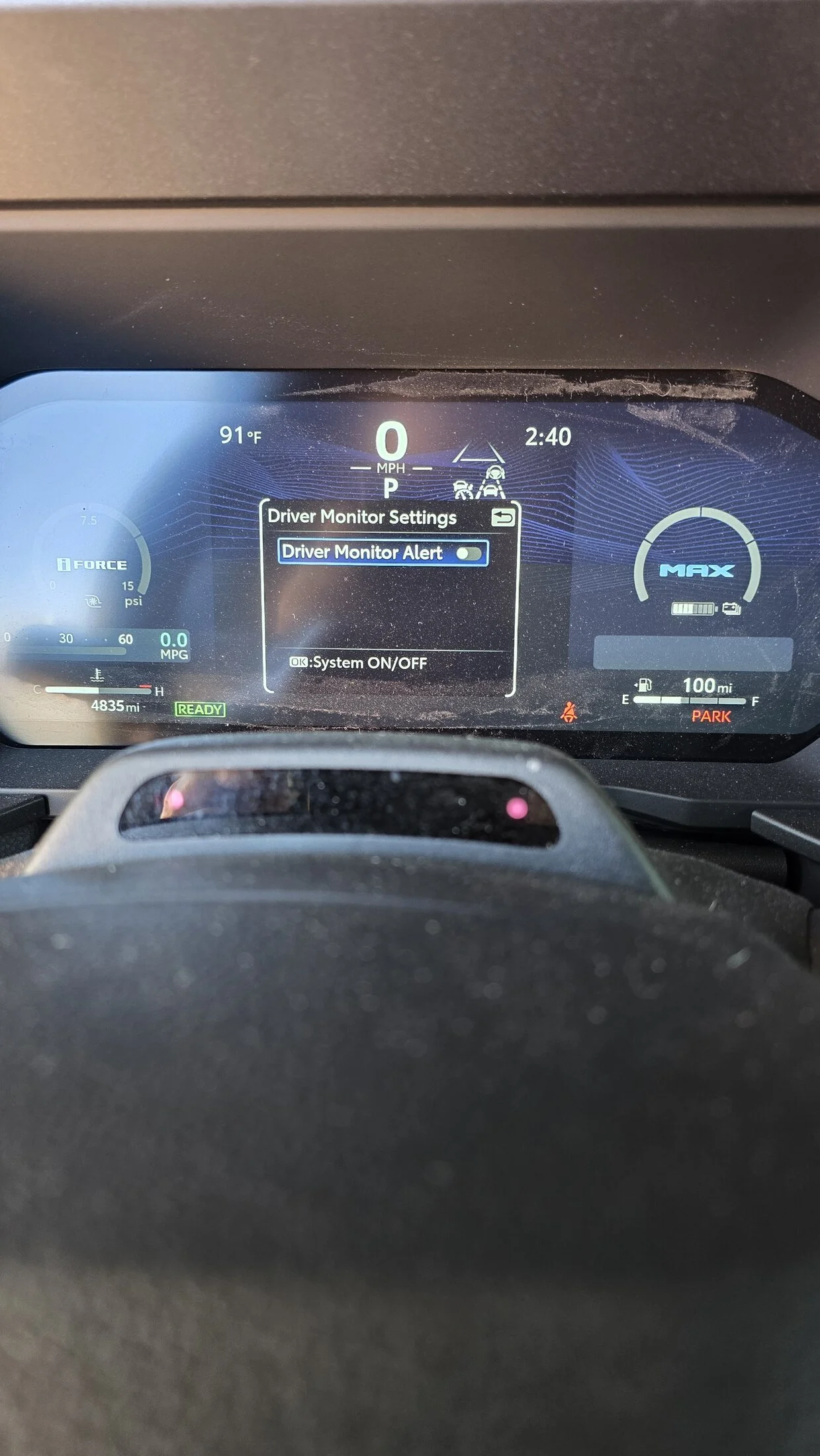

I think I have found a way to stop the car from telling you to keep your eyes on the road. Going to try this and will come back to explain how in case you are interested.

Sounds good, I'd be interested to hear if it works
It was pretty easy to turn off. You turn it off in the gauge cluster menus. Once off, it stays off.
Settings>vehicle settings>driver monitoring settings
I guess that is pretty deep in the settings..

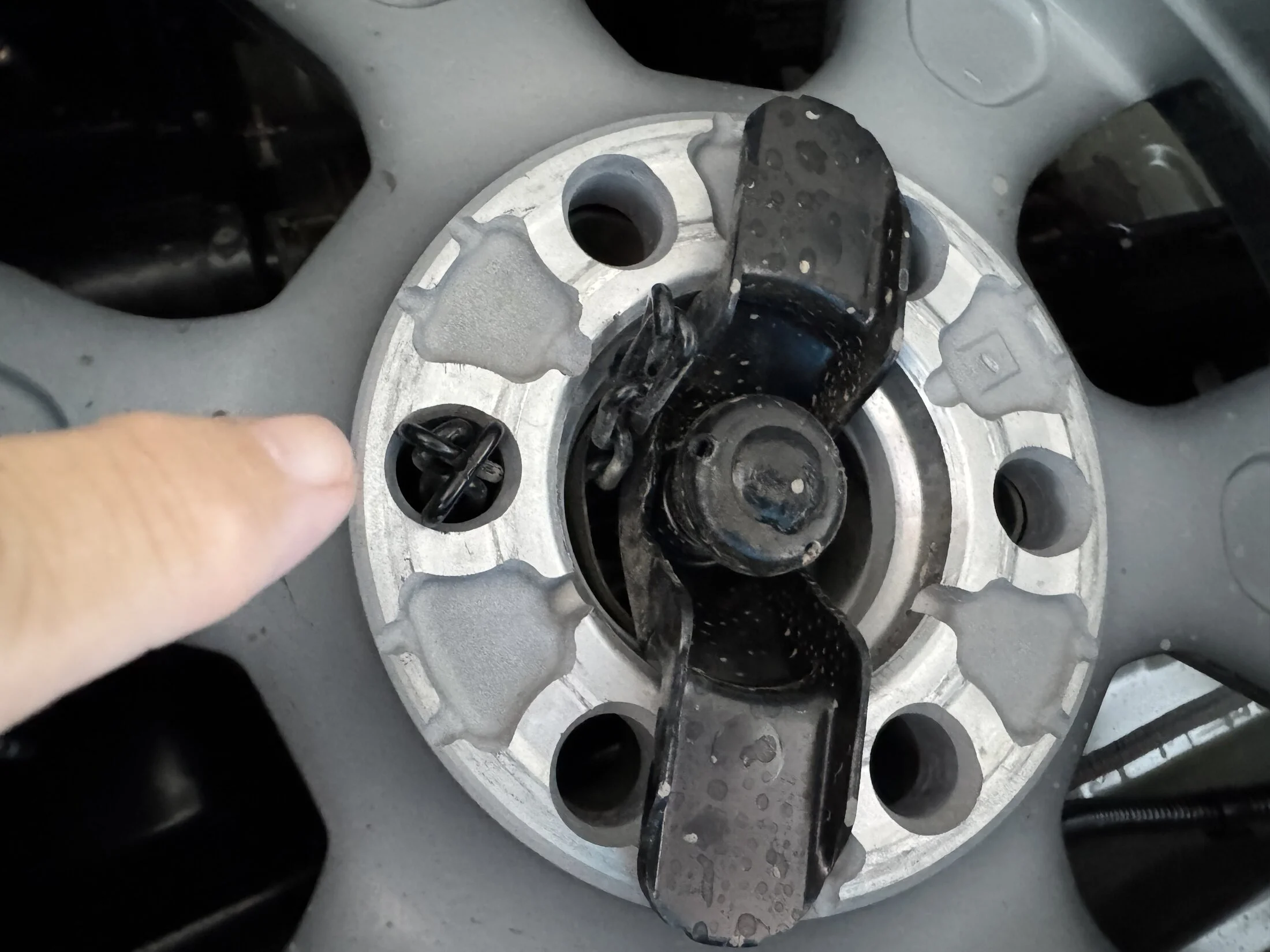

Something to check on your trucks. Be sure your spare tire can be lowered!
Context - 5K service on Friday included a 4-tire rotation. That’s fine, I do 5-tire, but can make the swap at home and I wanted a practice spare tire swap-out dry run in my driveway on a sunny 65F day.
What I experienced - I couldn’t lower my spare more than an inch-or-so. It would lower normally (same set-up as my Tacoma had) and then bind, and bind solid.
So, crawled underneath to investigate and found that spare tire chain loop had fallen through one of the lug holes in the spare and was cross-wise jammed into the hole in the wheel. I’m really glad I didn’t he-man it because it not have come free and would have likely broken the spare hoist chain and/or mechanism.
Here is a picture of the offending link
So, I ran the spare back up (to get as much free chain on the ‘unloaded’ side of the mechanism and then used a flat-blade screwdriver to pry the wedged chain link free.
From there same-same as my Tacoma.

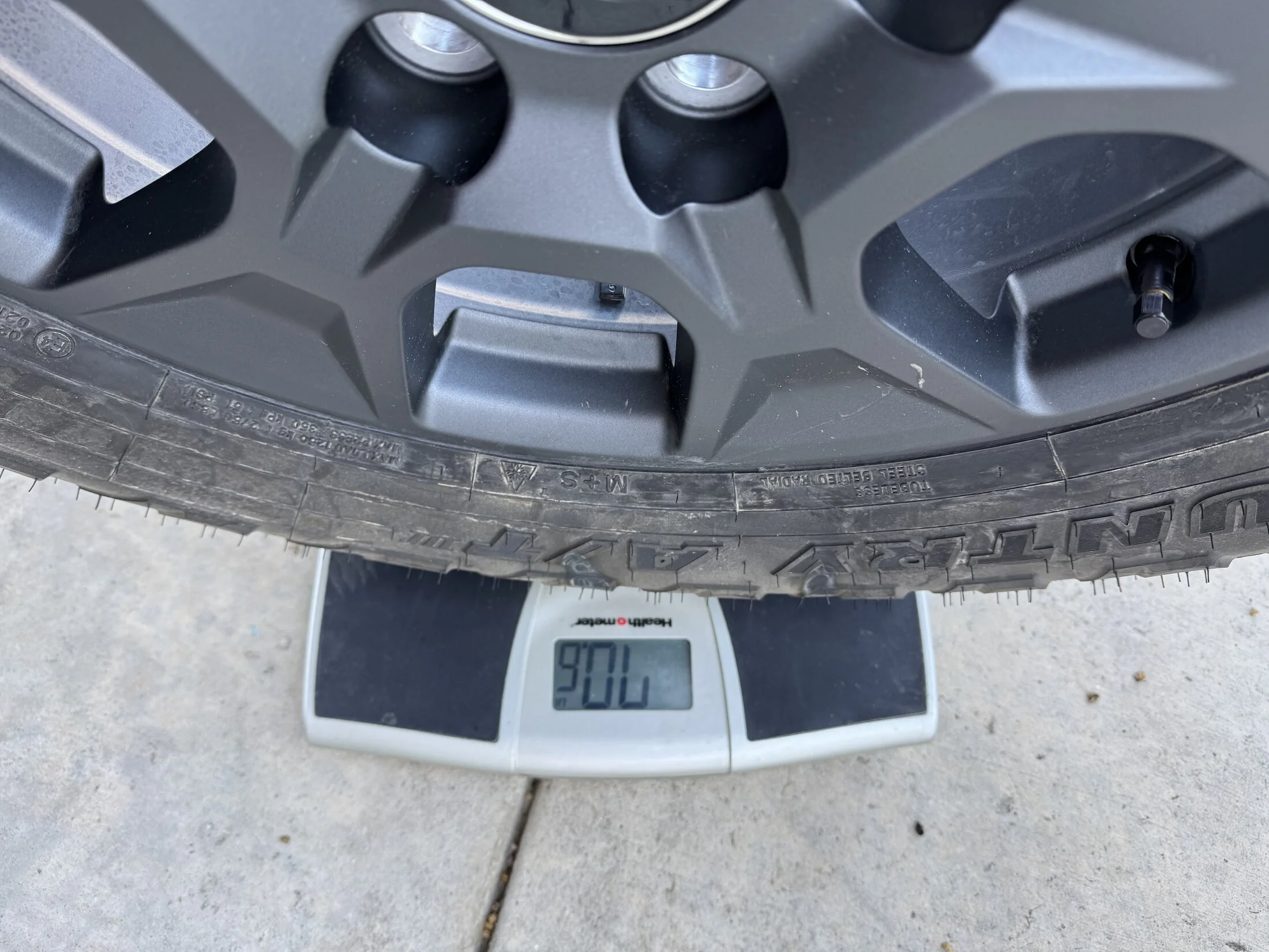

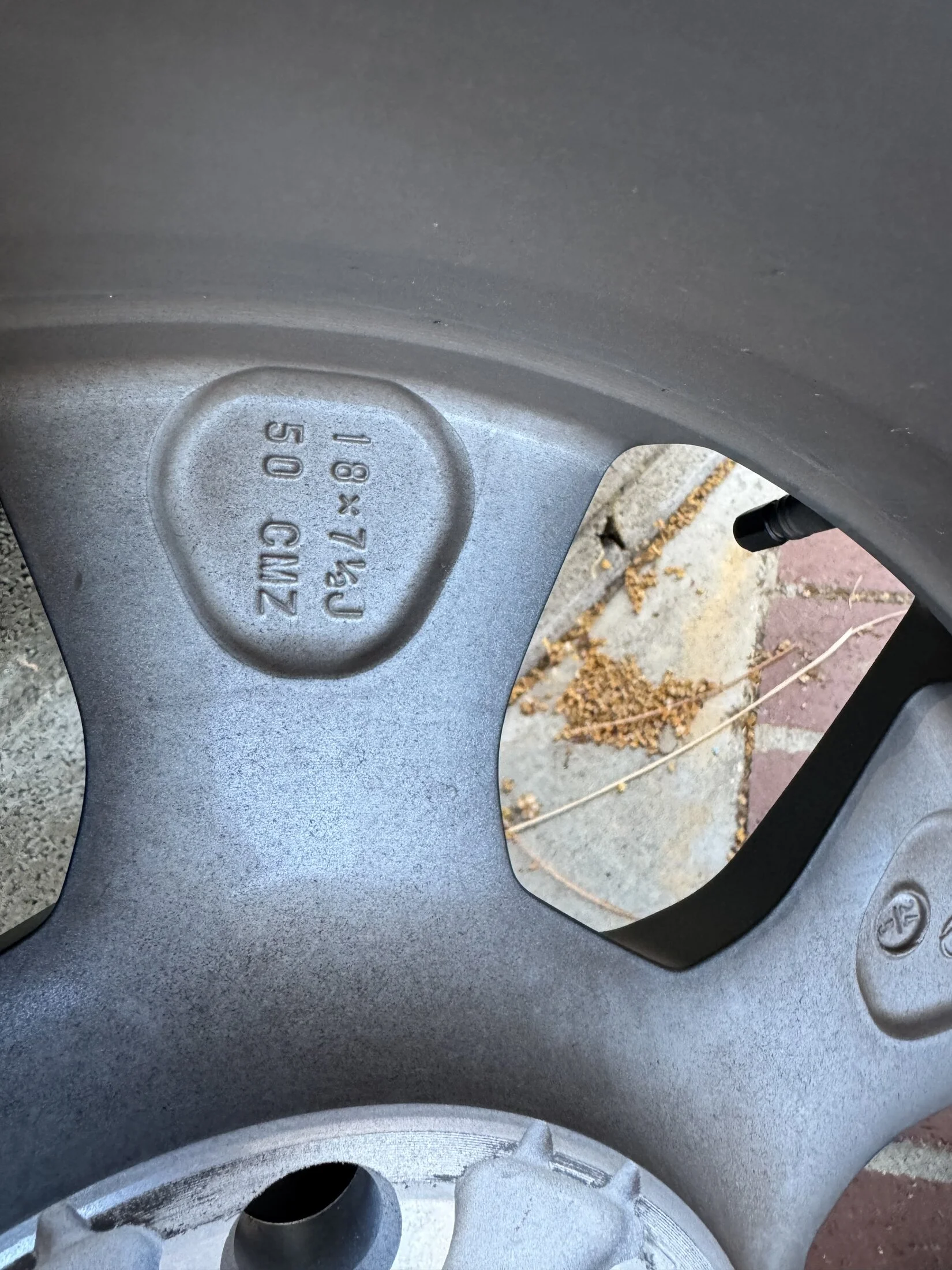

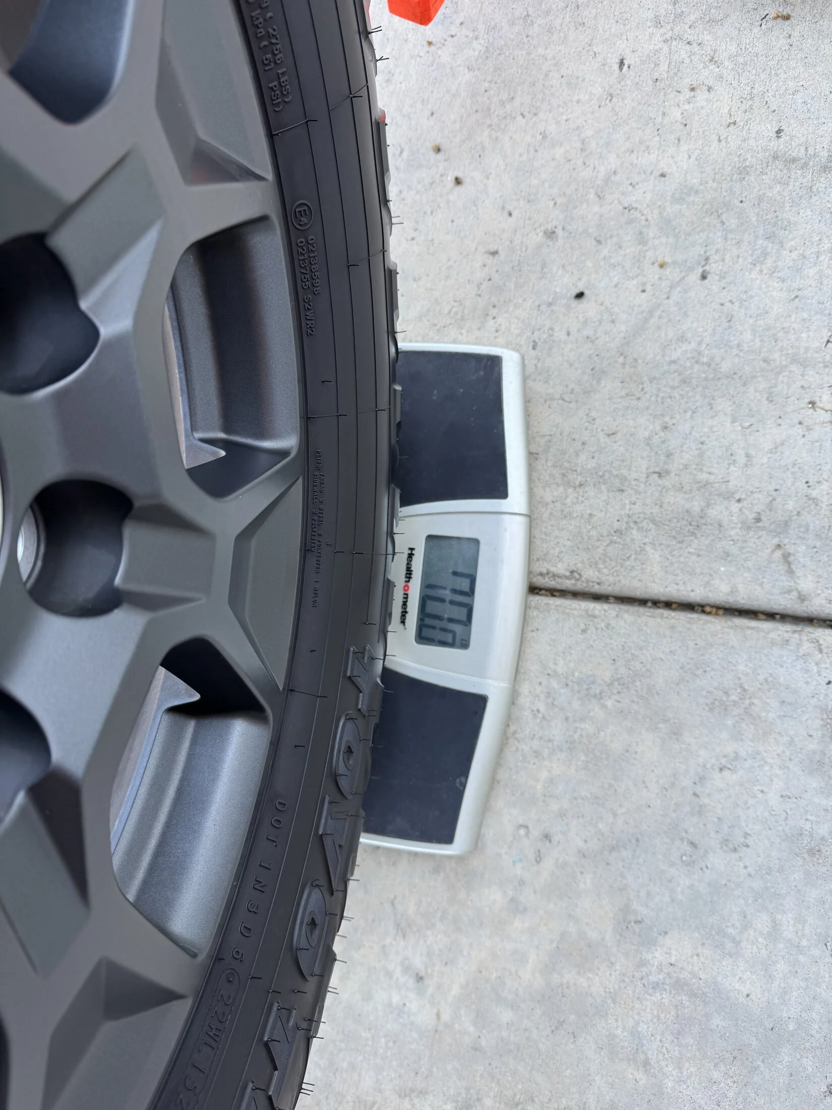

I also went ahead and weighed the tire that had 5K miles on it and the spare. The unused spare weighed 70.6lb, the tire with 5K miles 70.0lb. Quite light for a 33” mounted tire. I also compared the tread depth and, while the 5K tire had a little less depth, it was not an appreciable difference. Here is a photo of the wheel specs cast into the wheel back side as well.

Turbo8 has outlined above except I also turned off "driver monitor camera recording". So still in vehicle settings...DMC Recording - turn off.
I've driven and tested and no one telling me to "sit up straight" or "eyes on the road". You can drive with your hand at 12:00 and look away if you would like.
