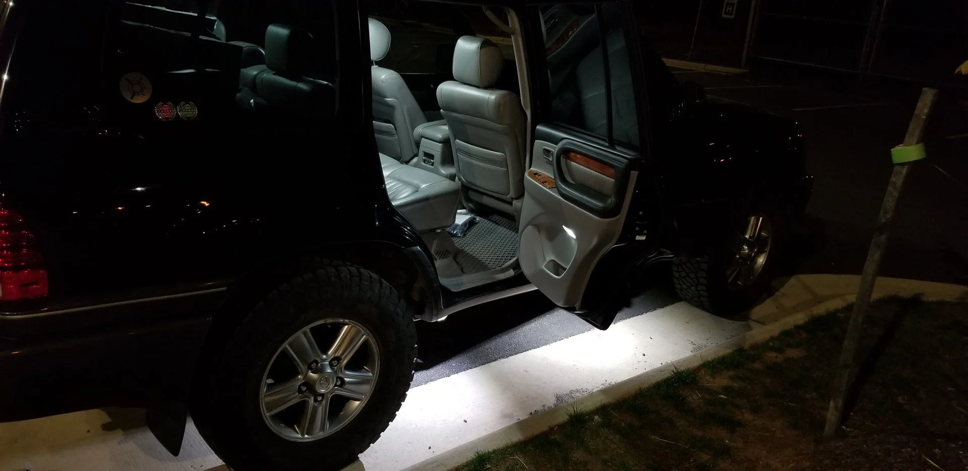

Its really not that bad compared to the initial photos and my interiors light output😥😅😅. Just installed today while waiting for the correct brackets.
I have the V3 lights and I think the light output is excellent. Way more light output than the oem running board lights, and more than bright enough to double as rock lights.

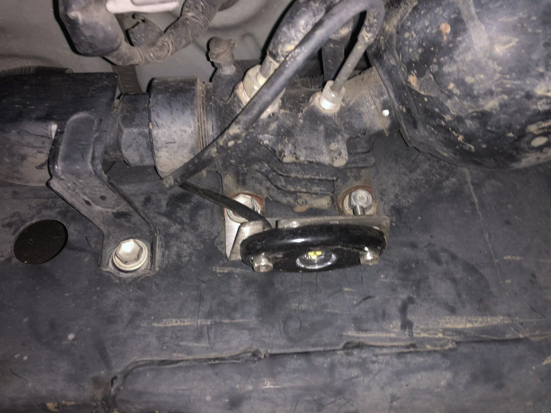

I was able to route the wiring behind the AHC globes/accumulators and on top of the frame for a super clean oem look.

@jtb517
Post up some pics of the lights and wiring. Interested to see how it turned out.
@S.CarolinaFZJ80 Not much to see. I removed the skid plates/guard plates covering the AHC system (2x 12mm bolts at each corner) and routed the wires behind the AHC components to the top of the frame rail. There are factory wire looms running on top of the frame rail. You can feel them if you stick you hand up there. I just routed my wiring next to the factory wiring.
