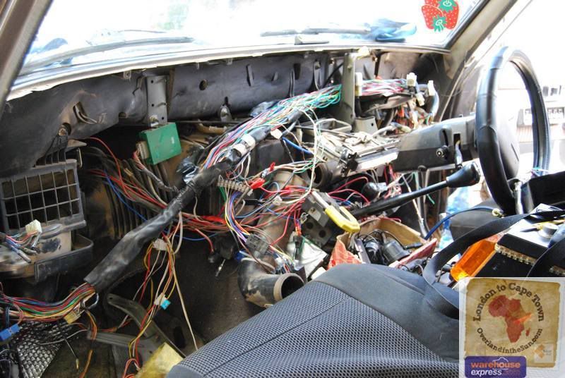

Now in Uganda after having to take out all the electrics due to my rear light wire burning out (for some reason the fuse didn't blow!
Here is my dash out picture..
What's the ETA to being back on the road?
Definitely replace that fuse regardless. It's clearly capable of passing more amps than it should.
Great trip Gwen! :cheers:
The wiring in your car is 24V - could it be that you have a 12V fuse that is rated higher than it should be for 24V .

This maybe true... but I have no idea where to buy 24v fuses here!

Thanks for the info about the fuses - that does seem to make sense.
