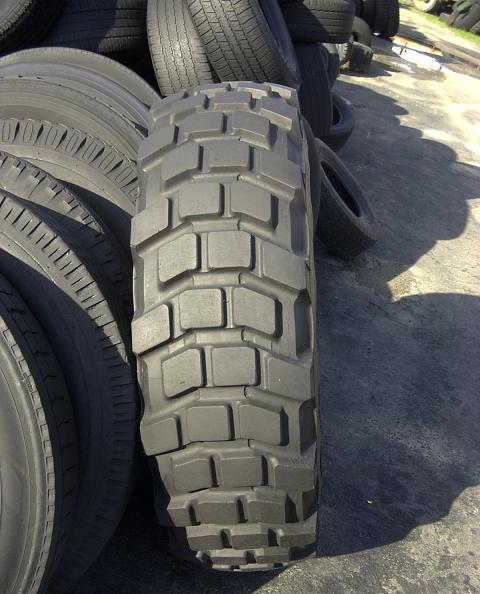

military michelins may be the ticket. i think they jump from 29" to 34" though and then go huge. i've heard you can ride them flat because of the steel sidewall.

Those michelens look awesome, similar tread pattern to my yokohama that I have on it now. However the problem would be buying them in Ethiopia. The town that we bought tyres there was the option of some chinese tyres, some Indian tyres, some Ethiopia made tyres, Yokohama, fake Bridgestone or possibly real Bridgestone. And this was much more option than the previous two towns we had looked in!
yeah but the michelins may have lasted the entire trip if u started with them lol. i've seen crushed bullets between the treads but the tire still holds air. i used to have the 36" size on a sidekick, drove over 3 1/2" spikes on purpose just to show them off. 4 ply steel on top!! BUT they're very heavy.

They quite probably would have lasted the whole trip, but I was given the Toyo's and you can't argue with Free!
