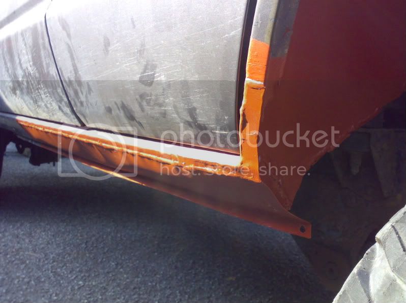

Last weekend I picked up the "CumTruck" from a Landrover specialist who have sorted out the welding and checked the frame - which is all good!
A few pics post rust...
Its not pretty but its for Africa!

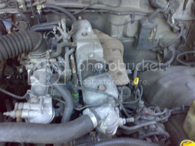

great .. but the oil around your oil cap, means you miss some oil over the valvle cover the last time that you change it .. or your engine it's blowing compresion up ..?
(!) The engine picture was taken when I first bought the car, it is just a clumsy mechanic.. Engine really is fine.
Truck has 146,000 miles so just run in really!
