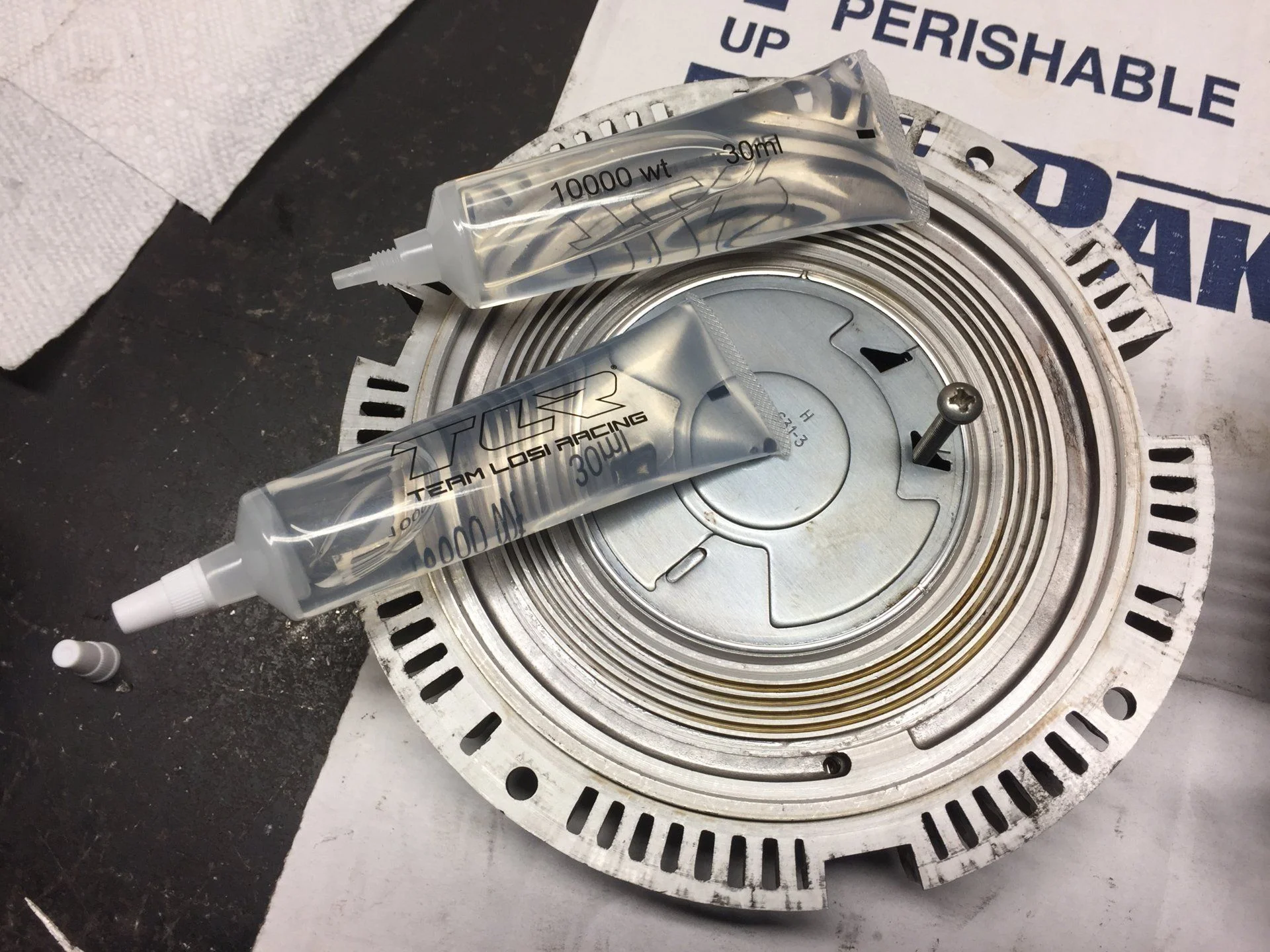

  • The new in box blue hub fan clutch I bought seems to kick on normally

Tell me about the blue clutch mod. Does it REALLY work that well? Also, whats the final word on fluid weight and where to get it?

Yes, the blue clutch mod will help and it is simple. Theres a good Youtube video I watched then did it. I used 20K fluid but most recommend 30K if you're not in the arctic north.

Where did you get your silicon fluid? I've got parts on order for water pump and t-stat but if I can source the fluid local I can start on that.

You can get the silicon fluid at most local hobby stores...its rear diff fluid for remote cars, weird I know but same stuff
fluid...
make sure and get the correct amount in and weight for the style of hub you have..and temps for your area..
make sure and research...I dont have a blue hub...they all differ a bit..
Put heavier weight in. 20k. I think they come with like 6k thick oil?

To the OP. Your symptoms sound very similar to mine. I replaced my radiator and did the blue fan clutch. Initially, the results were...meh. I bumped my fluid up to 20K. It helped but did not cure the problem. Bumped it up to 30K and am satisfied with the results.

Modding the clutch is most certainly worth it and dont waste your time with anything less than 20k fluid. Good luck!

I think I've come to the conclusion that the CSF 2517 radiator just can't reject the heat fast enough at my elevation. Either the design doesn't permit enough airflow, the area isn't large enough for the all brass design or a combination of the two. I bought some silicon fluid to fan clutch mod, I guess I'll try that next because its cheaper than a new OE radiator. I reached out to CSF but I am guessing I'm going to get a whole bunch of nothing from them. Really annoying.
