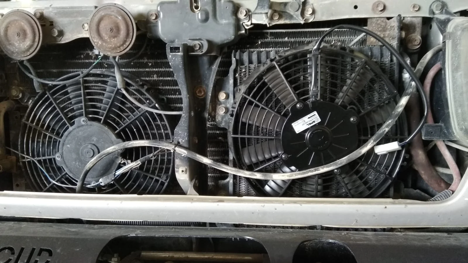

new CSF rad all new system including new oil cooler Tstat pump. and all the rubber. installed another spal electrical fan on top of the OEM manual operation
Blue FC mod 50 ml 30K oil 95F mod
toyota red
heavy Rig 6k Lb
external conditions 99F in the shade 170F metal in the sun
Measuring coolant temp by OBD1 scanner
tomorrow last trip to the desert 2 dayes and nights
i had a problem of overheating in the past going over 60miles on highway 70-80 it got hot 210F and once in extream hot day on trail it cut the AC so i opened windows and stooped AC and put heating on full it was 225F
i will see this trip if the 30K FC mode and the extra e fan will help

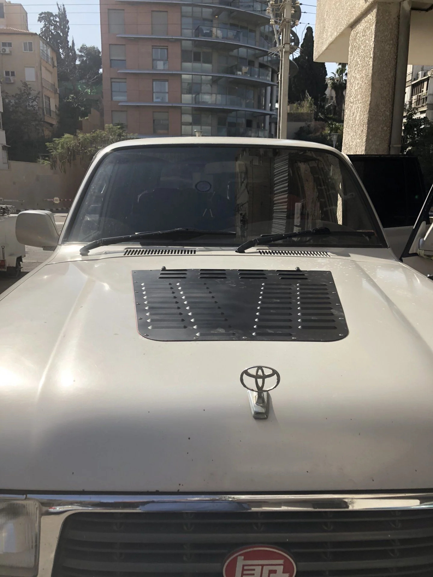

I have big hood openings to resale the heat from engine
