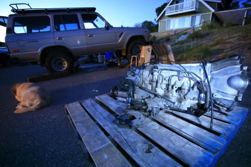

So I've taken the plunge and took out the A440. So this afternoon I removed everything and will replace it with the H55 over the next couple weeks.
Taking it out wan't too difficult even without a tranny jack. Remove the shifters, wiring, and fluids. Then, I slowly lowered it with three bottle jacks and seperated it from the engine. 2 jacks for the tranny and TC, and one to keep the engine supported. I also used a heavy duty strap from the cab and slowly let out tension. We lowered it onto a palate and pulled it right out from under the truck.
It was starting to get dark and couldn't see and figure out how to remove the torque converter. I'm sure there are bolts but that will have to wait for another day.:frown:
I'm posting up some pictures to aid the next victim in their quest for a better tranny, the H55.
At the end I'll post up a parts lists and costs.

To get the Torque Converter out, you need to take the bolts out of the flex plate (toward the motor)
Cruiserdrew, Thanks.
So on the engine side there are a couple covers that the bolts are under. I'll check that out tomarrow.

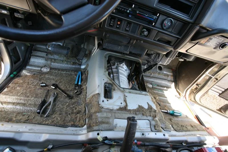

You will find that the pedal bucket is the biggest pain in the butt to install. Yes you have to almost completely tear apart the dash to get the old one out and the new one in. Just takes time.

I spent a couple hours tonight working on the pedal bucket. What a major PITA. I finally got all the bolts out (the top right rear bolt is the toughest, behind the defroster vent) of the bucket, and it's loose but navigating it out looks impossible with removing more. I'm thinking I have to disconnect the steering colunm under the hood???? suggestions..:crybaby:
Also, I remove the torque converter, and flex plate. The bolts are axcessable on the engine side behind a plate on the drivers side. After removing the plate you can turn the converter and take out each bolt.
I'll keep updating as I move along.
I'm slowly working on the same project, except I'm swapping frames at the same time. It will take me more than a weekend. I did install the pedal bucket already though, as well as the master cylinder. I removed the entire dash, all the ducting on top including the defrosters, and of course, to remove the defrosters you need to remove some of the dash supports.
