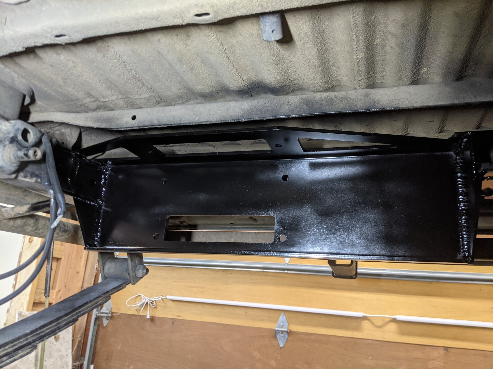

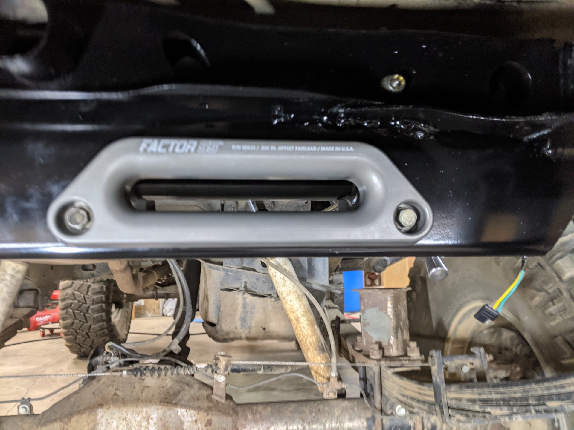

out with the old, in with the, well, old...
last picture in gh ill.

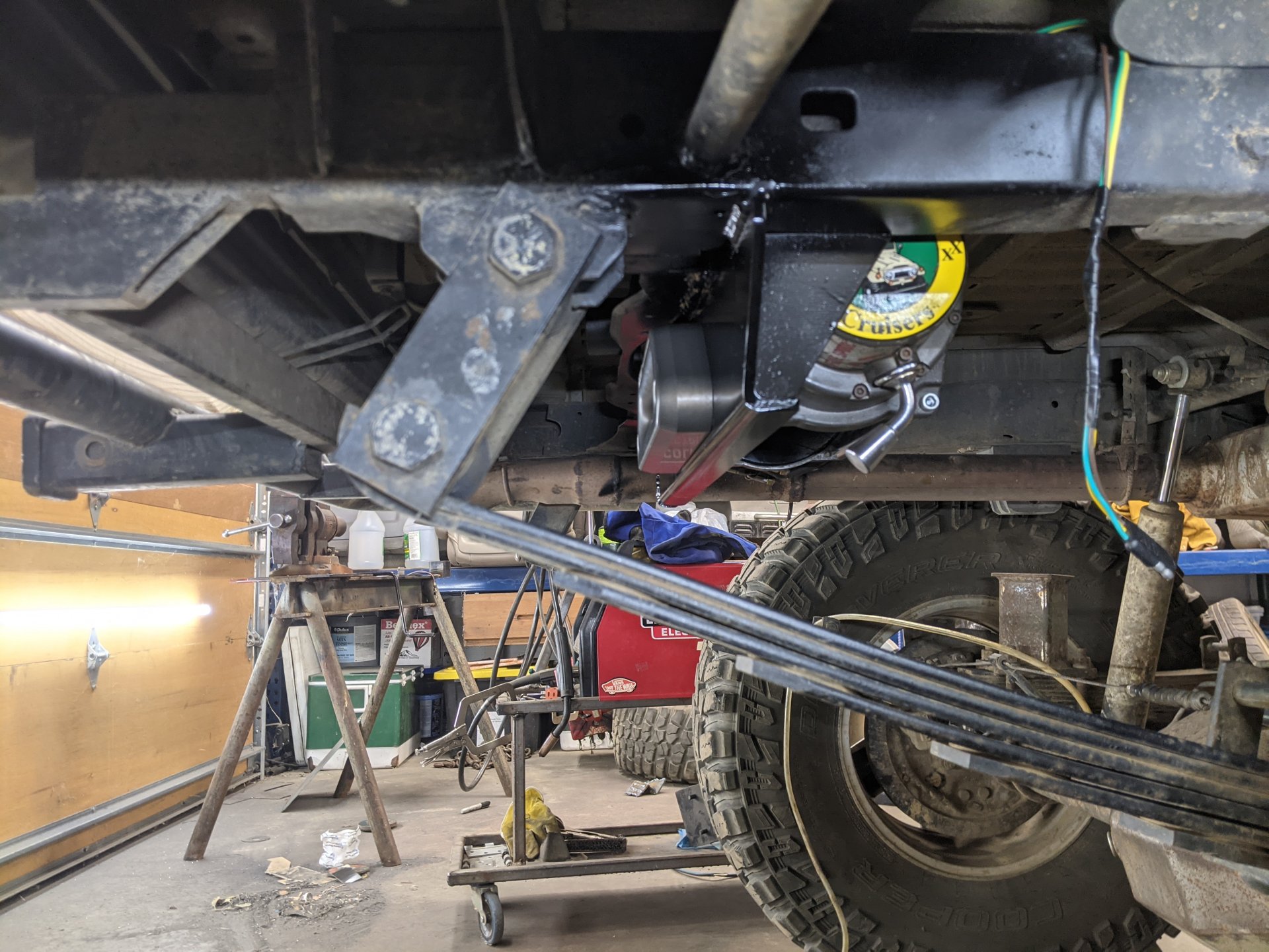

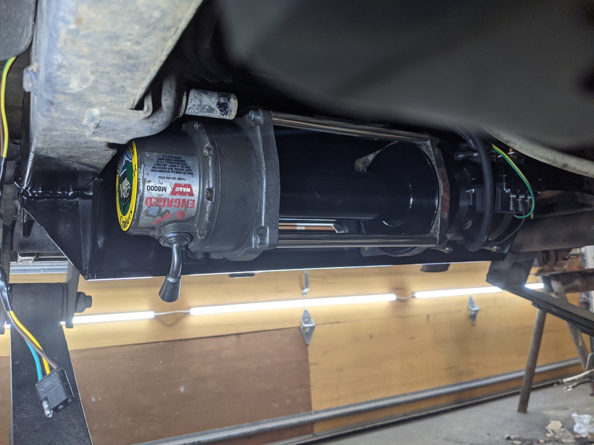

i have been doing a few updates to this thing.
noted a blown front bump stop and some damaged spring/shackle bushings after the trip.
so i updated the front spring and shackle bushings. frame bushings front and rear. skys shackles up front for a slight lift.
i have new bumps and landing pads but need to find a welder. :bang:
