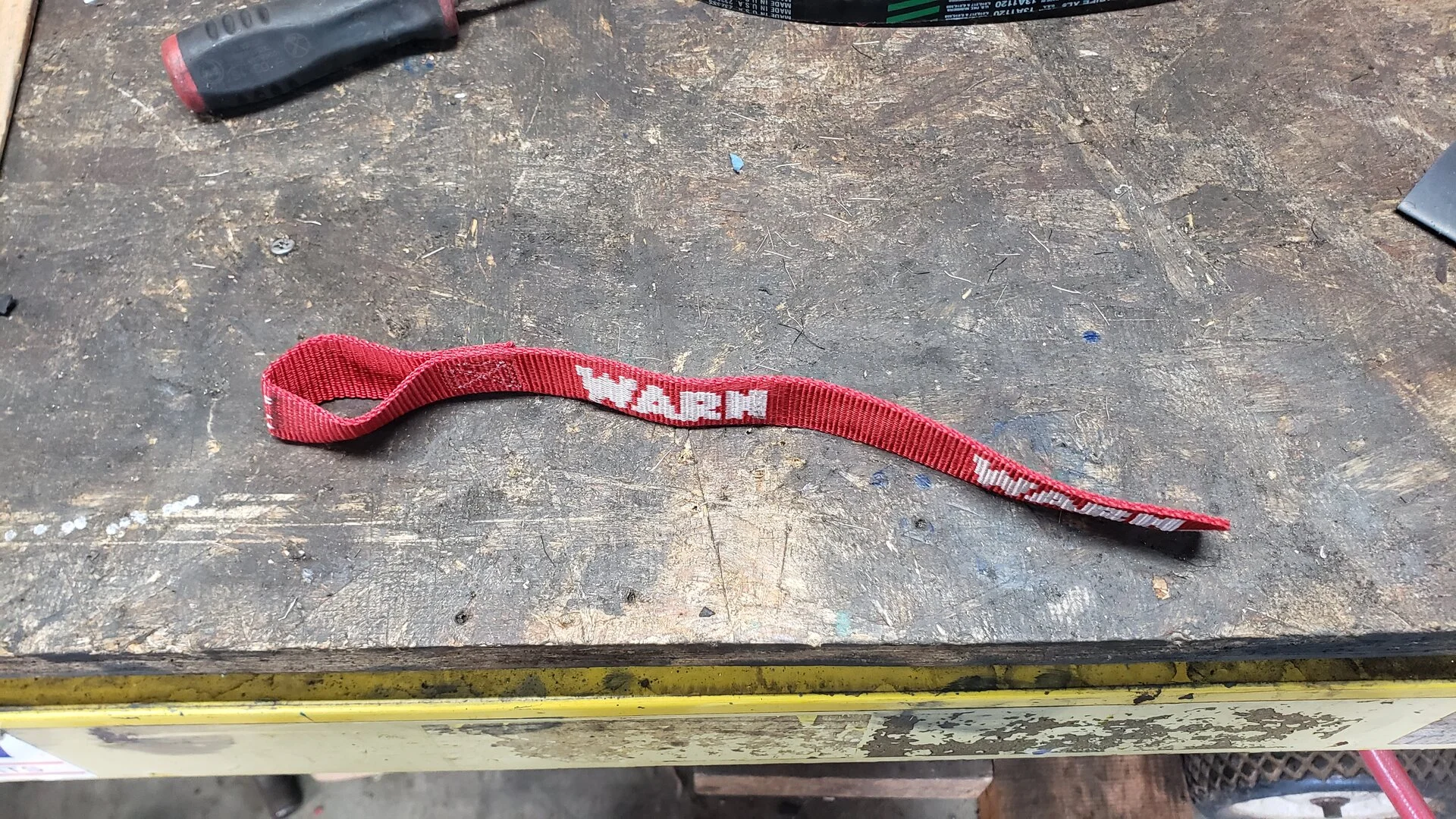

What did you do with it after the pull?
R

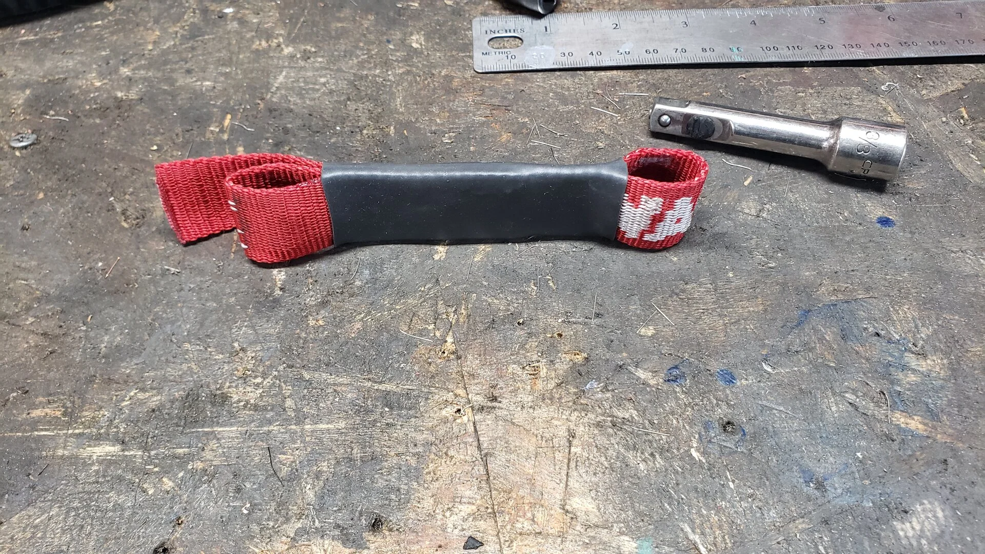

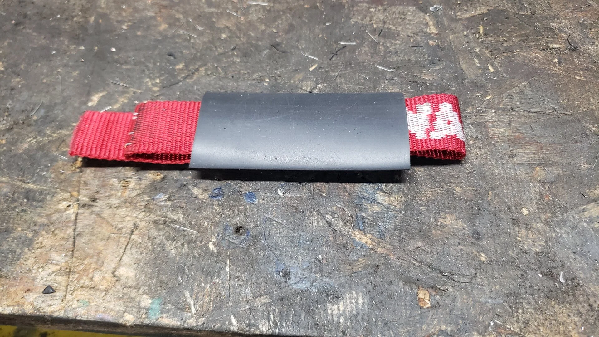

since i had to take the rope off and wash it, i made a "rope lock" for reinstall.
like this but free.
heavy duty shrink wrap?
it's just heat shrink, ya.
i ended up almost running the line off the drum the other day. 100' of rope really isn't that much.
i needed to add some kind of indicator. this came to me while I was thinking about putting a piece of red tape or heat shrink on the line to show.
i don't think not having this fully sewn will be any sort of issue.

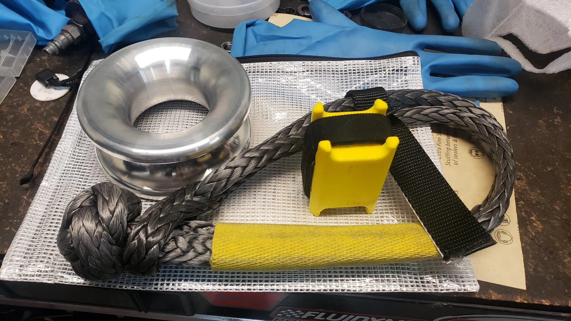

I have a length of rope shroud on my synth line at the drum. If the shroud peeks out the fairlead, then I'm at the end of workable rope. I took my old synth line to a shop and they made me two extensions from the remaining good lengths of rope. I think I have 100' on the drum and two lengths of about 40-50' for extensions.
i have a couple shorter, 25, 30ish footers.
been considering a longer. it would be nice to have another 100', especially at only 2lbs.
wouldn't hurt to have a couple moar soft shackles either.

will likely grab another snatch pulley at that price though.
eclectic mix of bits on that site.
Yeah, he's a bit of a tinkerer. That pulley/soft shackle combo is a good deal.
grabbed one of these. he's sending me another bag for my f55 wheel. very cool. quick response to my email.

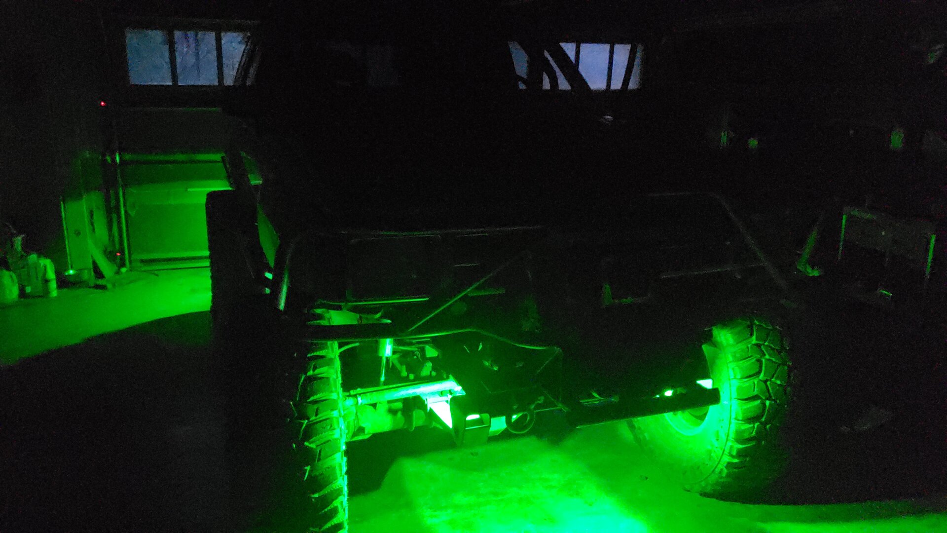

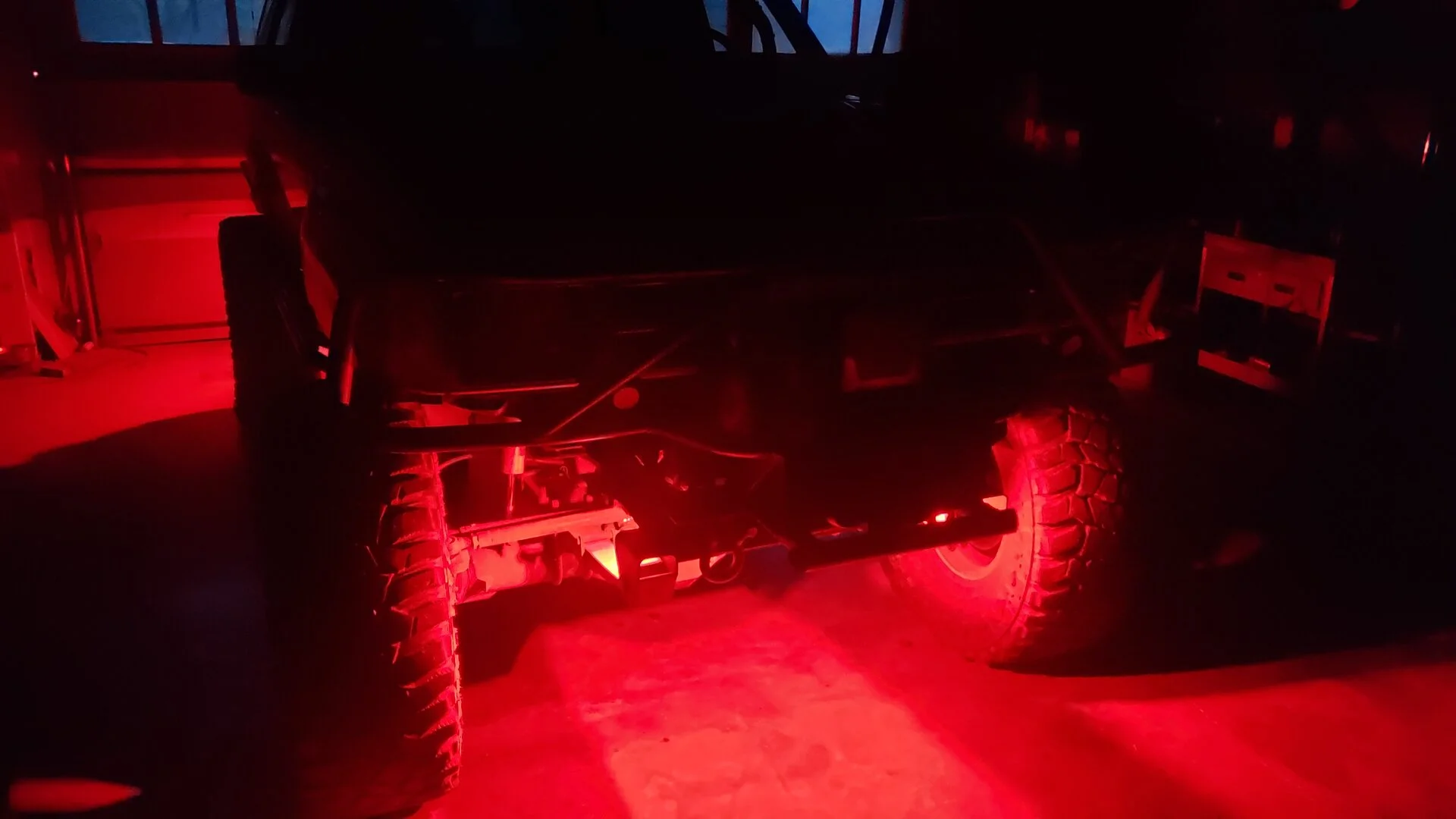

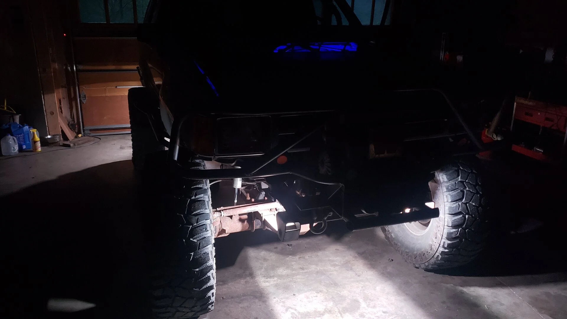

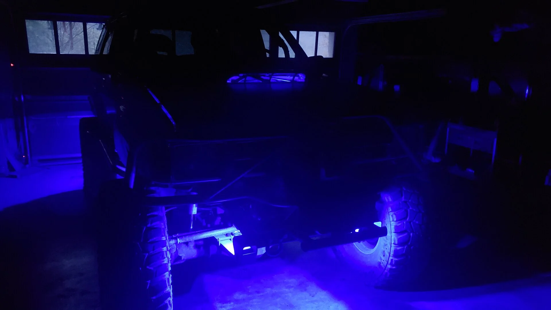

after doing a rock light install for a guy, and then some good deals on black friday. i bought a set id been wanting for a bit.
i thought having magnet mounts was going to save some time, it didn't.
lights are the rgb
i wanted colors but not to get raped for the controller. I was able to get all but one color using two on-off-on switches. one is dpdt, one is standard.
