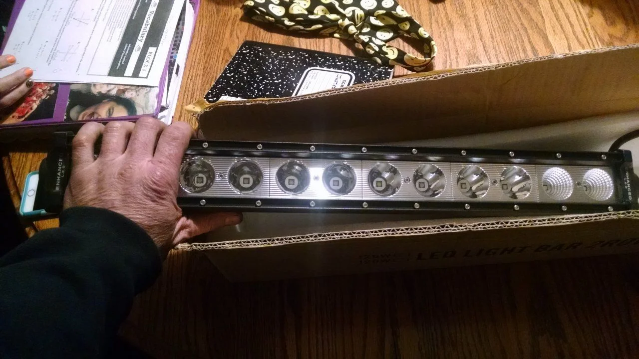

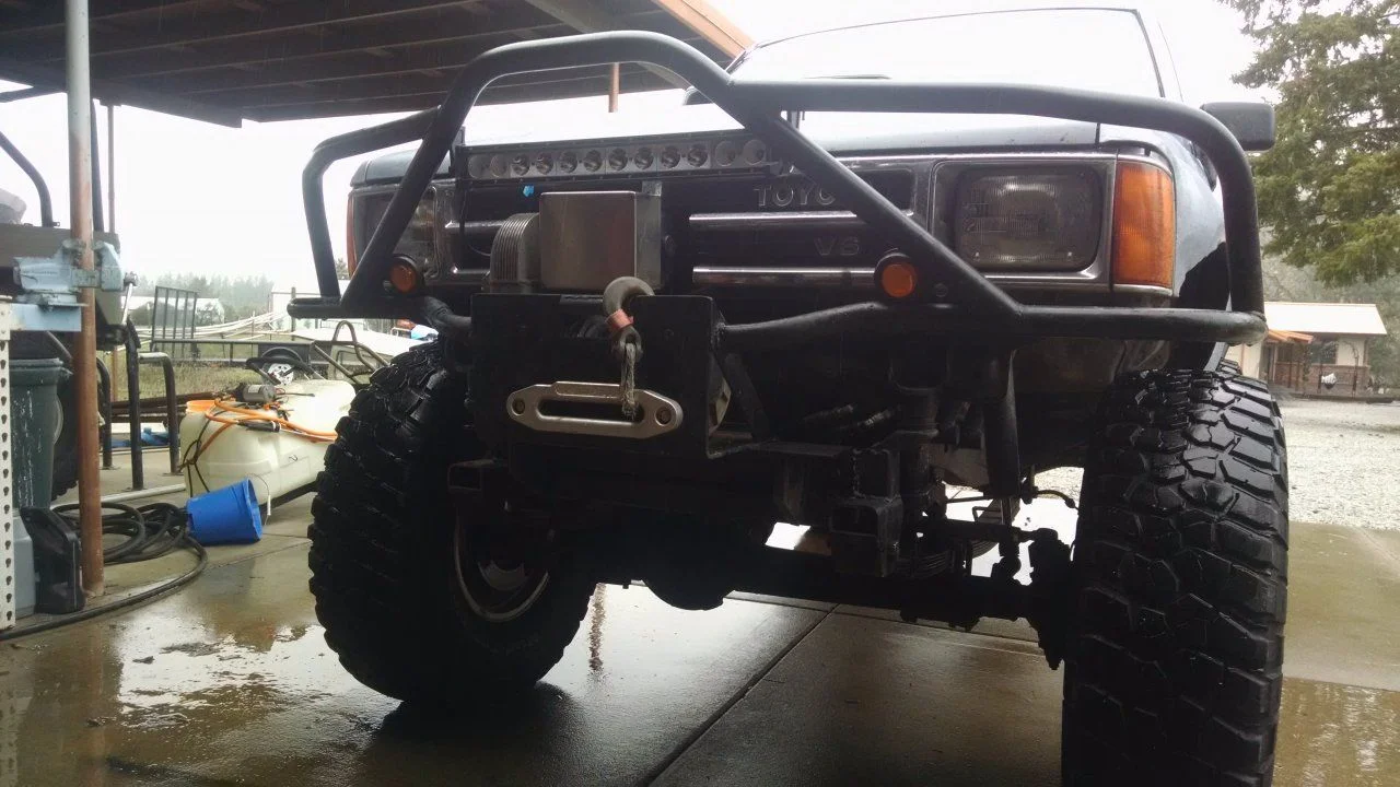

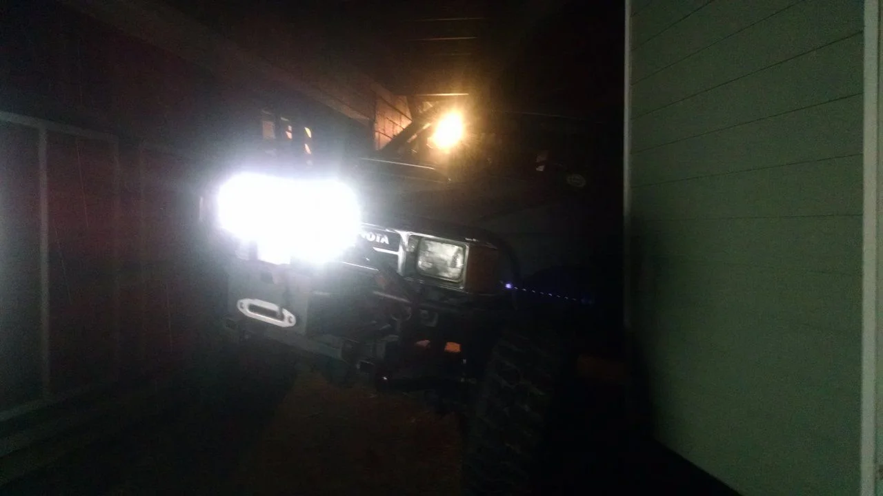

New light bar installed

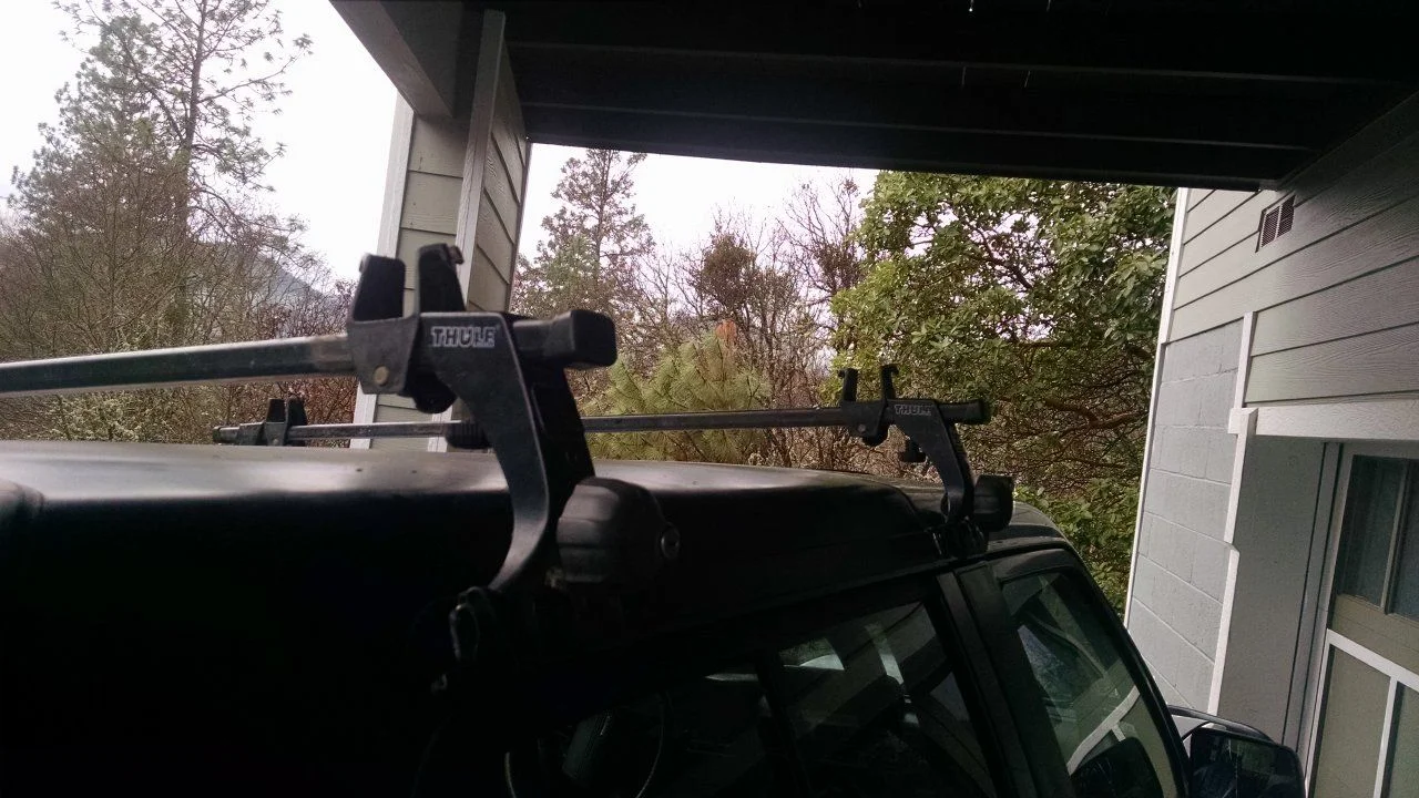

On a side note. The Thule rack set i got is apparently pretty old. Of course Craigslist..... One of the legs was locked.
So my immediate solution was to disassemble the knob and flip the lock cylinder, "unlocking" the knob.
Annyway I called Thule with the lock code and had new keys in a week for under 12$.

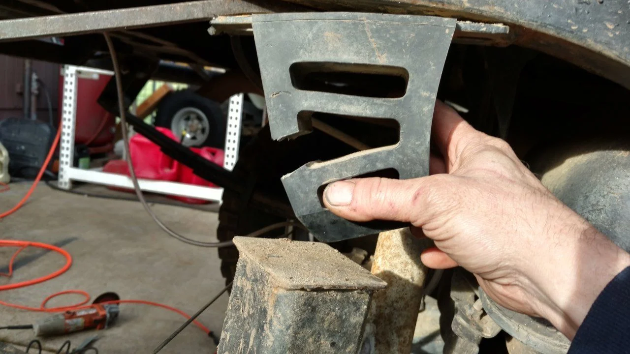

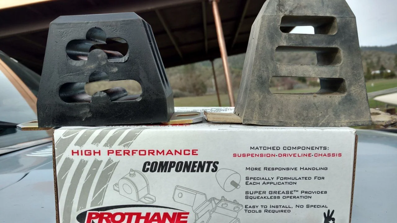

The daystar bumps didnt last long, Disappointingly. They had a dozen or so runs on them. Guessing the bump pads almost never hit them flat. Kind of the nature of the beast.
So pics.

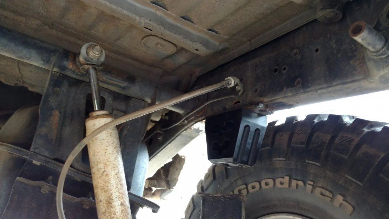

Recently replaced a broke brake hose. Looks like my steering box is leaking a bit too:(

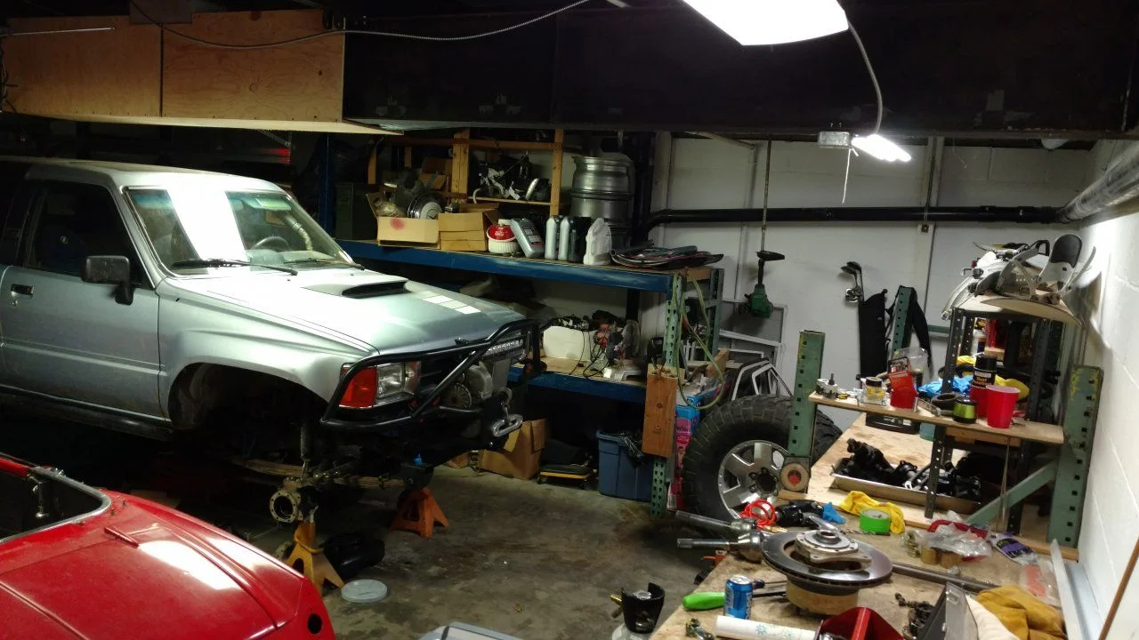

New garage is working out well. Got some new lights wired and the garage door working properly, after a long aggravating battle.

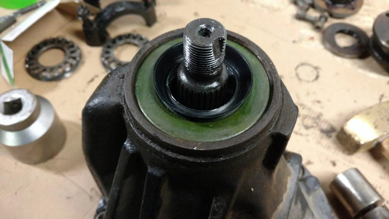

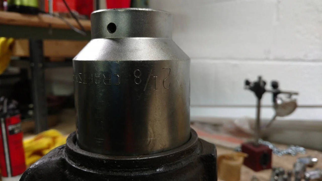

Going to drop the front diff to inspect, replace the pinion seal and install a solid spacer. I also need to swap the steering box input seal. Need to knock this s*** out and get busy on the 'lady. :smokin:
