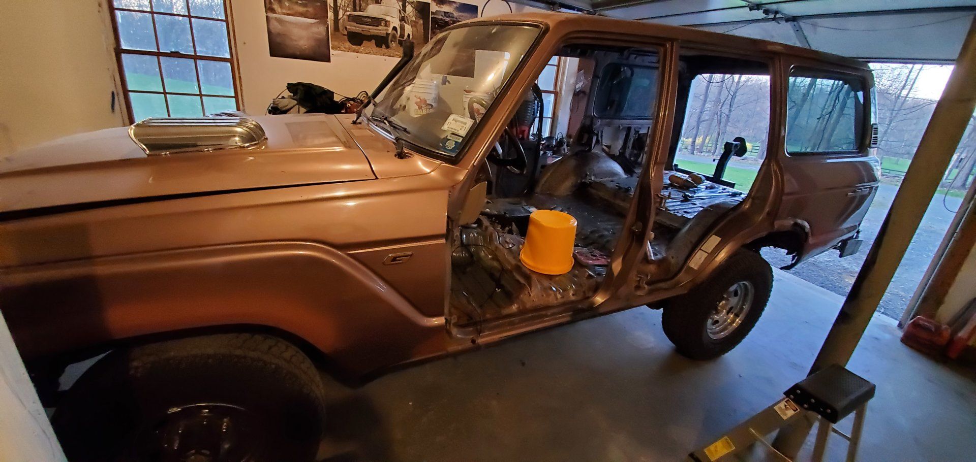

Once the floor is cleared of all the tar, I can start cutting and welding.
So, as of today, it's all done. Took about 6 hours and looks good, with the exception of, ofcourse, the rust!
This morning I went ahead and stripped the roof gutters. Plenty surface rust there. I also took off the driver's door. Plenty rust on the bottom of that door as well. In fact, I think all my doors need some level of attention. I then pointed a light betwwen the A pillar and fender and looks like I have a patch of surface rust there as well! Pffft, go figure.
I then quickly realized I have gone down the damn rabit hole, again!!!

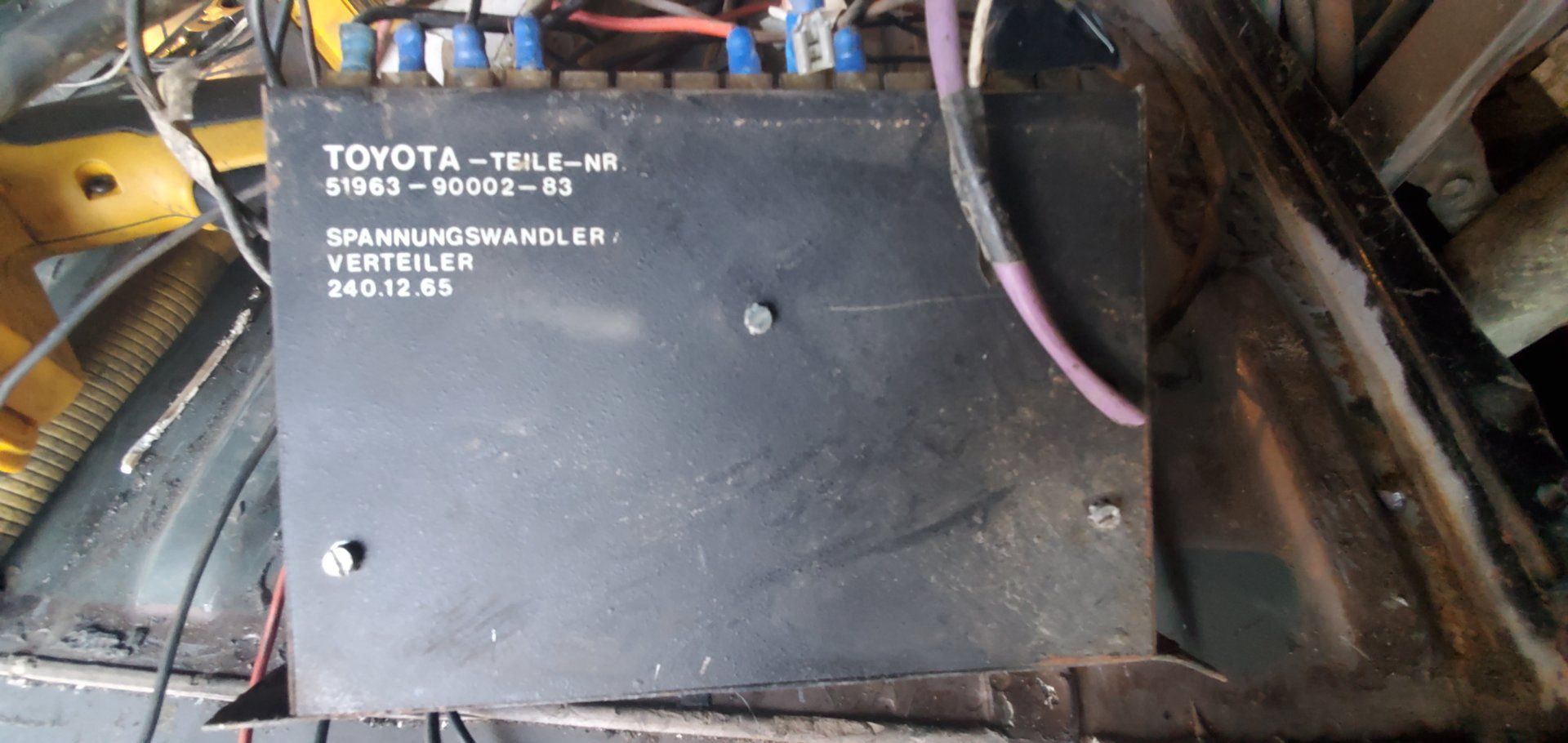

Today, I have managed to take off that hefty Kaymar bumper. That thing weighs in at a ton! I had to cut 4 bolts as I couldn't remove them. I then proceeded to remove the spare tire carrier from under the truck. That cross member carrier hasn't been in use since I got the vehicle. I am debating whether I should put it back or not. I think I will remove the fuel tank as well. I have a spare and if mine is showing signs of rotting, it will get replaced. Now, I have a question. The fuel tank vent doohickey with a bunch of hoses connected to it in the passenger side quarter is not really necessary for my diesel truck, am I mistaken?? I thought those were only needed for gas vehicles. I want tonremove it if it isn't needed. I also removed what appears to be a factory trailer wiring controller thing. The truck had a tow package installed but i pulled all that $hit out because i will not tow with this vehicle.

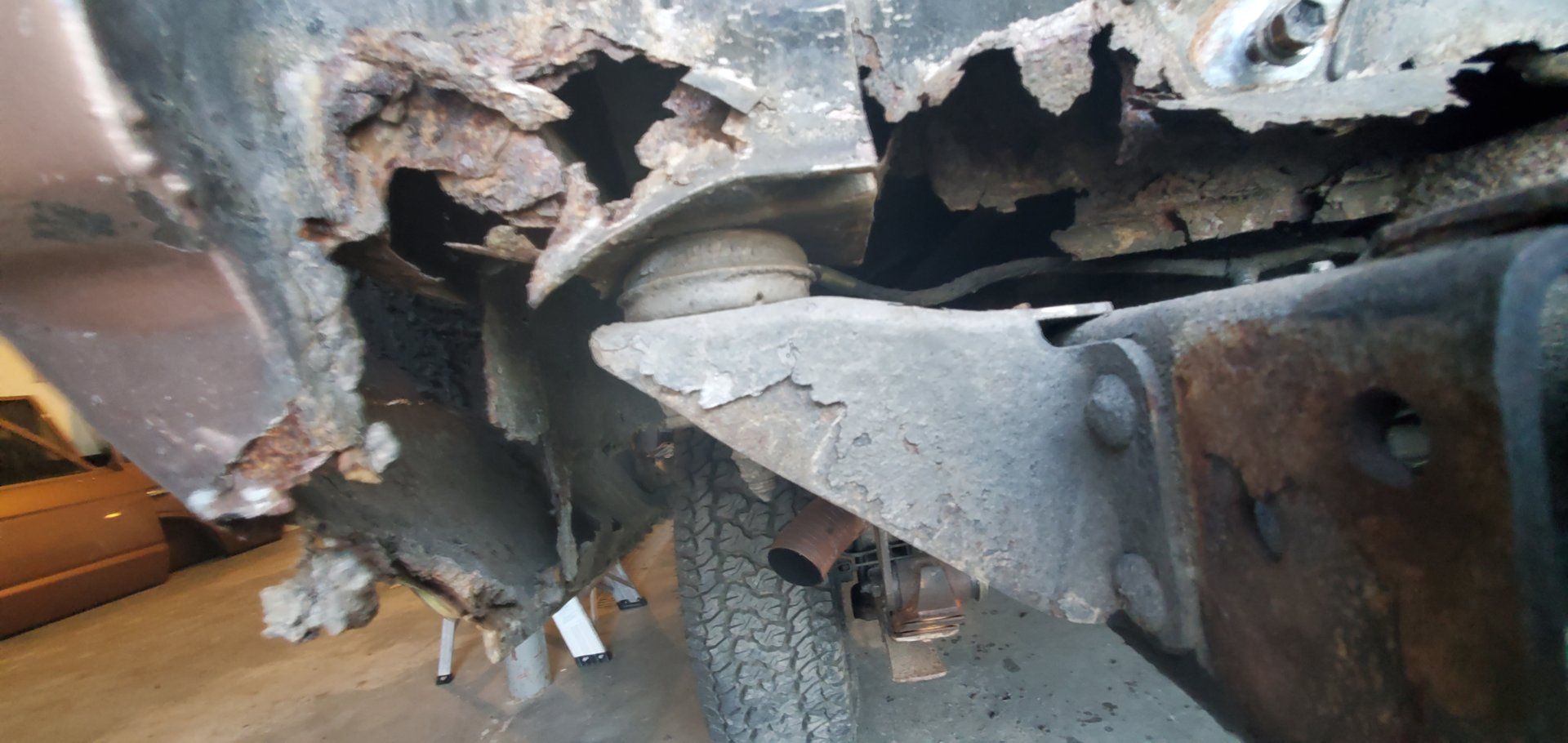

I also found a bunch of rust in the rear crossmember. I cut it out and will weld new metal in place.
The rear quarters are pretty horrbile. I wonder if someone has a couple of them for sale.
My spare truck has relatively good metal but it is mangled pretty badly.
This is what I am dealing with on the driver's side.
I do have good dog legs and rockers that I can cut and replace. I guess we will see how this is going to go.
FLASHBACKS !!! o_O lots of work there. I can't remember who, bit I know somebody make the lower quarter patch's. The rear body member's a b&%# to fix..
First time I have seen a converter for the trailer like that.
